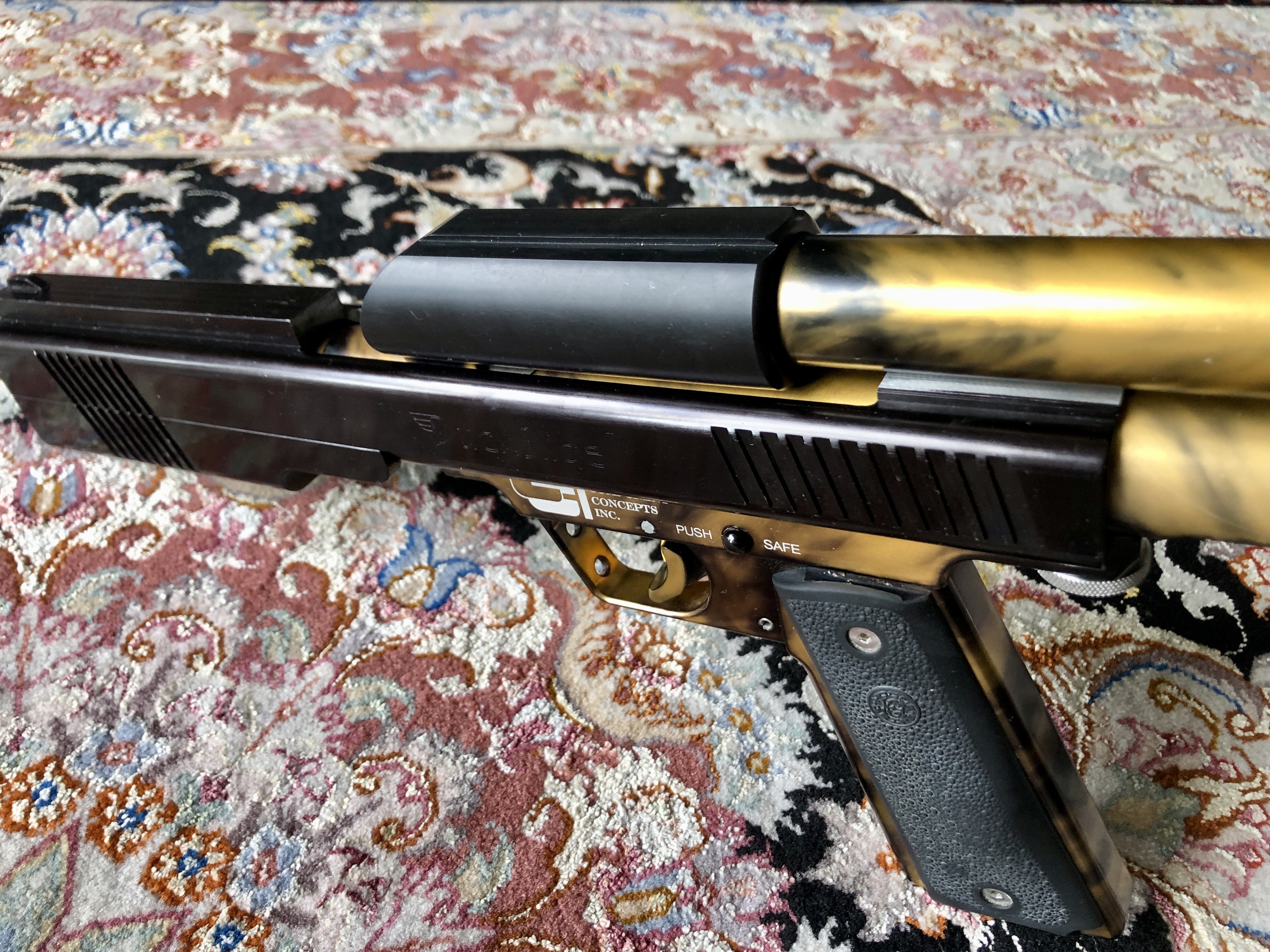

        Here are some pictures of mine. Let me know if you need more. I placed a plastic feed block on and it looks like it would work with how mine it cut.
        The channel is 13/16” wide
        The front part of the slide is 4.9”
        There is about 29/32” between the front of the feed and back of the slide.

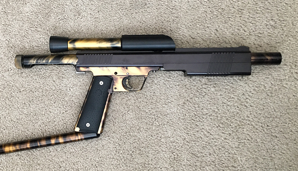

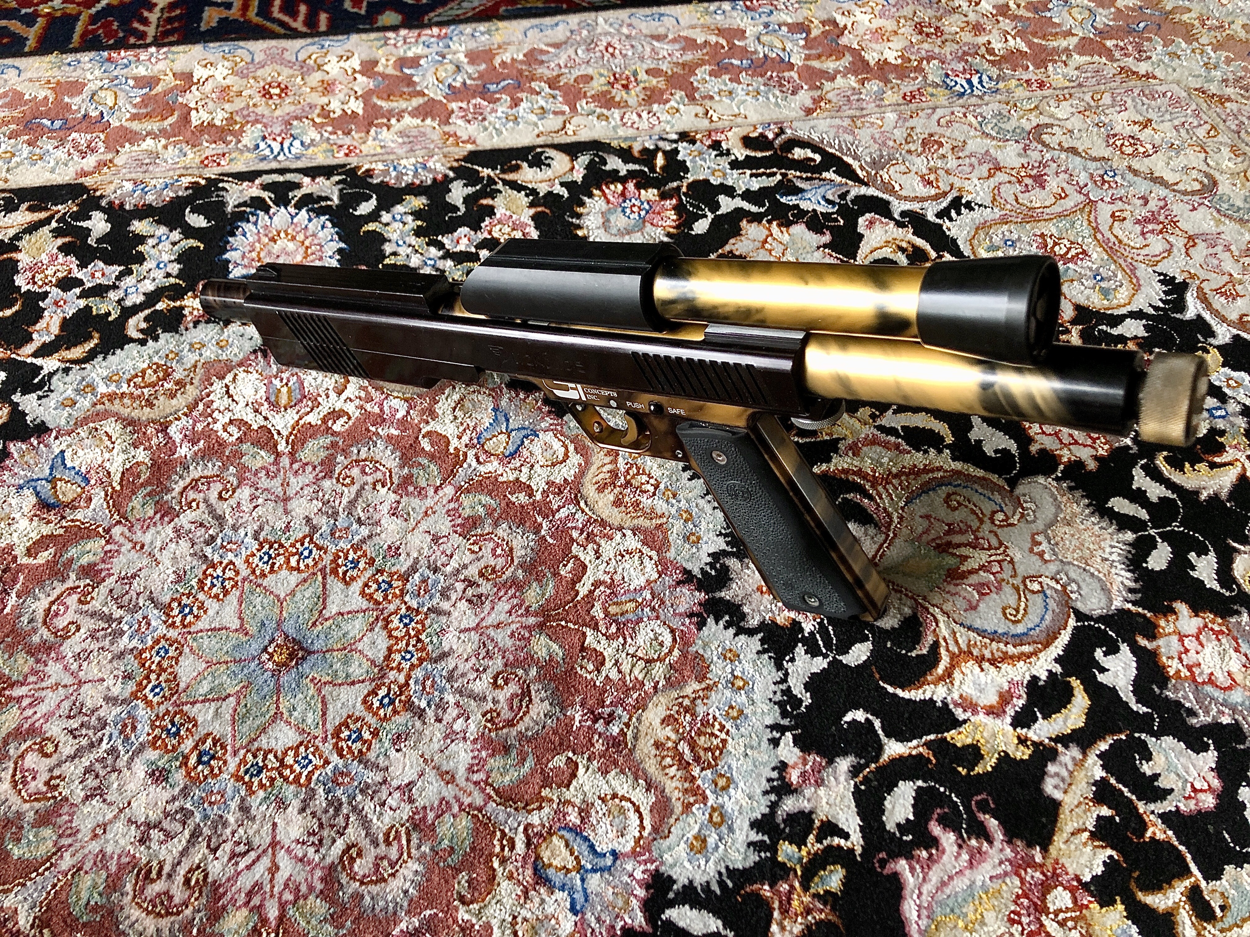

            I’ve finally gotten my phantom back. A friend from the woodsball group is an engineer with access to a mill. He took a unique approach of leaving some of the slide behind the feed block.
            • Loophole
              Loophole commented
              Interesting take on the milling! Can you still use a one piece aluminum feed or does this limit you to just the standard feedblocks plus feedtubes?
            • LA.Loic
              LA.Loic commented
              The extra material in the back would definitely get in the way if i was running the one piece feed. Though with the matching ano on my feed tube i doubt that i will ever switch.
