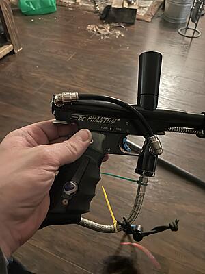

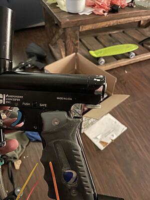

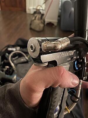

    I was bored and needed a project.
    So I was gonna order a nice one from someone on this forum (forget who ) , then I found an old back bottle ASA in my parts bin. Well go to my hacksaw, my grinder and a drill and really old taps that didn’t really work too well and some lovely Teflon to stop a leak …
    it holds air , it feels so much lighter . I love this set up now. Now for an under cocking kit.

    Are you going to hit velocity now with such a tiny valve chamber?

    I'm pretty naive to bobbed phantoms, but I thought cutting it down didn't get you to the valve chamber. Aren't you just taking "extra meat"' off the back?

      Exactly. If anything has more room for expansion

    The valve chamber size didn’t change. The valve chamber starts in front of the 1/8 fitting that I drilled in there. There was just a very small hole going from the valve chamber to the back bottle ASA. If anything there’s now more volume.

      I love the look. I'm just afraid to go at it with a hack saw. Maybe I'll try to get my hands on a spare...
    • Dauntless152
      Dauntless152 commented
      I didn’t dare do it on my main valve body. But I had a spare laying around so I figured I would try it. Works flawlessly.
