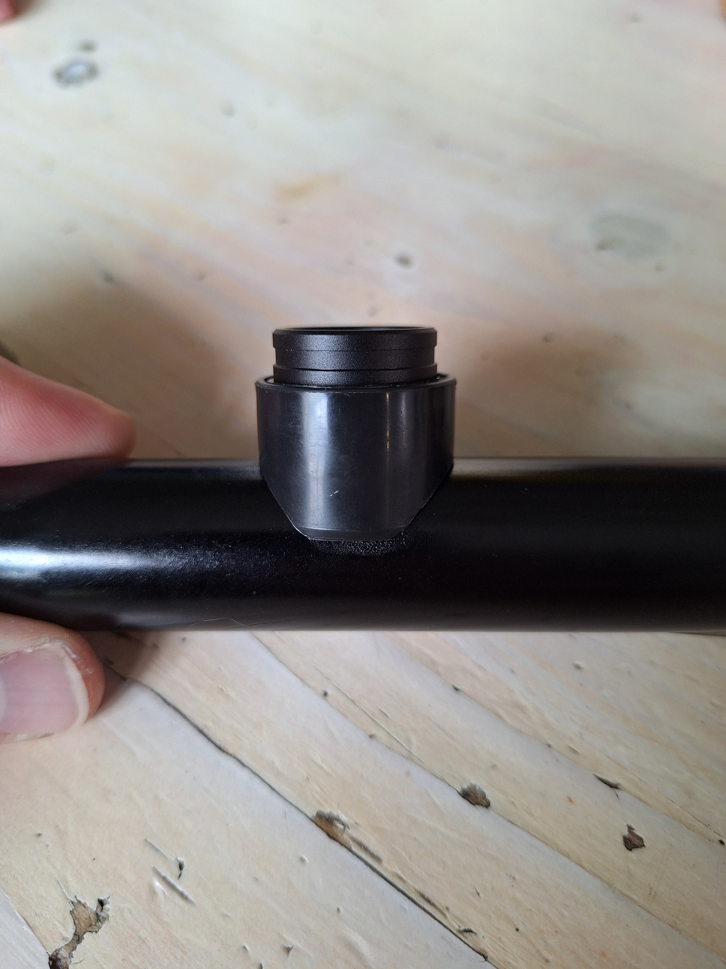

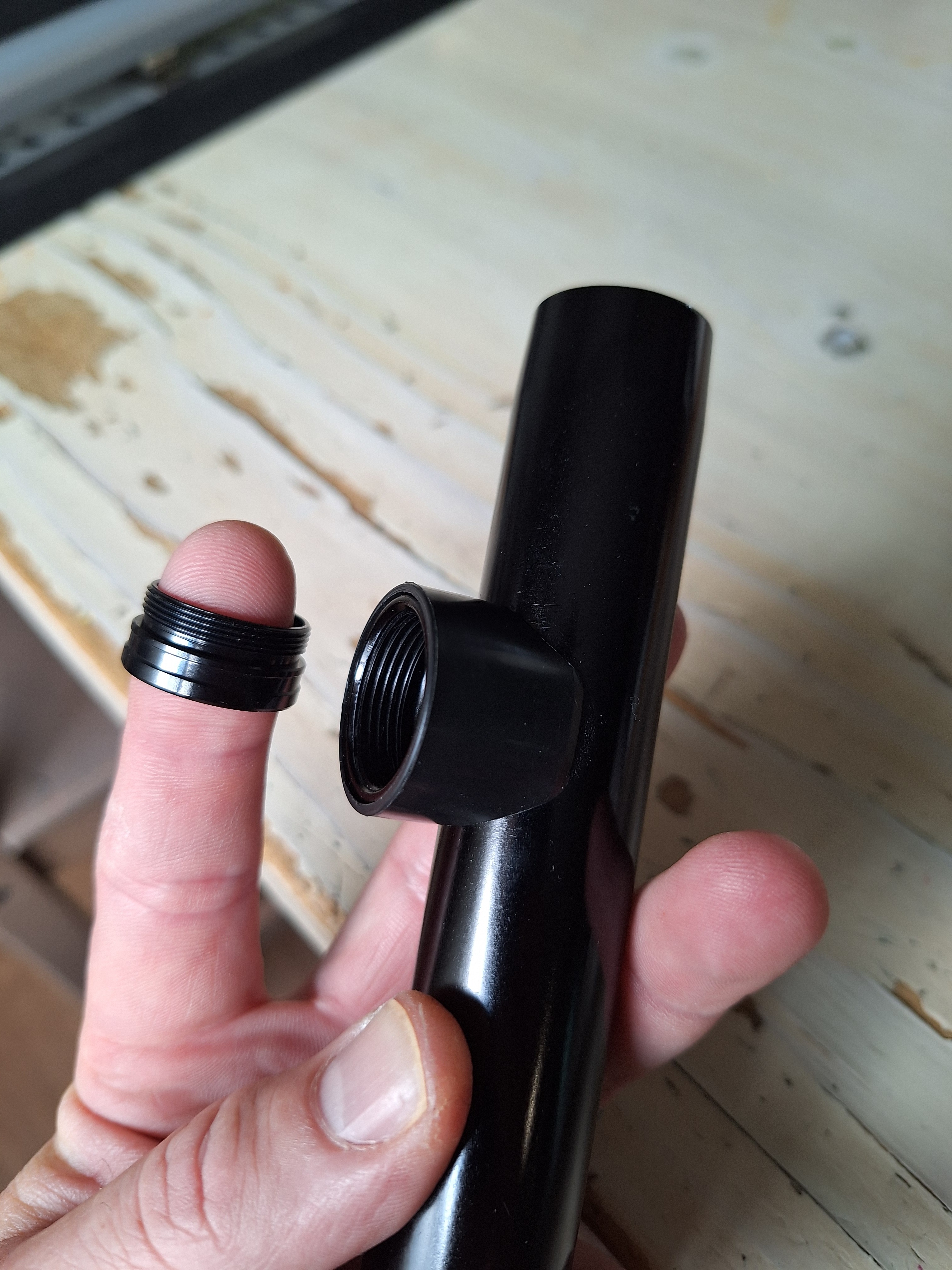

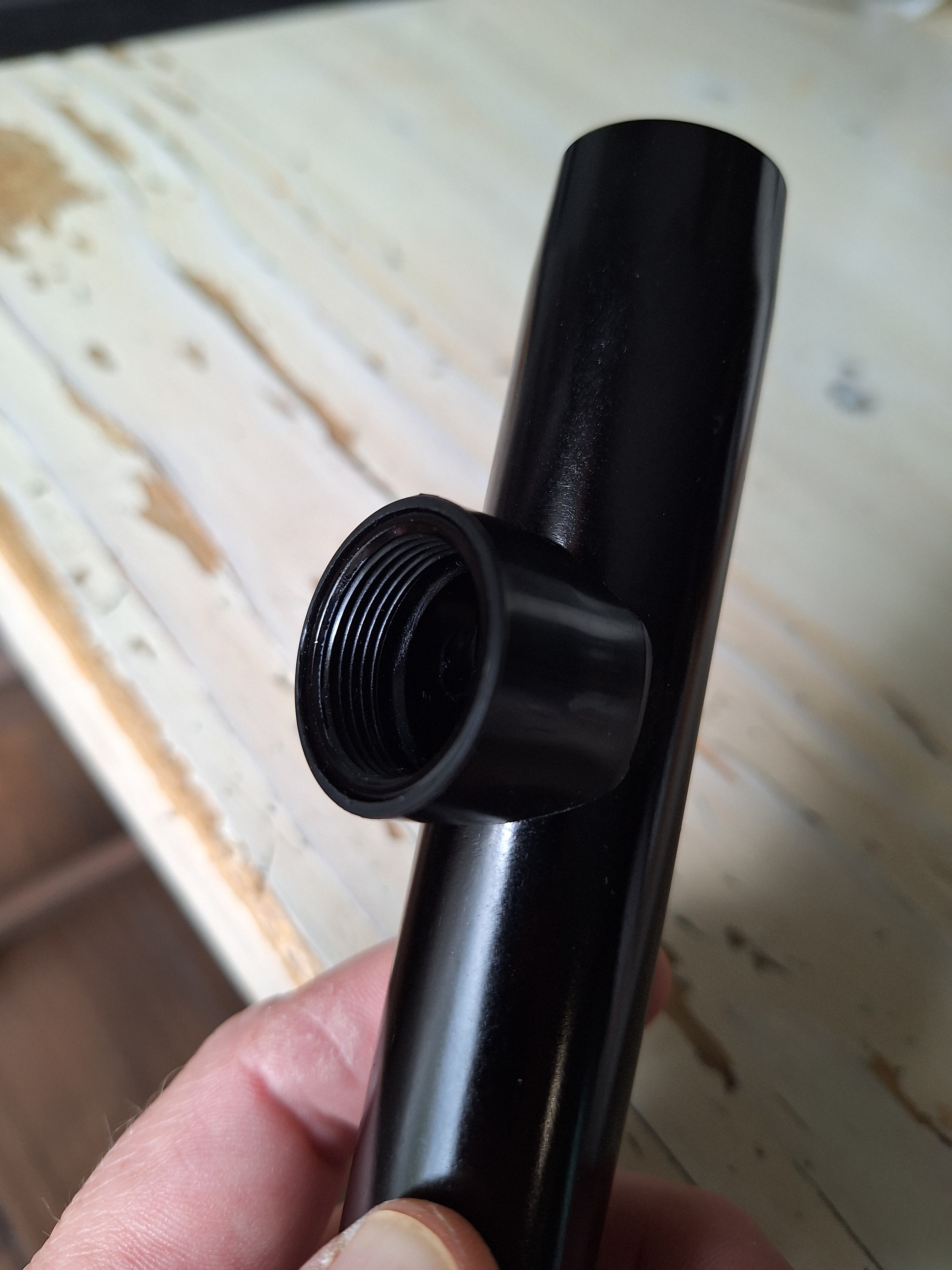

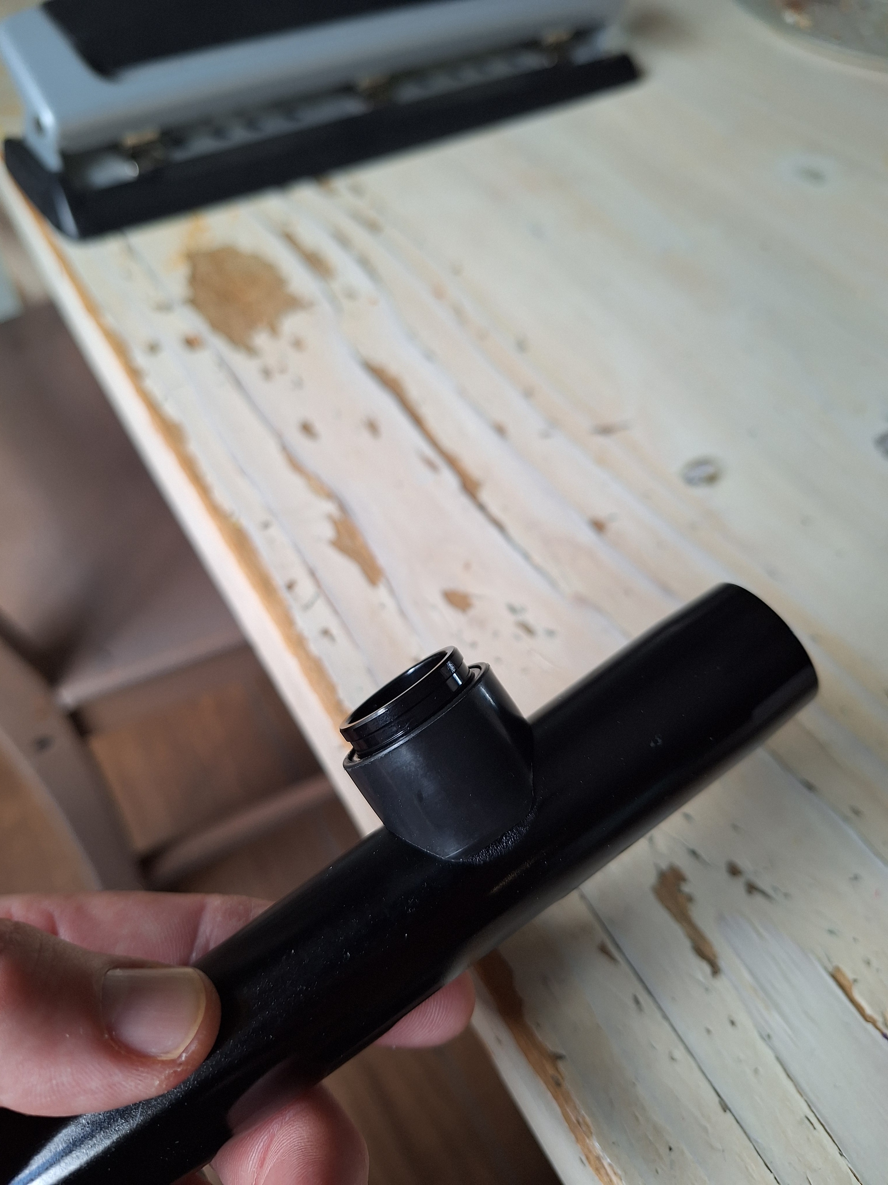

      Posting here for posterity. The vert feed threaded body I picked up absolutely does not match the Angel threads on the Inception adapter I bought. The adapter thread stub is slightly smaller in diameter than the threaded stub on the body, and the adapter threads are a finer pitch. One of my attached pictures show how the adapter fits inside the feedneck stub without the threads interfering, mismatched diameter. Tempted to just epoxy it in there.
      I still need to figure out what threads I have on the body.
        I wonder if inception sent you the wrong one.
        Is the body new from EV? It might be possible they changed the treads.
      • BSmiff
        BSmiff commented
        No, I got that body on ebay, so I'm not sure what era it's from. From digging around to identify these threads and comparing pictures from different sites, I'm pretty certain it's CCM threaded. I have another adapter inbound so I'll report back after that gets here. I just saw Nate's post below, so now I need to go find a 1/4-20 bolt in my hardware drawer.
