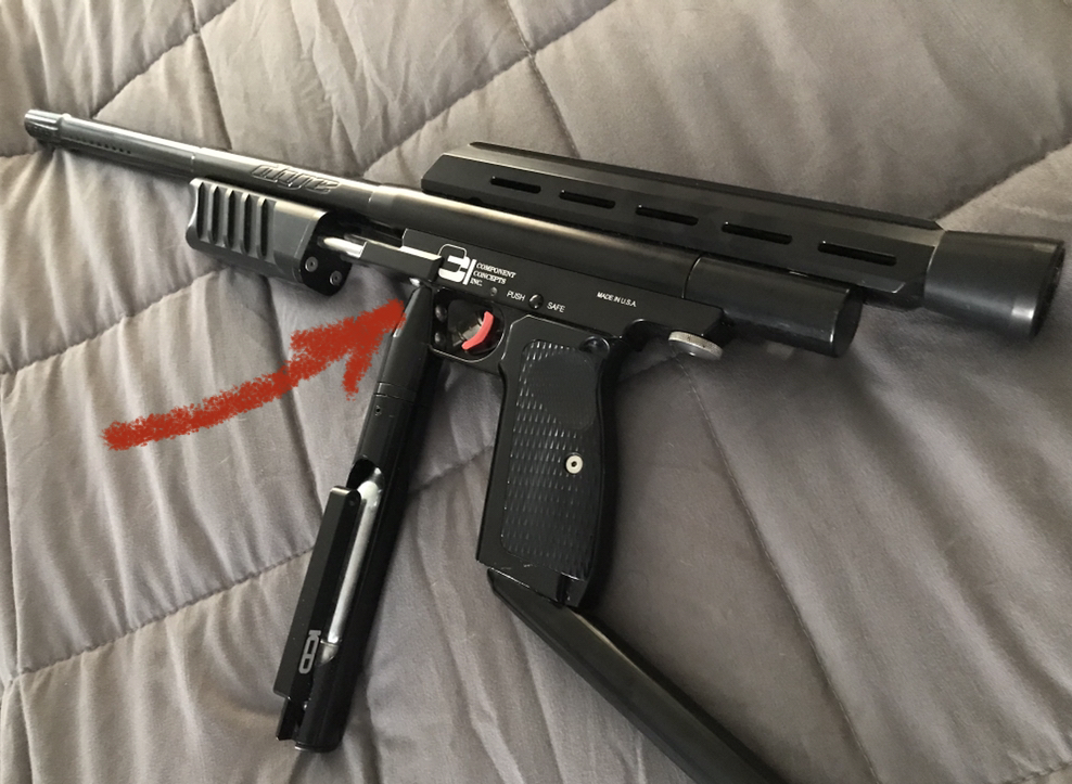

ID:	37031 It’s Also make sure your lock washer is not missing on your under cocking kit. The screw will enter the breach if it’s missing. The lock washer acts as a spacer from the UC kits mounting screw.
    • LA.Loic
      LA.Loic commented
      Im pretty sure that im good on that, the gun has a quick strip screw, those must be to length.
      Yeah that’s not the issue If you are using an over barrel pump it’s not an issue with the quick strip screws.

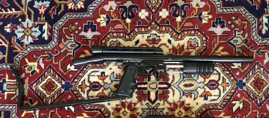

      Oh ok, I see running a Rainman kit. If I had to guess it’s the open face TPC like Jackal pointed out.
