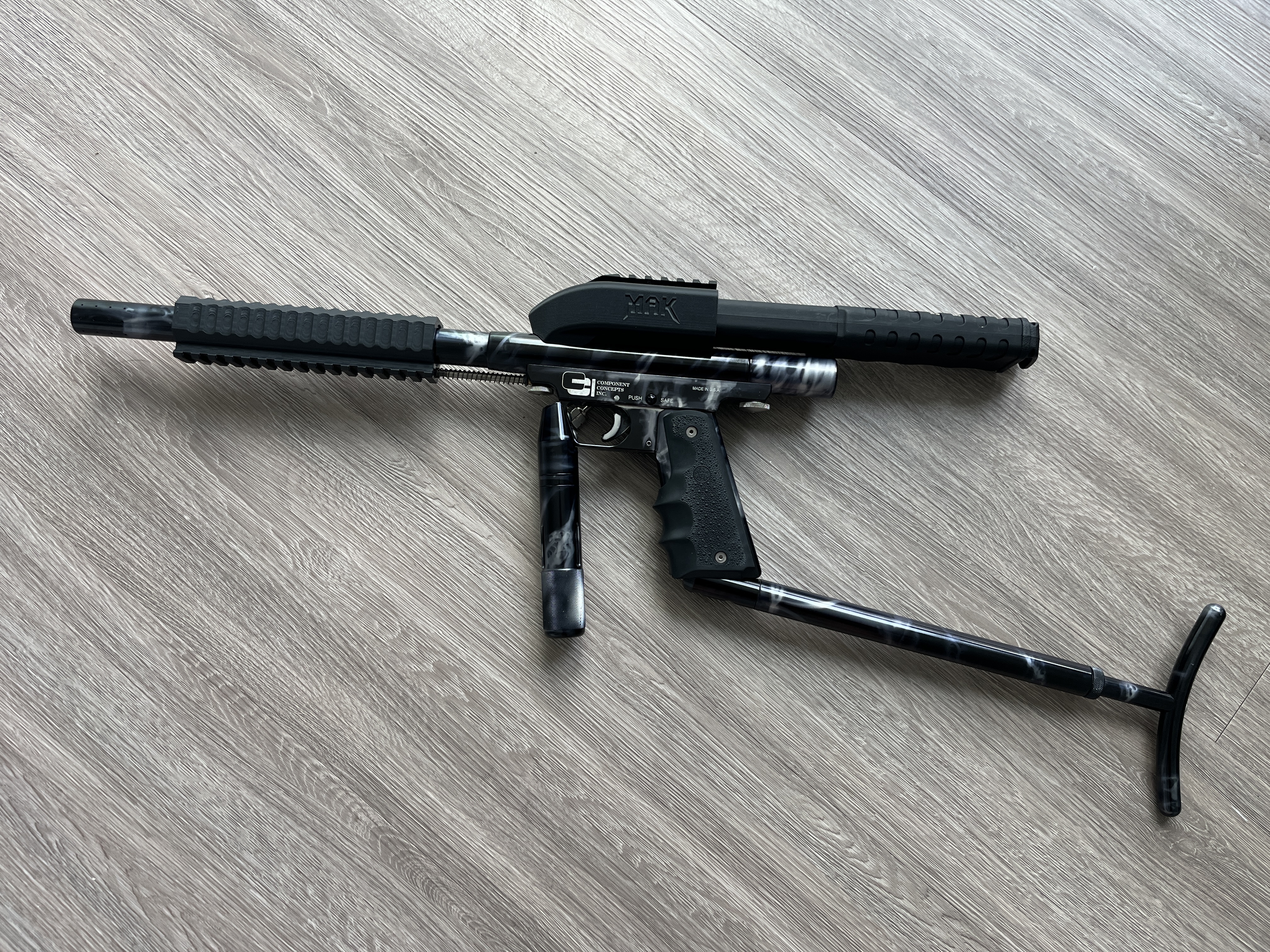

      I might be interested in this if the rail could be inverted- I like to use both a scopecam and a short barrel and the only good way I've found to mount such a thing is on top of the pump. My current setup leaves something to be desired, refinement-wise: https://postimg.cc/F1sg2RT6
        I still need to get the last beta unit sent out for testing, but once I have that out of the way, I can see about whipping up a custom top-railed version for you. Would 6" be too long?

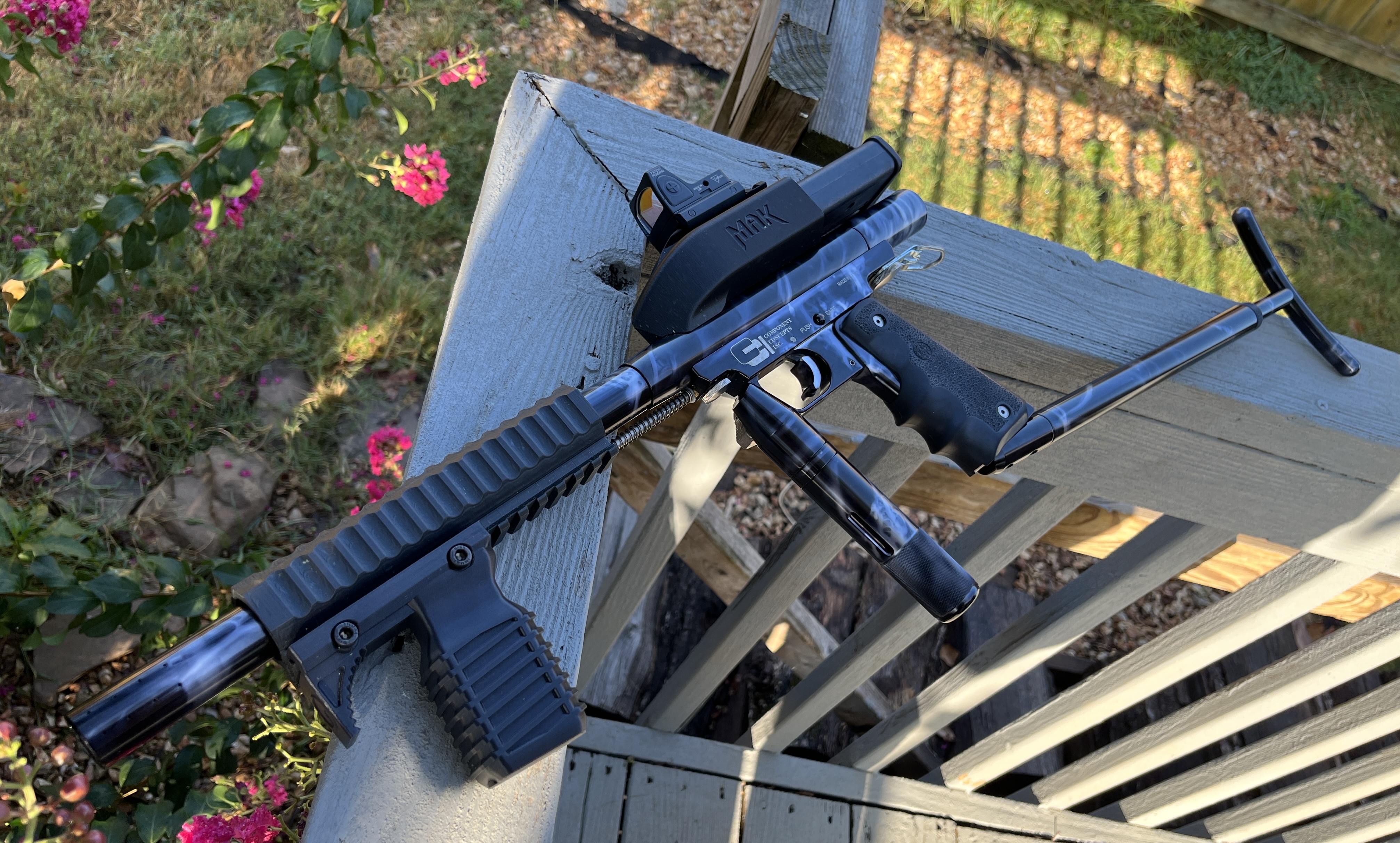

              Got mine in this week, have a foregrip on the way and may pick up a red dot. Print quality is very nice and hoping to hit the field with it soon.

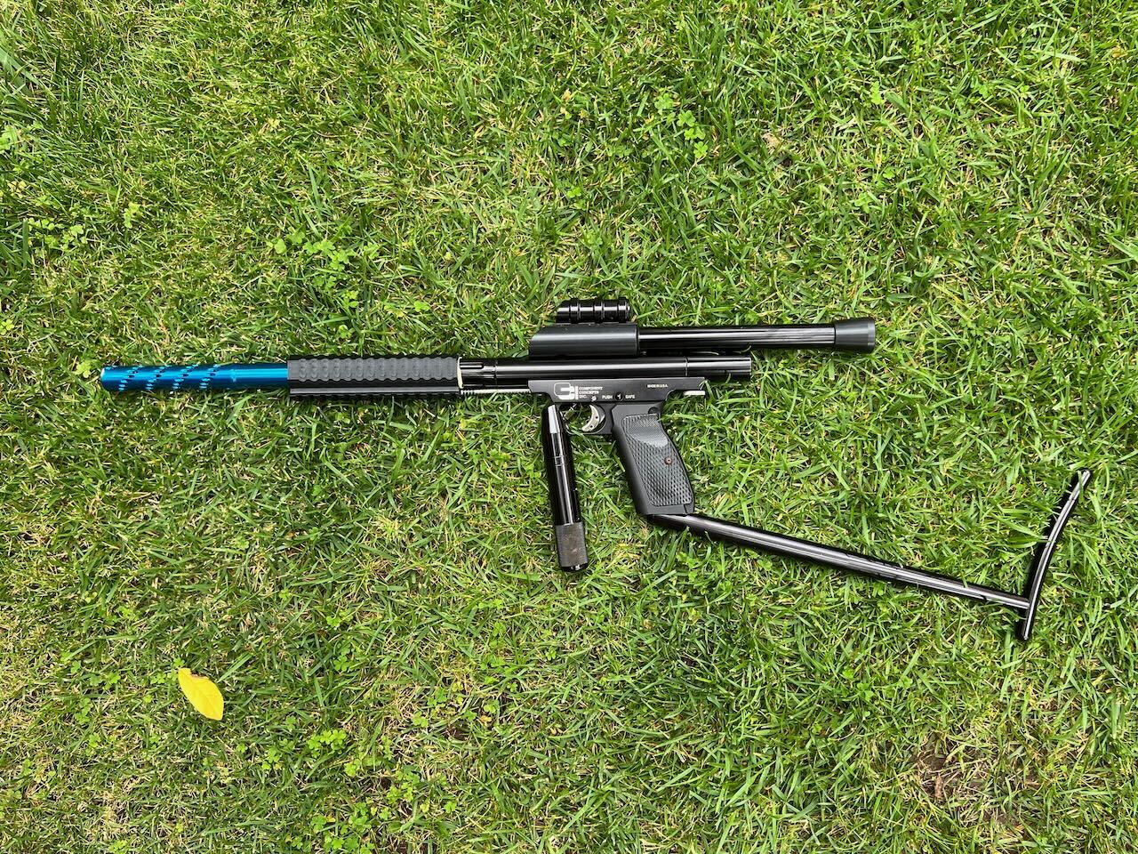

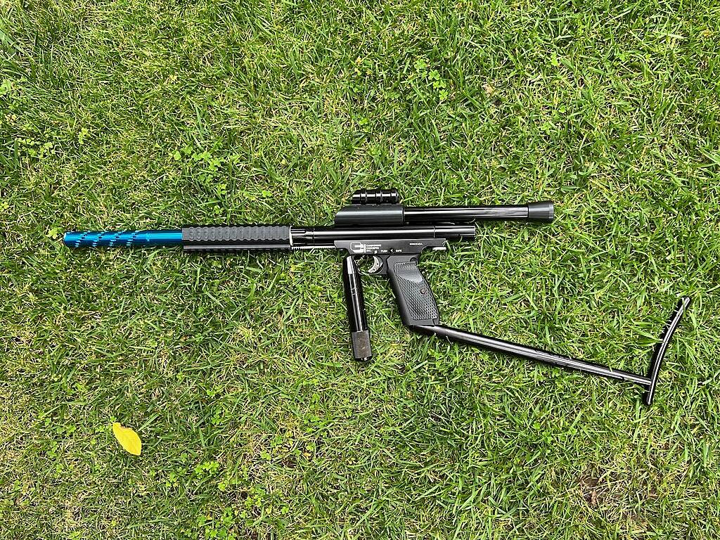

                Very smooth! The 1" insert fits over majority of autococker threaded barrels. I tested just about every brand barrel out there.
                ASP body with ccm handle
                Click image for larger version  Name:	IMG_2329 (1).jpg Views:	0 Size:	564.0 KB ID:	442246
