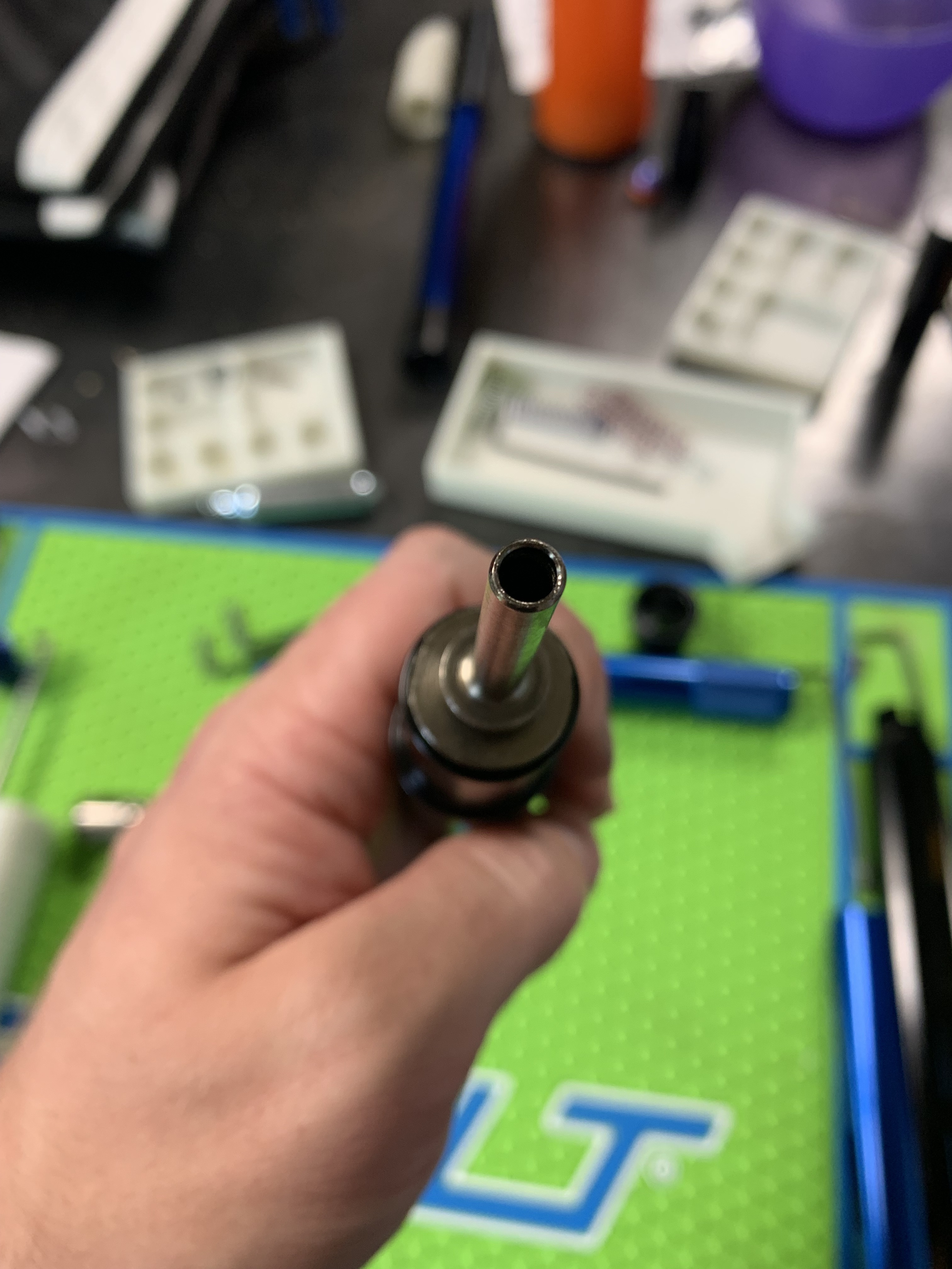

                Packers got an EV marker but I think he swapped out the internals to an older set he had because it was giving him issues. It seems a lot of the issue acts like an over pressure issue. Could it be the springs are different? Or that they machined the points the springs sit to far lowering there effectiveness. Something definitely off with them your typical phantom fixes are not fixing them. One was binding on the back stroke like a bent power tube.
                This is one of the new ones just looking at it it looks normal to me. I think it’s an issue at the points the spring sit (likely the valve). Could be why my 2.0 body needed red springs to hit velocity. The way they are finishing the stainless parts are definitely not as smooth. Could it just be they are not polished enough?
                I think it’s more likely an issue with the internals. Because the only EV marker I fixed the same way Packers fixed his by swapping out the internals for older ones I had in my toolbox. But it explains why the previous owner put a cp reg on it cut springs to get it just to shoot and sold it to my buddy. It was all kind of jacked up.
                Click image for larger version  Name:	image.jpg Views:	0 Size:	2.14 MB ID:	450336​
