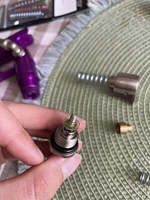

      How much "rattle" is there between the power tube and nut? I'd wipe off any oil there, and make sure it is smooth with extra room in case the nut shrinks from the CO2 chilling it. I doubt it, but it's just a thought.
      Try a Teflon washer for the cup seal, if you can find/ cut one the right size. Or get old urethane seats.
      And, take photos of all the parts, and show us! I'm curious what might be different.

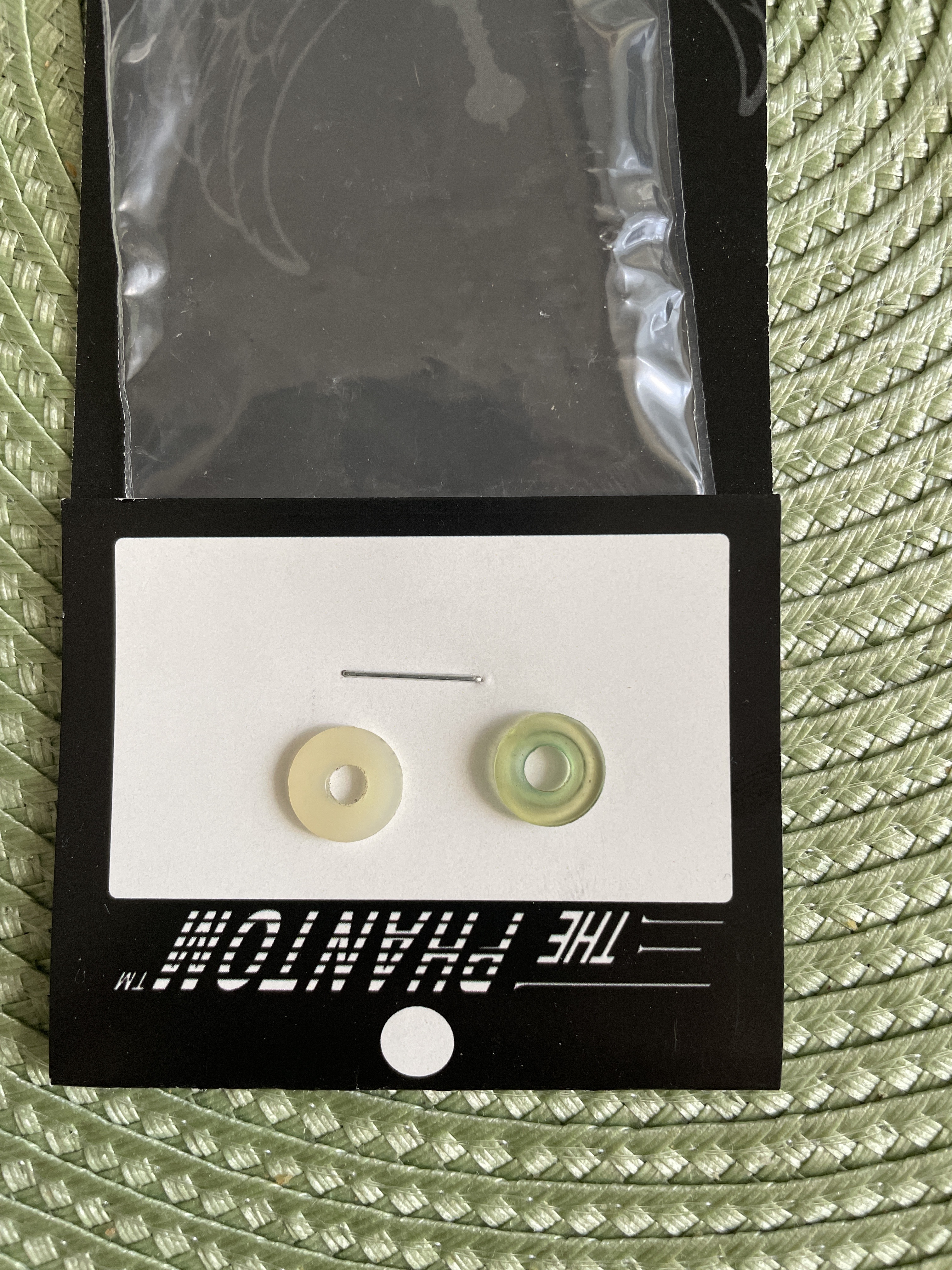

        Is your cup seal a softer material or a hard/thin white delrin(?)?
        I’ve fiddled with quite a few phantoms from EV experiencing a similar problem. No noticeable leaks down the barrel like you’d expect from a blown cup seal, but would run well briefly and then crap out. Unable to get useable velocity from tanks or 12s. Roll out shots, etc.
        the one thing I was able to isolate to solve the issue was there was a period of time that EV was shipping their power tubes with a cup seal that was a softer yellowish/clear rubber material. Unsure of the actual material type. They’ve now apparently switched backed to a thin delrin(?) cup seal a lot like their puncture pin seals.
        swapped the softer material cup seals for the harder ones and it solved the problem. the cup seals they sell online are now of this harder type too.

          #21
          Feel like they don’t fit the same The hole is smaller on the newer one. Or is this the wrong seal?

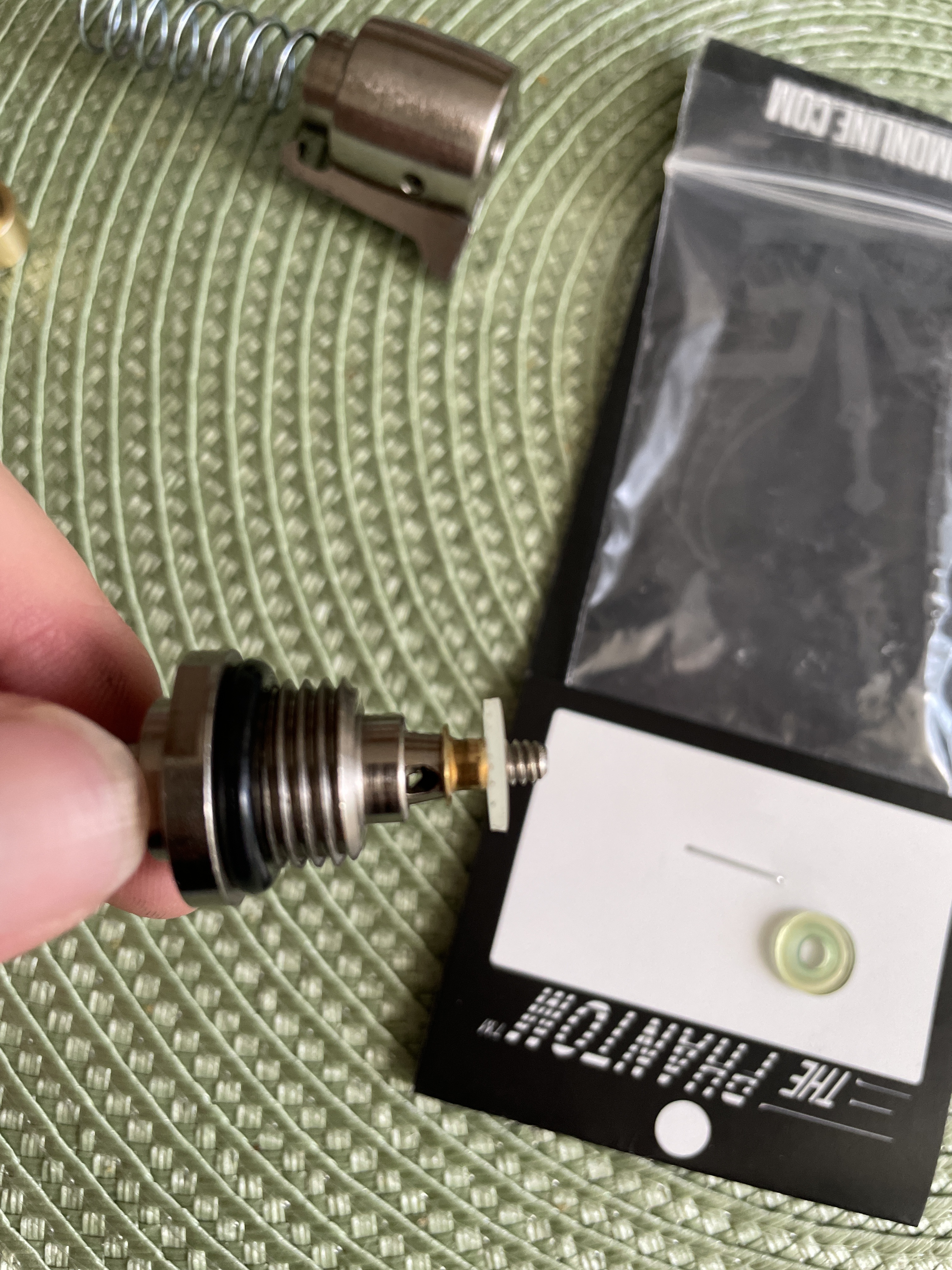

            #22
            So can’t get it seated all the way
            • Prometheus
              Prometheus commented
              Does it not slide all the way down?
            • Prometheus
              Because the one that was in there slid down onto the brass fitting there. This one the hole isn’t big enough.
            • Ordo
              Ordo commented
              Seat the seal it into the brass cup, then thread your power tube into it. It will slightly stretch the inner hole to accommodate. I PMed you some pictures of mine.

              It fits in the cup just doesn’t seem to screw down all the way when I go to tighten it
              Ok it’s the right seal then put the lil brass piece in the seal first. Lip side toward the power tube like you have it in the picture above. You may need to force it a lil bit. Then place it on the power tube lil light hold lock tite on the power tube threads.

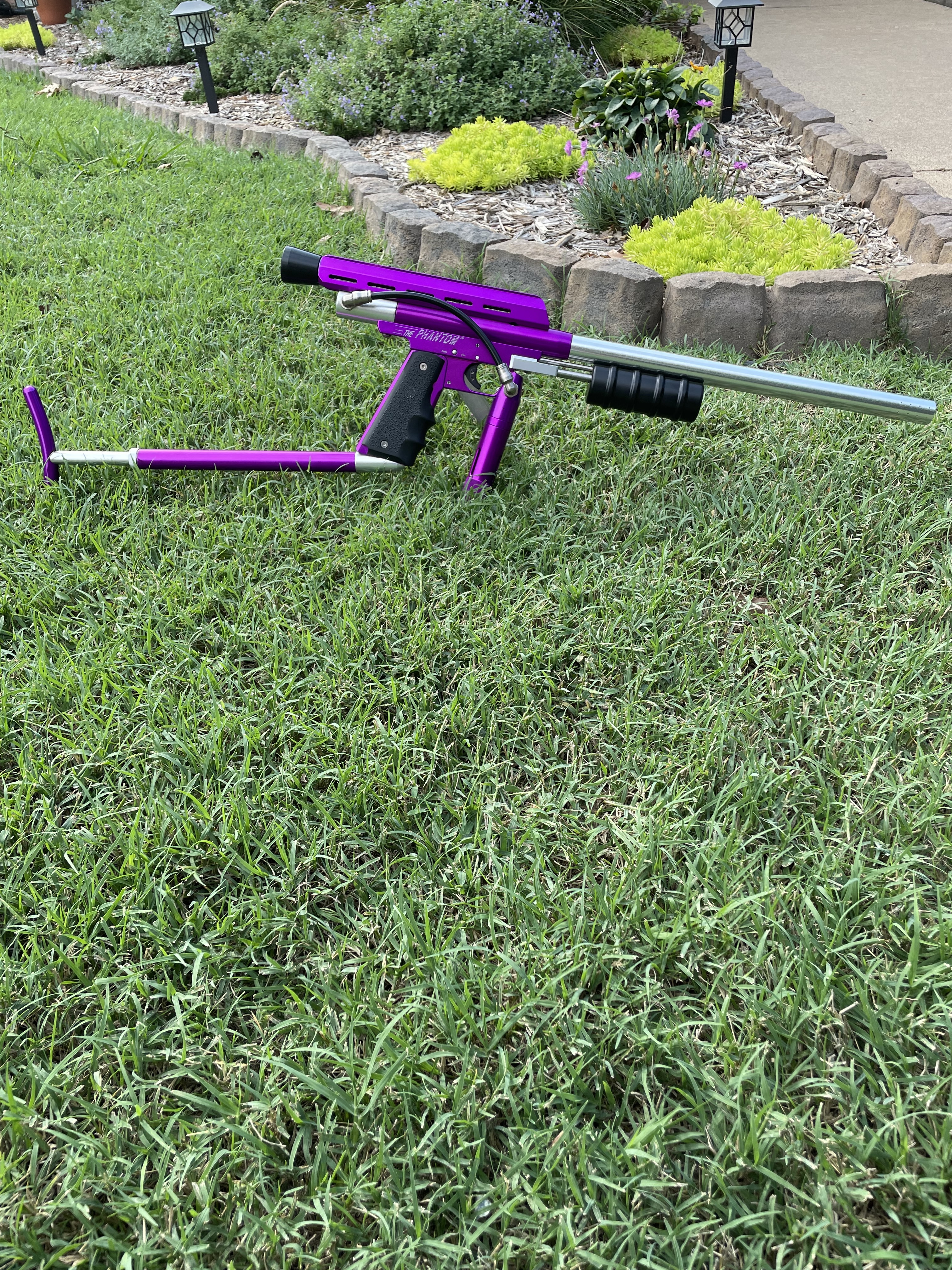

              It’s alive! I believe at least this weekend will be the true test. Replaced the cup seals and I shot 50 rounds through it on the crappy crossman 12gs. Shot good! Will update you all Saturday night.
                Get a hard line in it. That’s a beautiful marker love the color combination!
              • Mr. Hick
                Mr. Hick commented
                its early and I haven't had my coffee... if your air line, brake line?
              • Prometheus
                Good ol macro line. I’ll prob do a silver hardline kit soon. The macro line does make it much easier to take apart. Granted I hope I don’t have to do that as much now.
