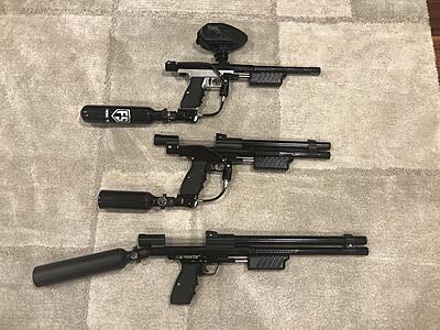

            Welcome to MCB. Sweet collection of phantoms you got there.
