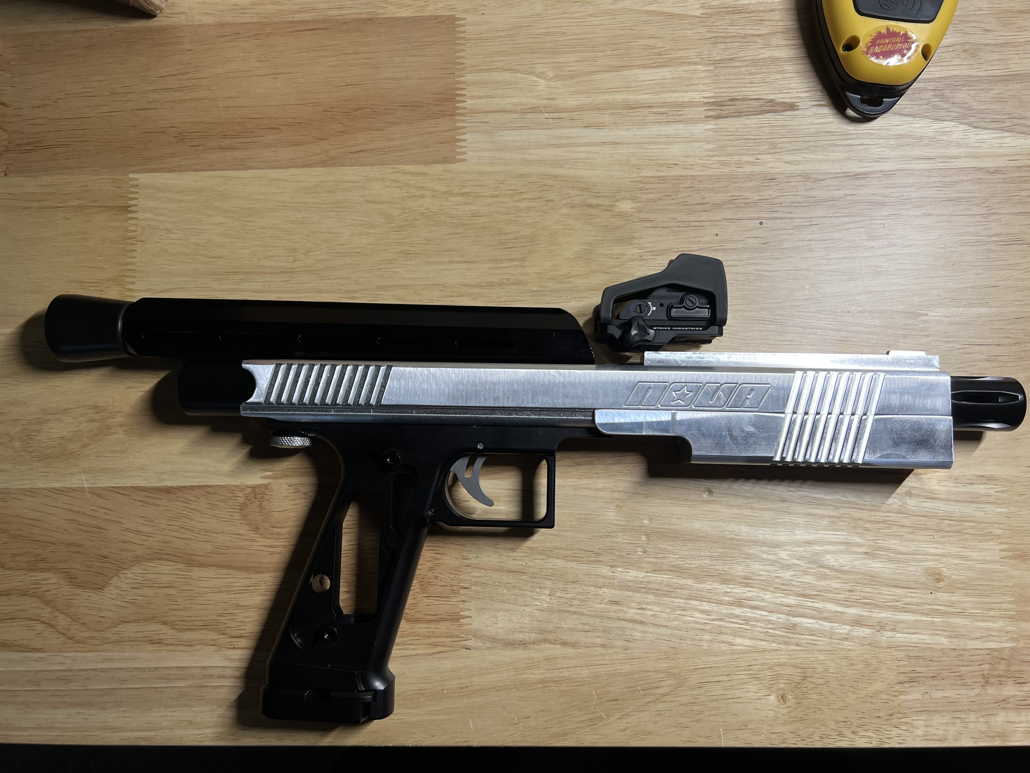

    One day this will take shape… and I’ll finally have the pistol I’ve always wanted
    • Lt. head-shot
      Lt. head-shot commented
      @Chuck - I was trying to see if there was a way to drop a rail down from the sc feed, in order to keep things aligned/stable, I think mounting to the pump might have too much variation. But then again paintball guns arent accurate enough for a red dot, so I might try it
      Did you get the printed sleeve to take the slop out of the handle? I think mounting it low in front might keep it in line with the barrel more. Looks like it sits up high enough for the sight picture to clear the SC feed. Looks cool right ware you placed it.

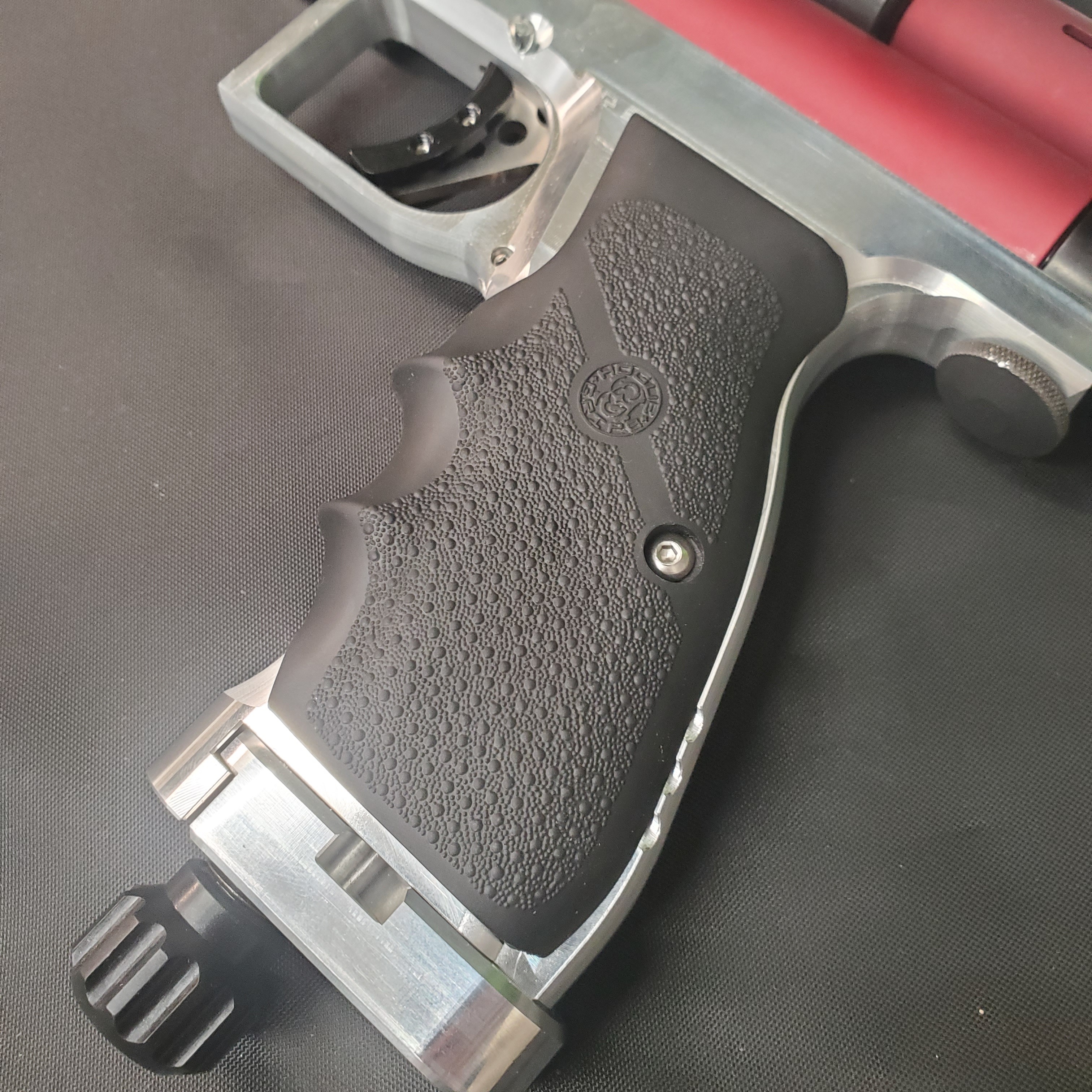

    Yes, it's coming and it takes CZ grips. No, it's not 86 degrees. 72 degrees, like a CZ75.
    But yeah. Coming soon. Get a green membership or subscribe on my site if you want to be the first to know.

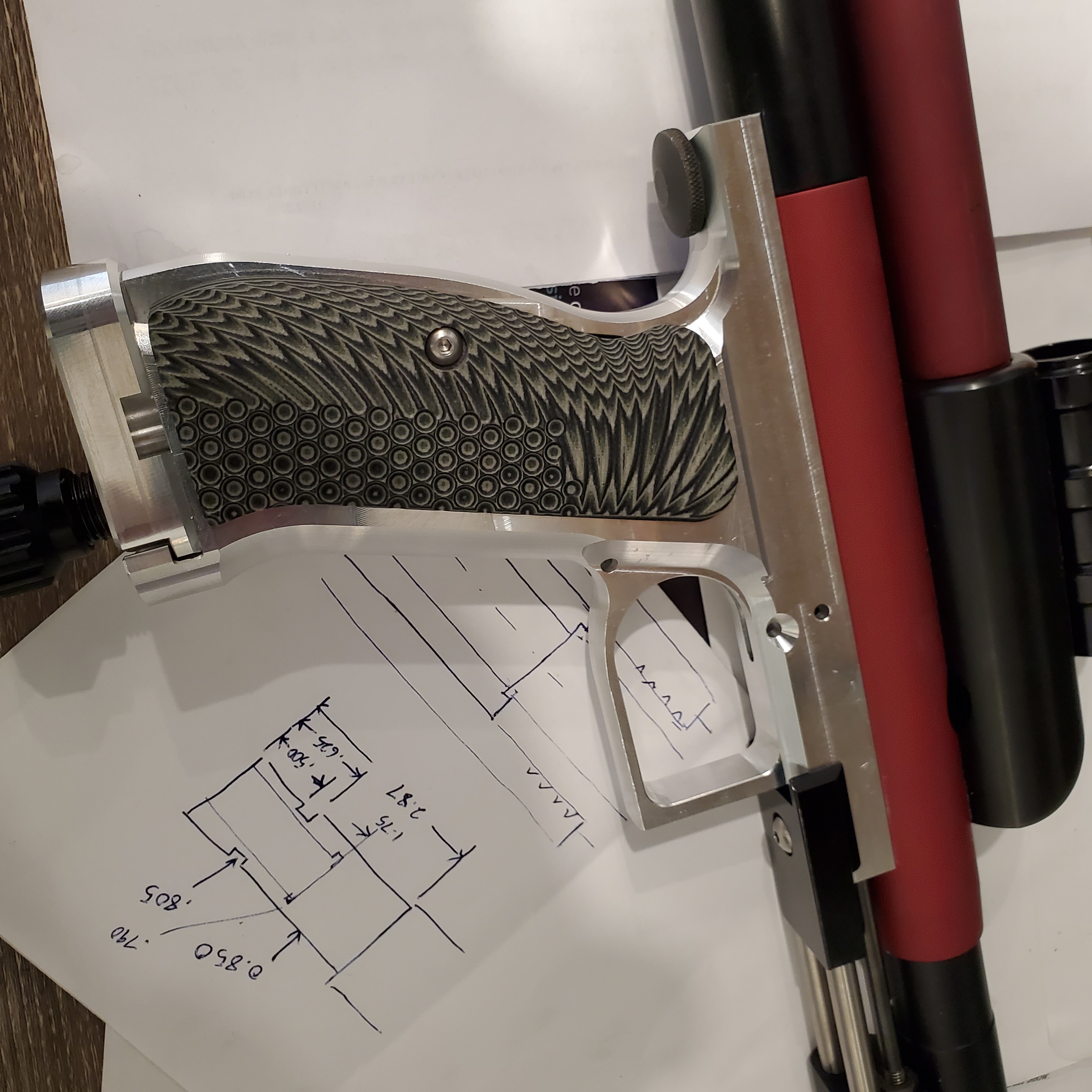

    Edit: Adding a photo for everyone patiently waiting. The Guun grips are a nice option to slim it down; the Hogues are nice and beefy.

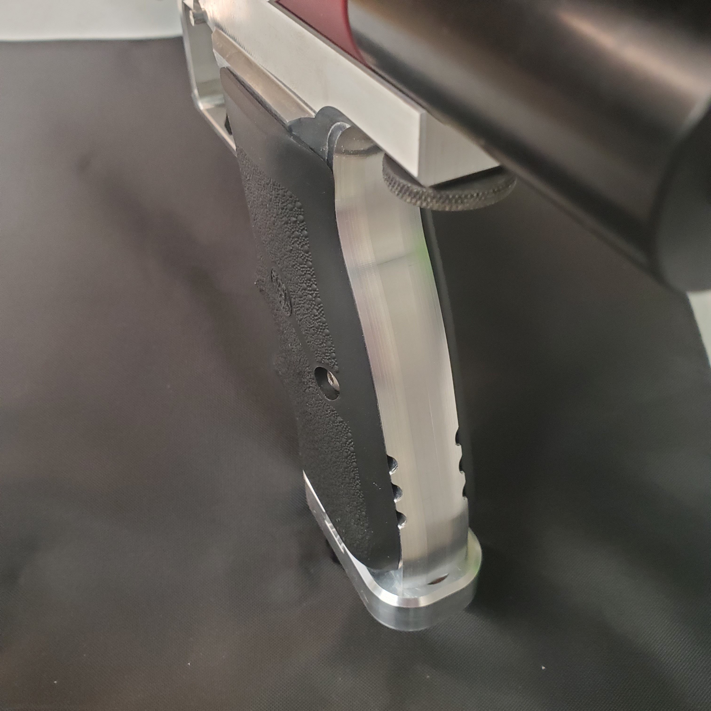

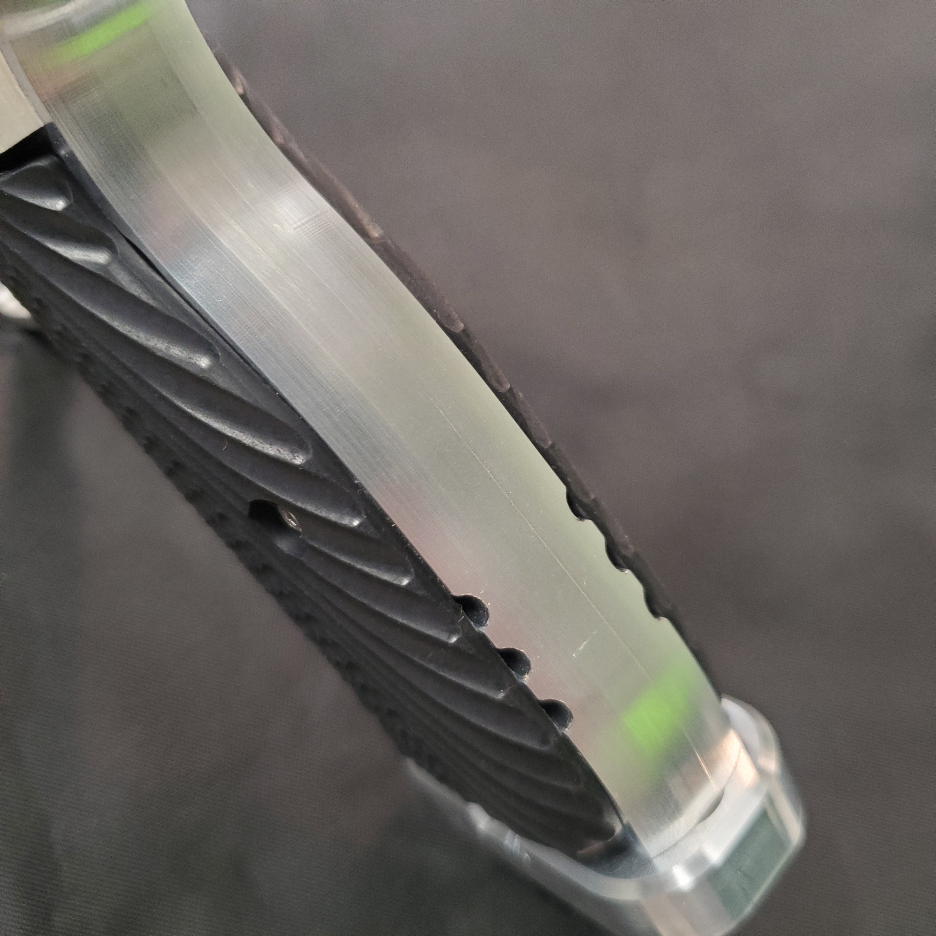

      Did some testing and the CZ grip inside dimensions aren't feeding the 12g as smoothly. Sent a revision to my local guy and should hear back by end of the week, but still pushing for a November timeline.
      This is the awesome part about using local shops. I get to sit down with the machinist, face to face, and we brainstorm alternatives when something isn't quite right. Can't do that in China!

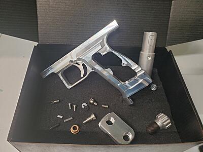

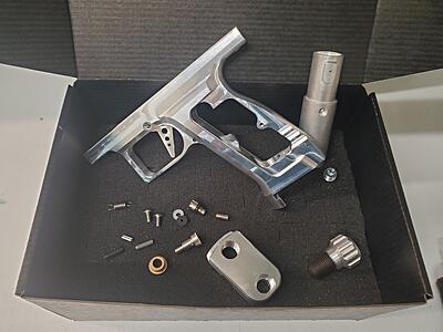

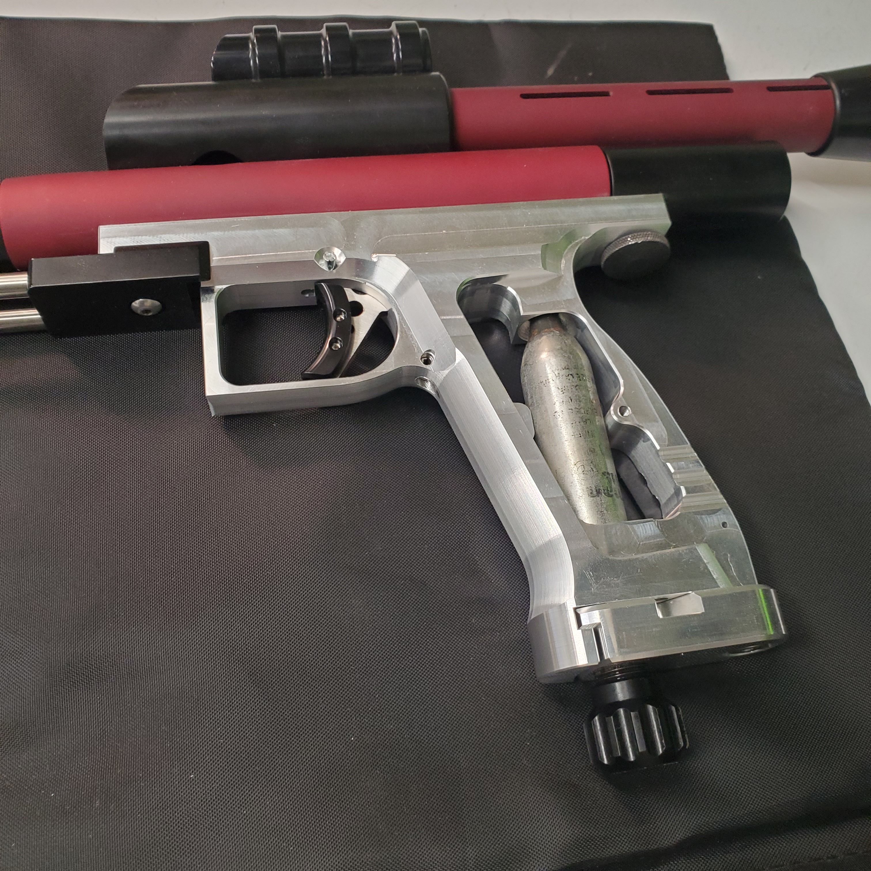

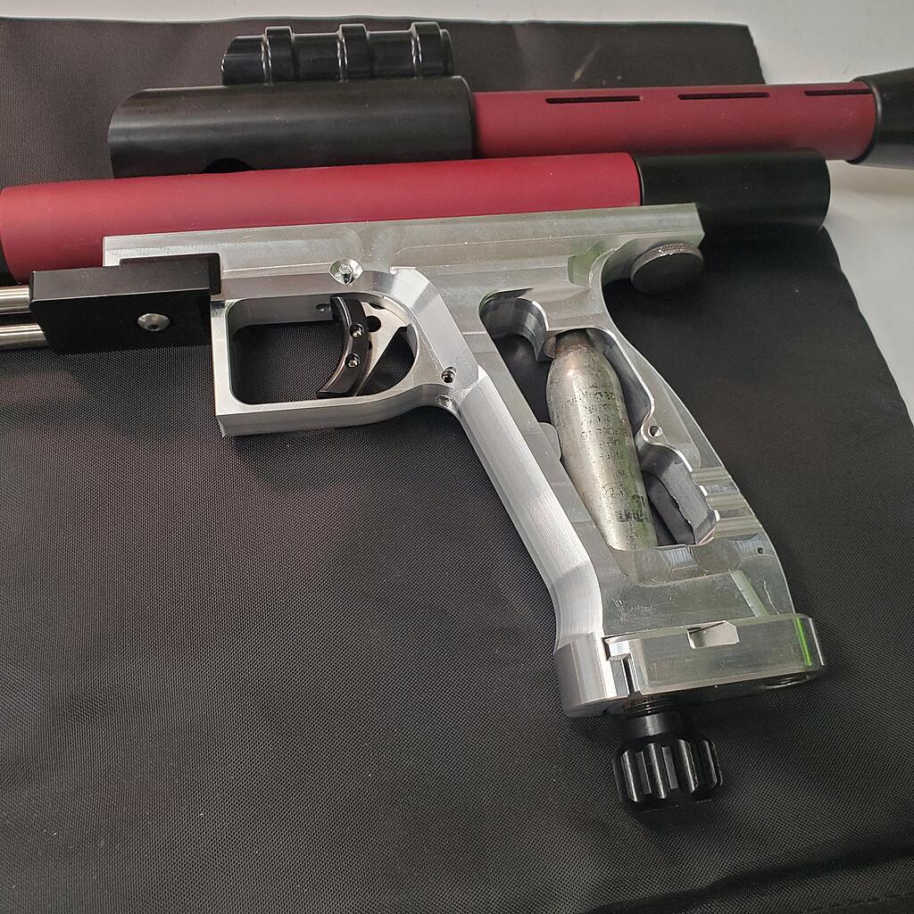

        Eye candy - got the snags fixed and looking at 4-6 weeks plus a human factor since it's holiday season.
        A "funnel" to help the skinnier 12gs line up better, and some speed holes vents in case someone dumps a full cartridge inside.
        They'll take CZ75 grips (including Hogues), but were designed to also accept CCM panels which are close but not exact. Splitting the baby as it were.
        Around 20 will be available in this batch.
