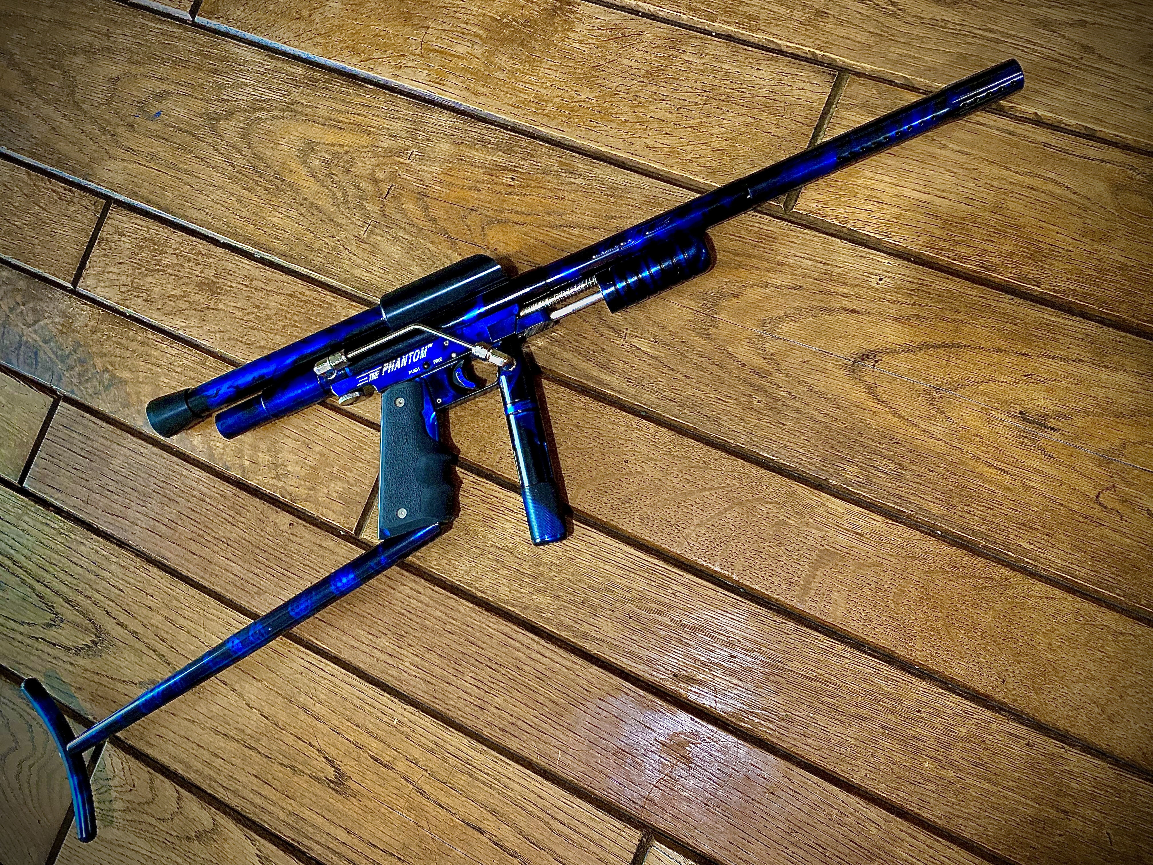

                          Carp commented
                          Lol...what kind of lighting are you using, to get that blue lit up, like that? 👍
                        • Grendel
                          Grendel commented
                          Looks like you got the barrel glued up
                          That’s actually another barrel had purchased through PB Charleston a while back that was already glued. I still got to glue the Red and black, and a yellow and black I talked my buddy into snagging. My favorite Phantom barrel hands down!
