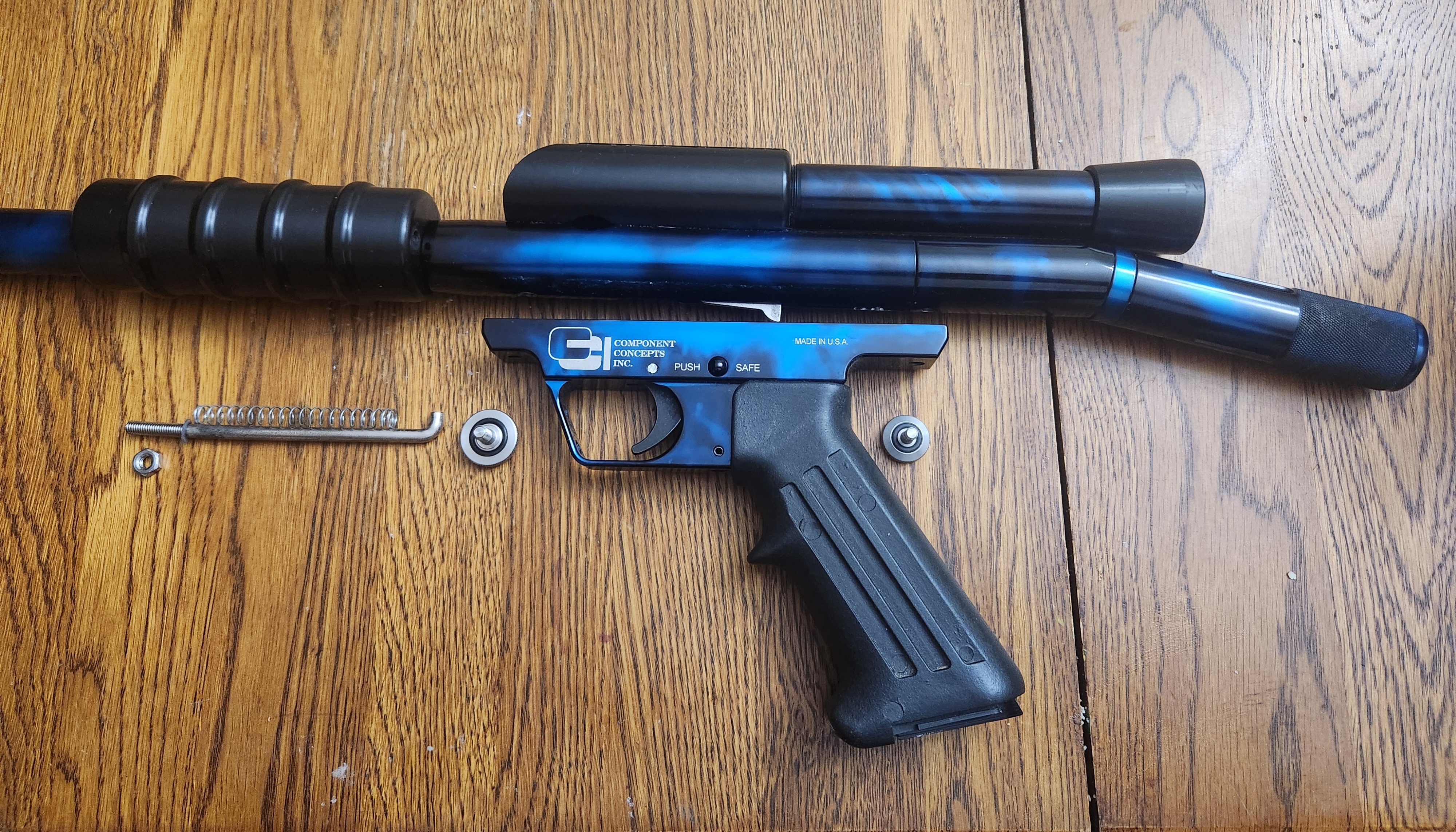

            disassembled it., rod does have some kink to it

            To be honest I have a bit of a conundrum with this one.
            I snagged it mainly to get a matching L stock for my other phantom.
            Should I keep this one and upgrade it (thinking an undercocking kit) or part it out? Hmm decisions decisions... Click image for larger version

              Carp commented
              All this sweet acid wash needs is a new pump rod, a brass shim, a grip change out and/or an optional trip for a ASP detent mod..🤔
            • StockMike
              StockMike commented
              That is a nice acid wash, I wouldn’t part it out. Just my humble opinion though. That rod does look bent, as several people already pointed out. I would keep it and upgrade it though! ASP detent mod is a MUST! It can be hard to find a matching 45 grip, but I recently picked up a Hogue 15 degree grip that bolts on like the lone star grip and it is pretty similar in feel to a 45. Granted it has much less heft to it since it’s plastic. But the angle is right at least. I also see those thumb screws are laying in the wrong spots. Not sure if they are different lengths or not, but I would still make sure they get out into the correct spot when reassembling.

            I bought a used phantom recently with a similarly bent rod and was able to bend it back to straight fairly easily. Though a replacement is fairly affordable as well.

              managed to get the rod fixed. the c02 is still stuck but I'll deal with that later
