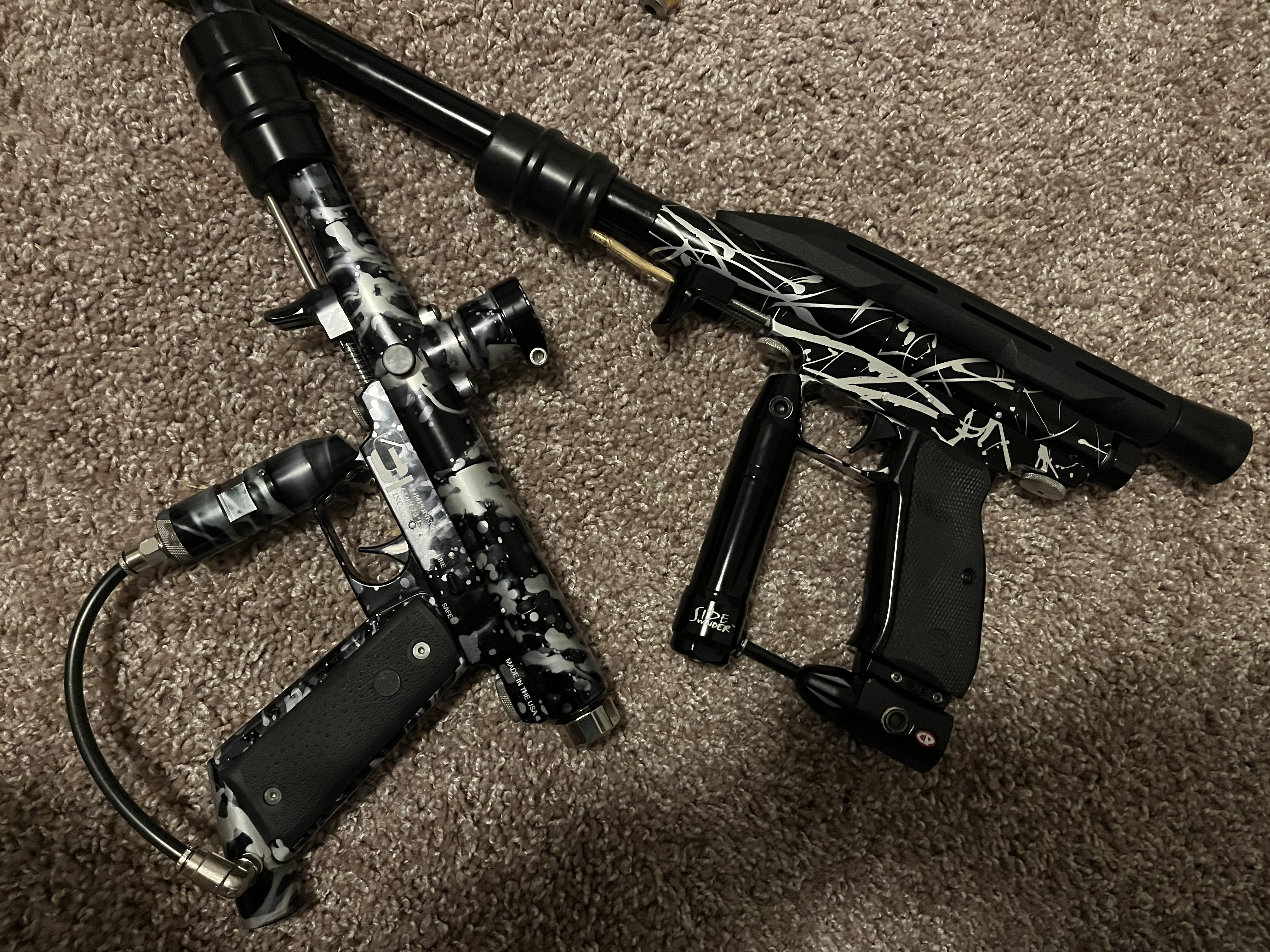

      Family photo with its much older sibling

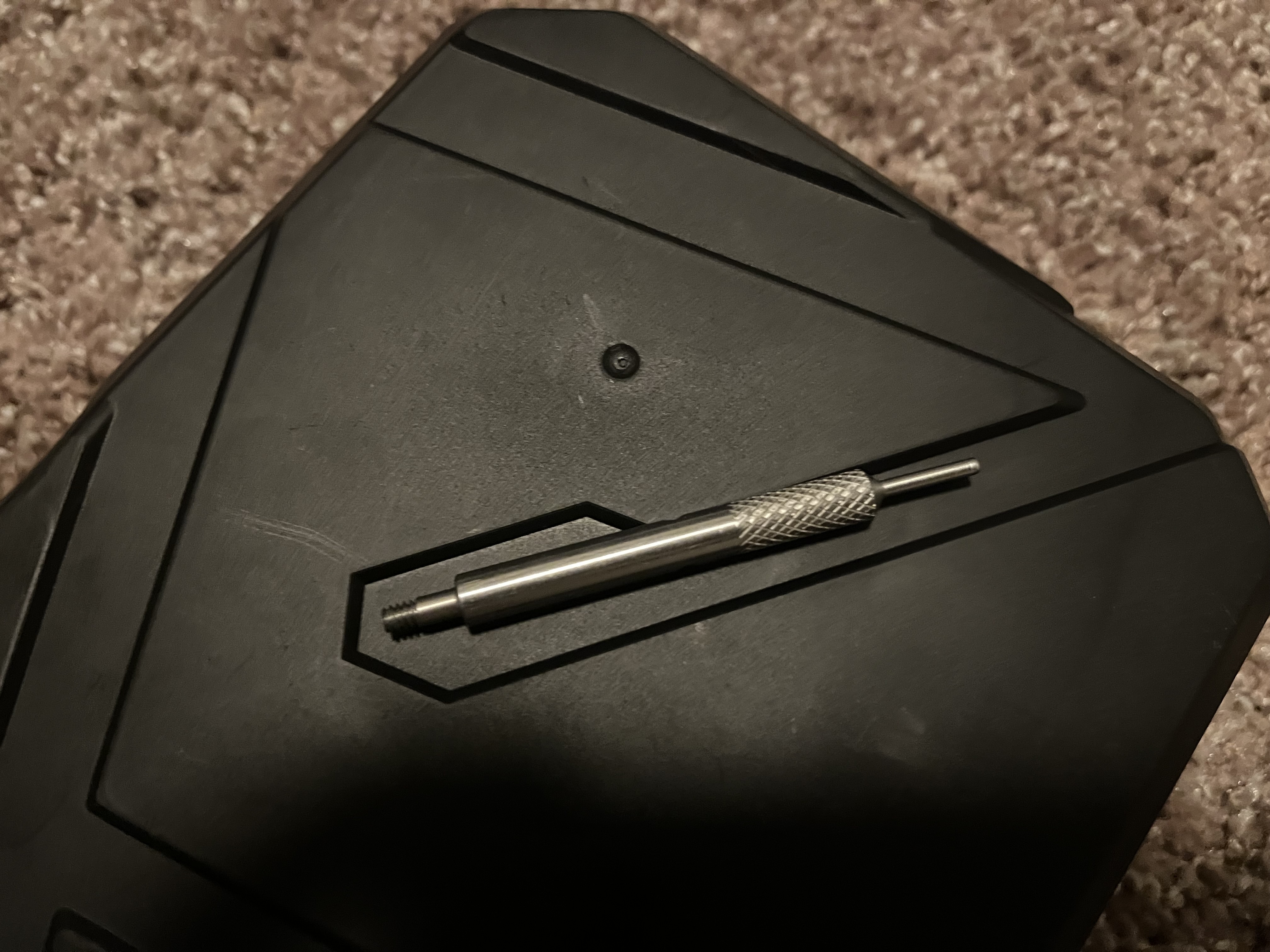

      The no longer available tool. Really is convenient, you can disassemble most of the marker with your hands and this tool plus one allen key.

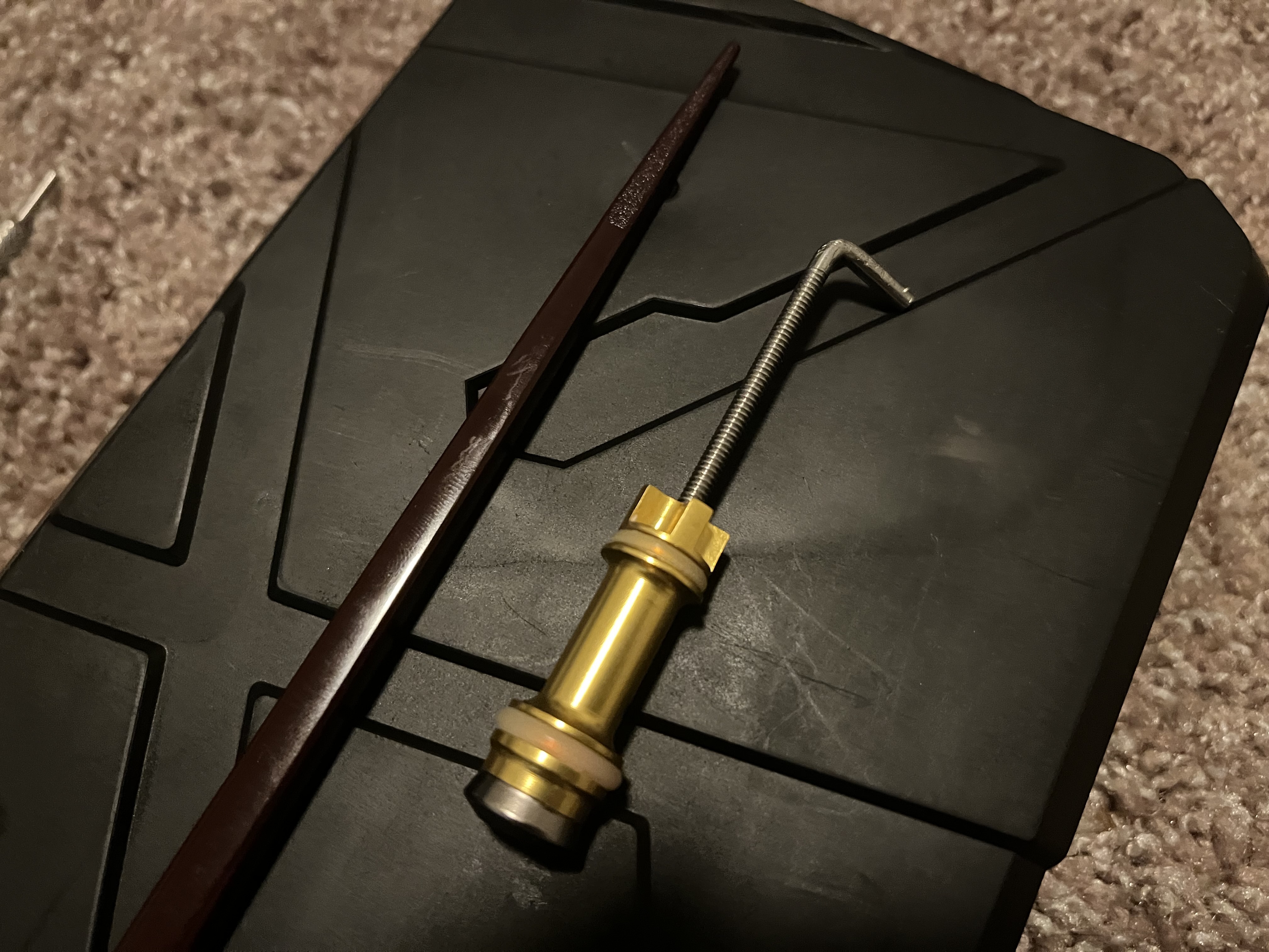

      Thinking of what else is similar, looked in my spare kit and found a trigger rod from an autococker. Happens to be the same thread and works great for removing the piston and the little bend is nice to help grip for extraction. For fine adjustments you can definitely just use a chop stick if you don’t want to use a dowel or a pick.
