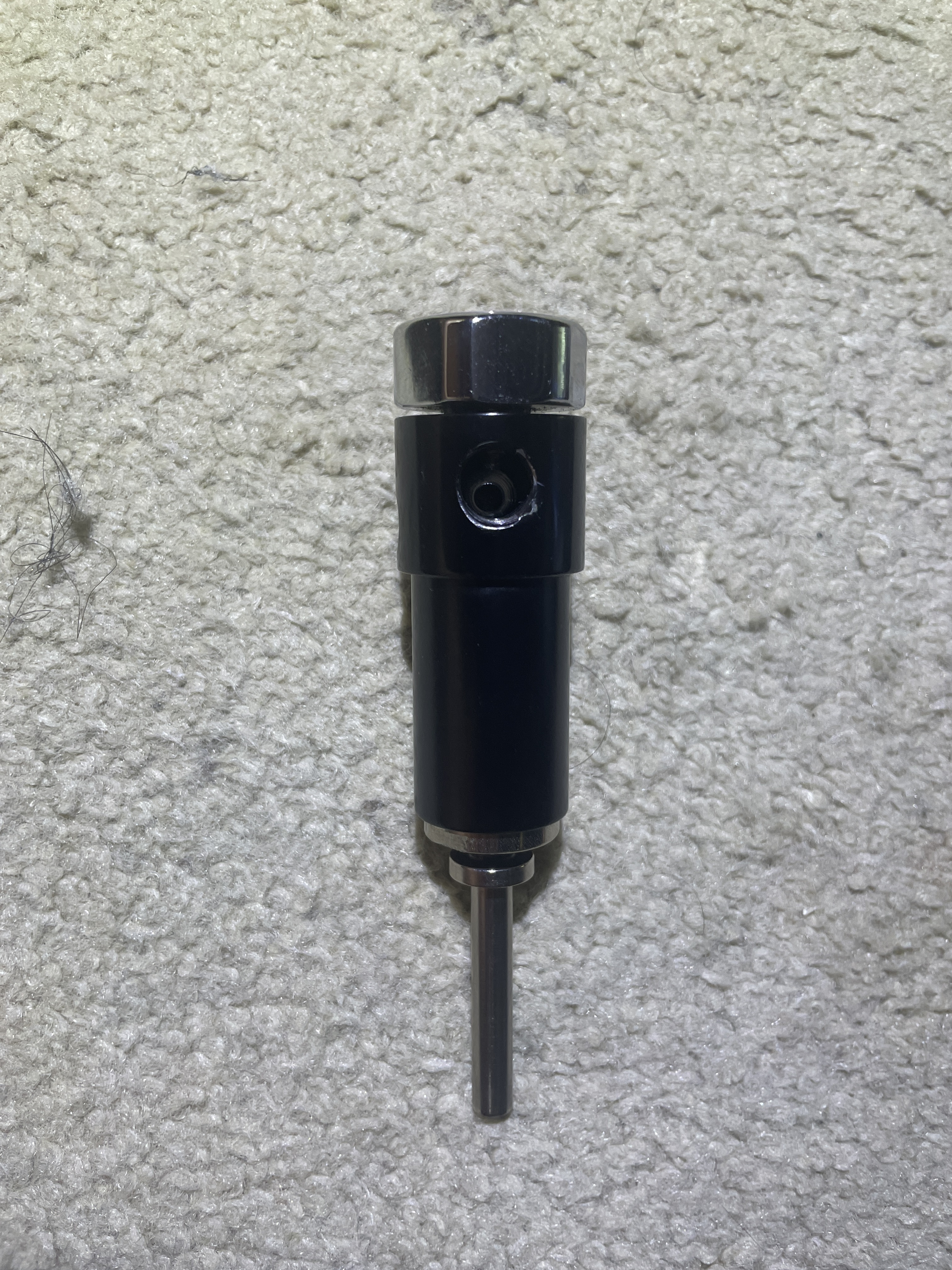

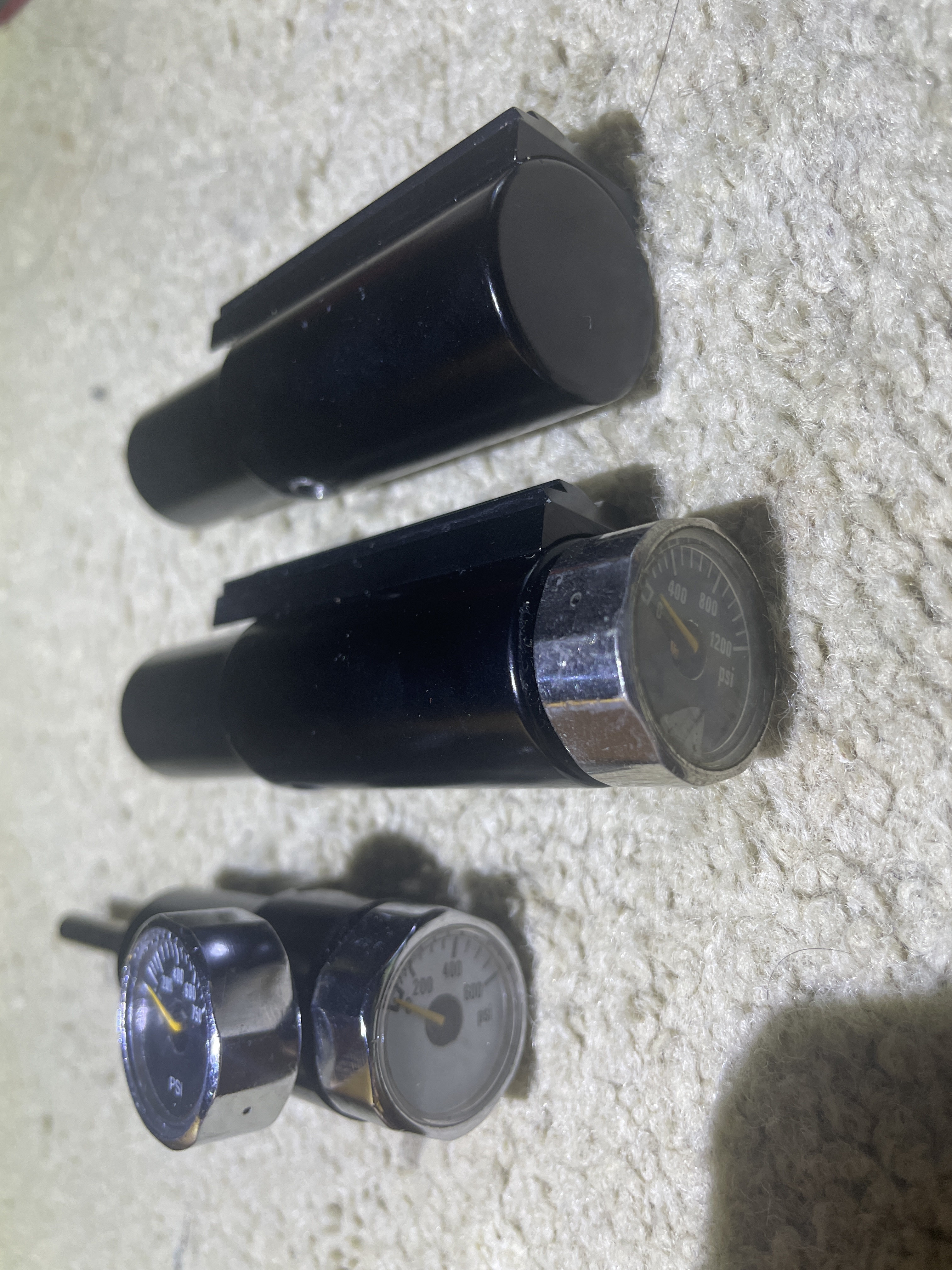

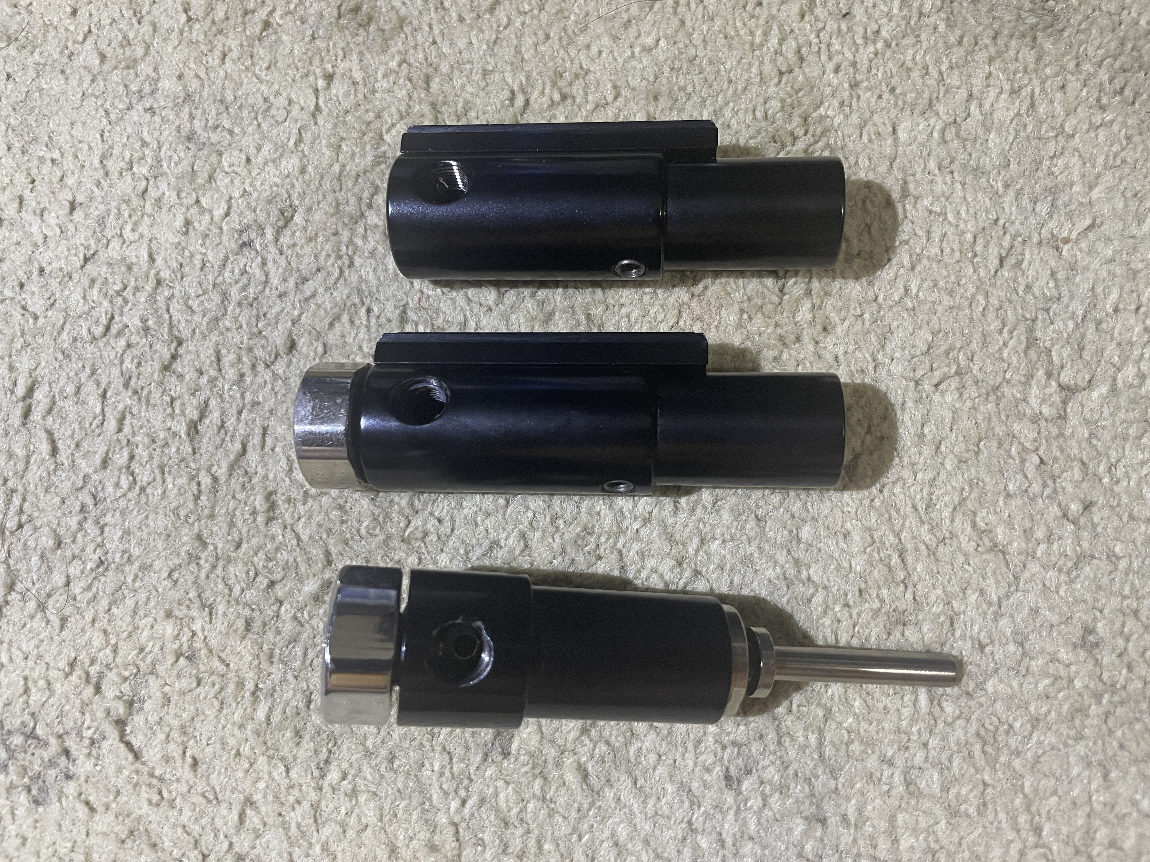

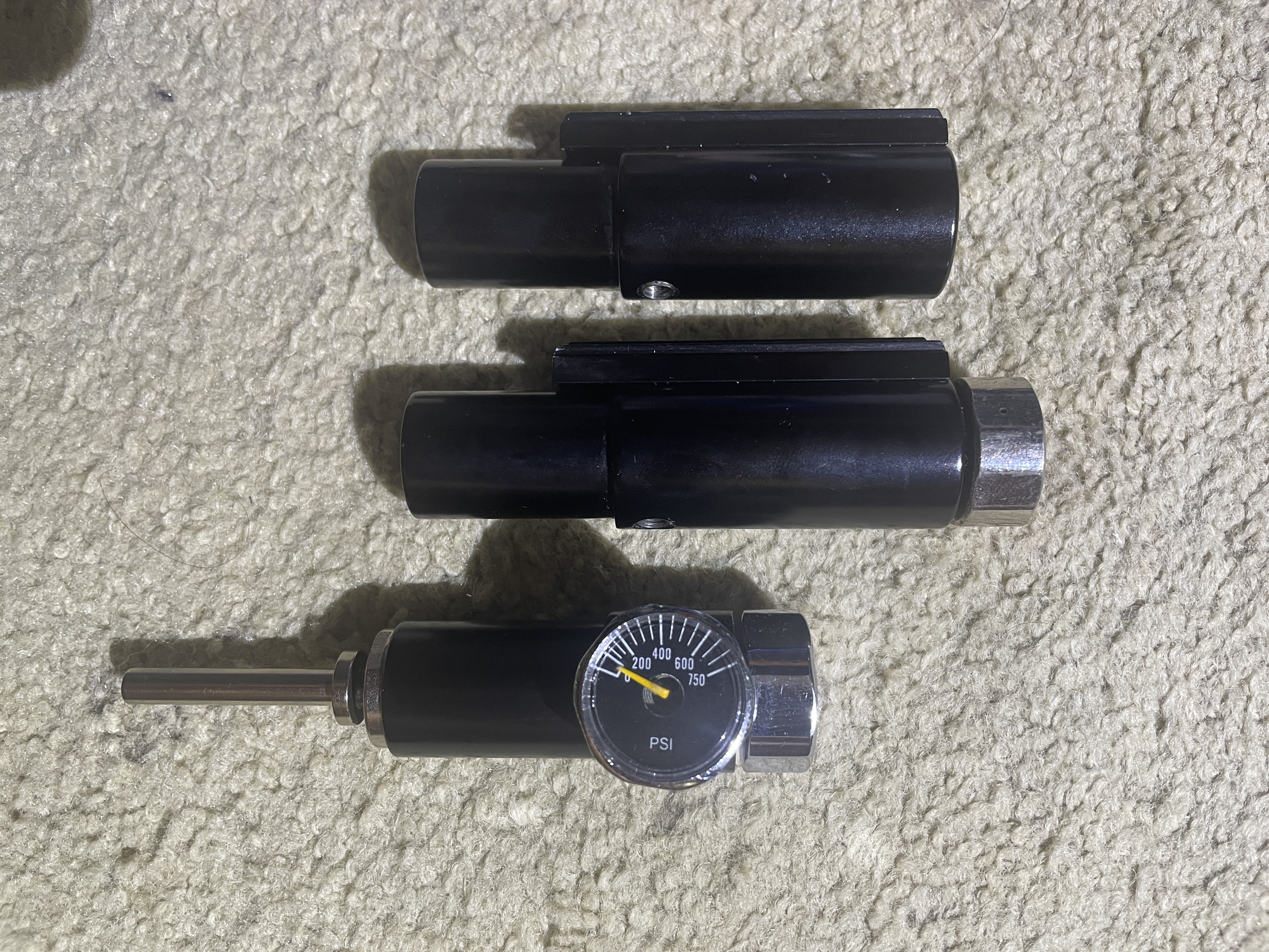

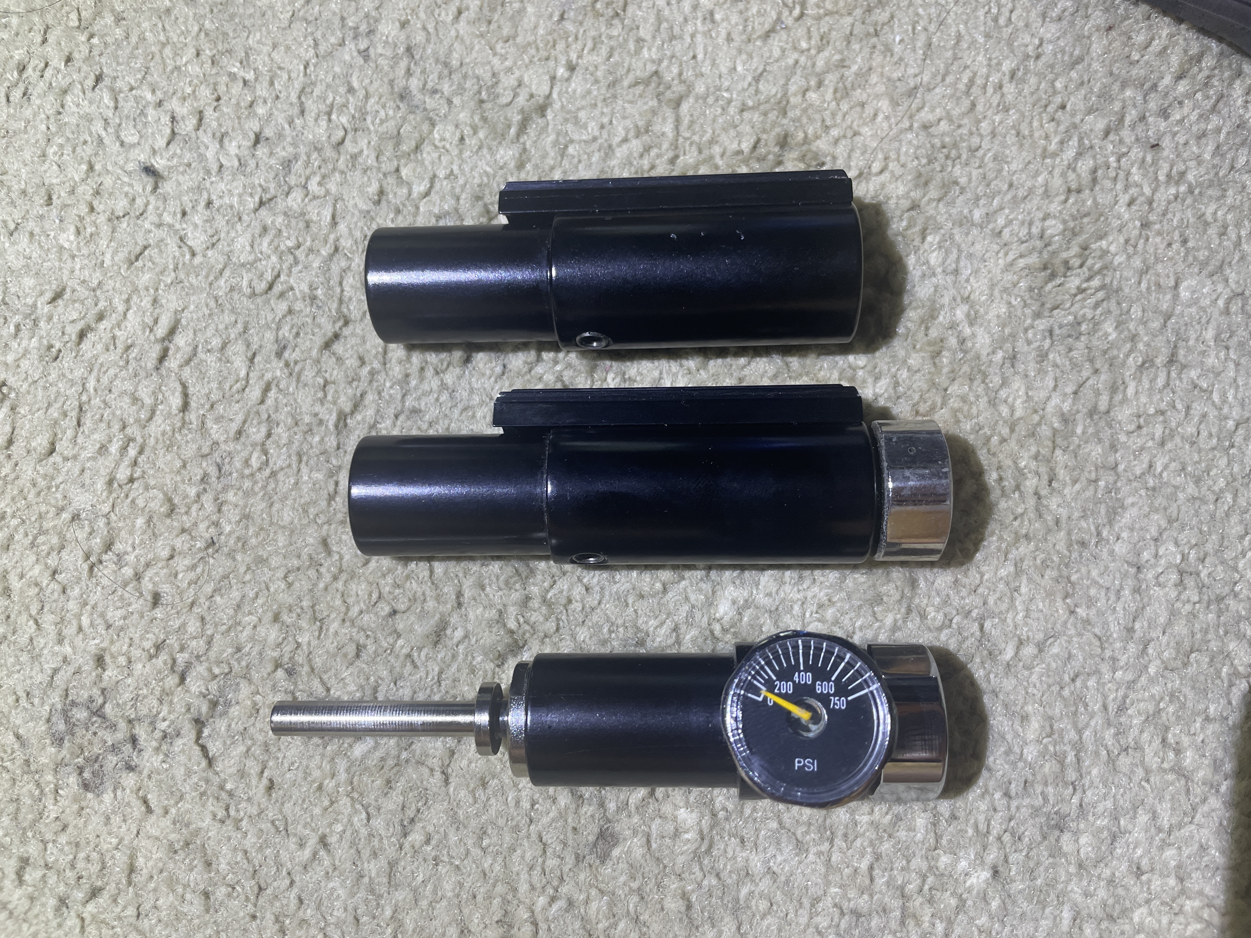

                I have a Punisher’s Bobbed and Guaged and Side Tapped Valve compared to a Guaged Valve and a stock valve.
                My Collection

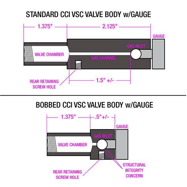

                  I'm hoping an illustration will help better explain how bobbing the valve works in regard to any perceived performance gains, as well as point out the safety concerns of this mod.
                  1) The size of the valve chamber is NOT effected at all when bobbing the valve body. It's simply not possible to cut the valve body down far enough to effect the size of the valve chamber because the position of the rear retaining screw prevents this from happening. The ONLY way to decrease the size of the valve chamber is to use some sort of filler/material that will reduce the amount of gas it can contain. As mentioned above, this can have negative effects in regard to springs and overall performance as the valve body has been specifically designed to hold a certain amount of gas.
                  2) The gas channel on a standard VSC valve body is approximately 1.5" long and approximately .125" in diameter. Bobbing the valve will reduce the channel from about 1.5" long to about .125" long - basically eliminating it. While this will certainly reduce the overall volume inside the valve body, the question is by how much? I find it difficult to believe that eliminating this tiny channel will provide significant ("significant" meaning an additional 10 shots), or even a noticeable increase in efficiency. This is especially true when factoring in the VSC hard line, or any other gas lines on the marker. I certainly didn't see any significant increases in the testing I have done with a standard VSC set up.
                  3) As you can see, the amount of material near the rear retaining screw is now paper thin with the gas inlet positioned on the same axis. Combine this with a gauge, and the structural integrity becomes even more of a concern.

                    My point was that the valve body itself is NOT as sensitive to volume reduction as many would have you believe. It's simply not accurate to only consider the volume of the valve body when there are hardlines, or any part that creates space (volume) between the CO2 source and the valve chamber itself. Unless you're using a valve body dropout, then there will always be additional volume to consider. Given the fact that temp, ball-to-bore match and paint quality will always impact efficiency far greater than the total volume between the CO2 source and the valve chamber (within reason), and given the fact that most players practice tactical reloading of their 12-grams during game play, it seems pointless to put so much focus on the volume aspect of the valve body.

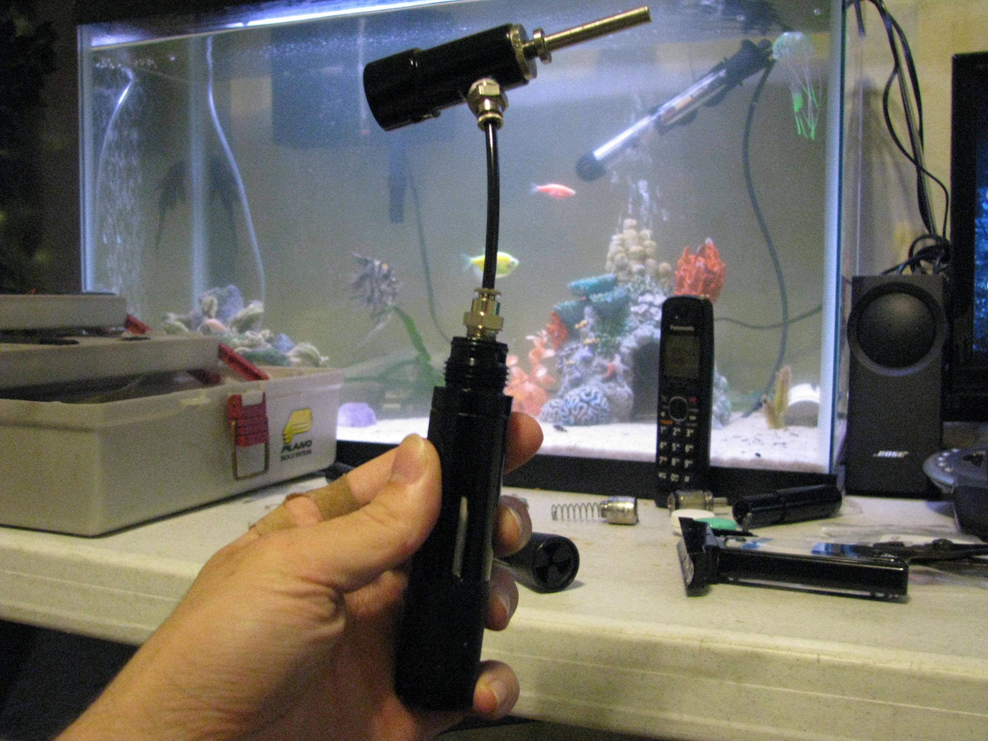

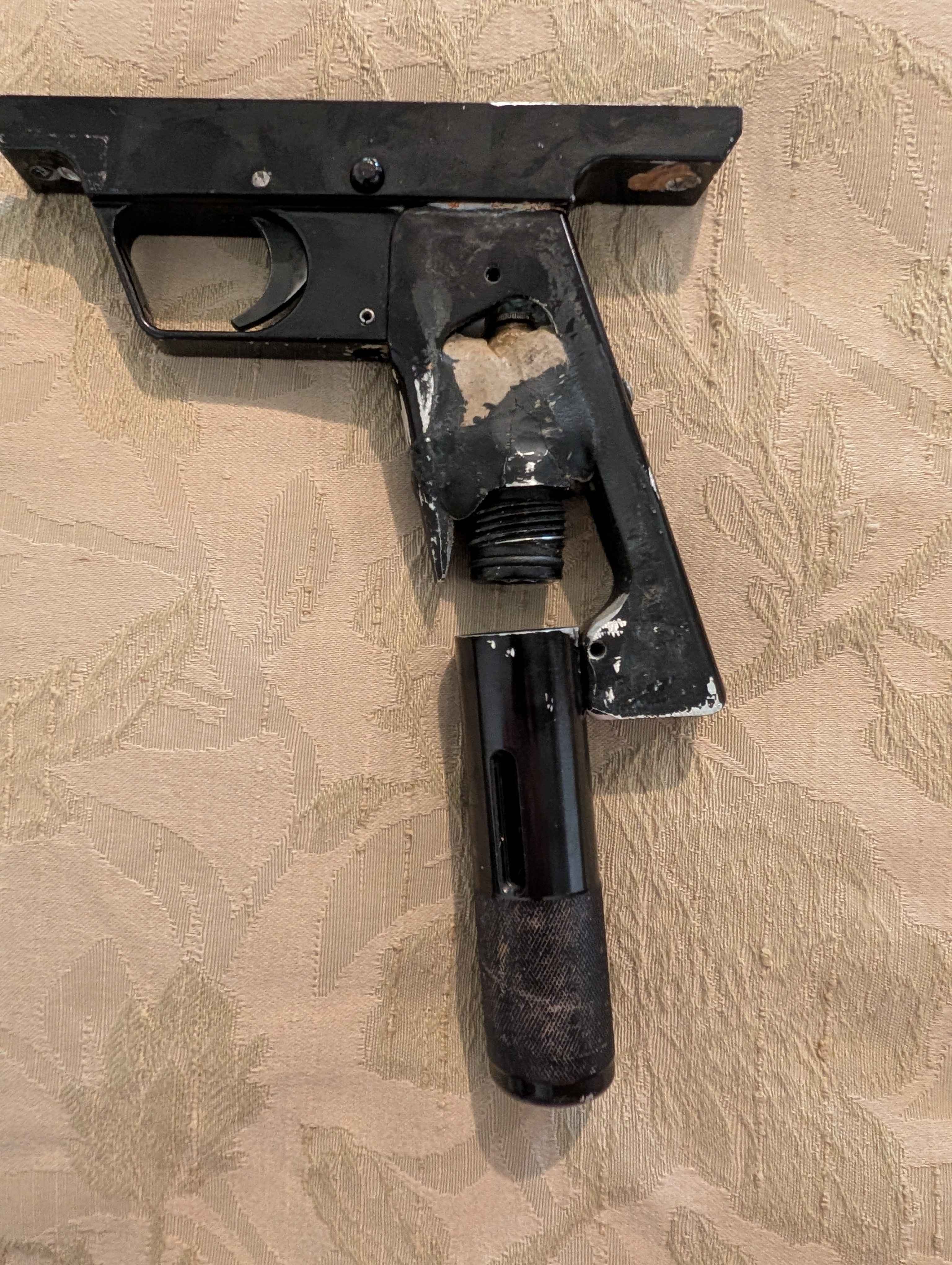

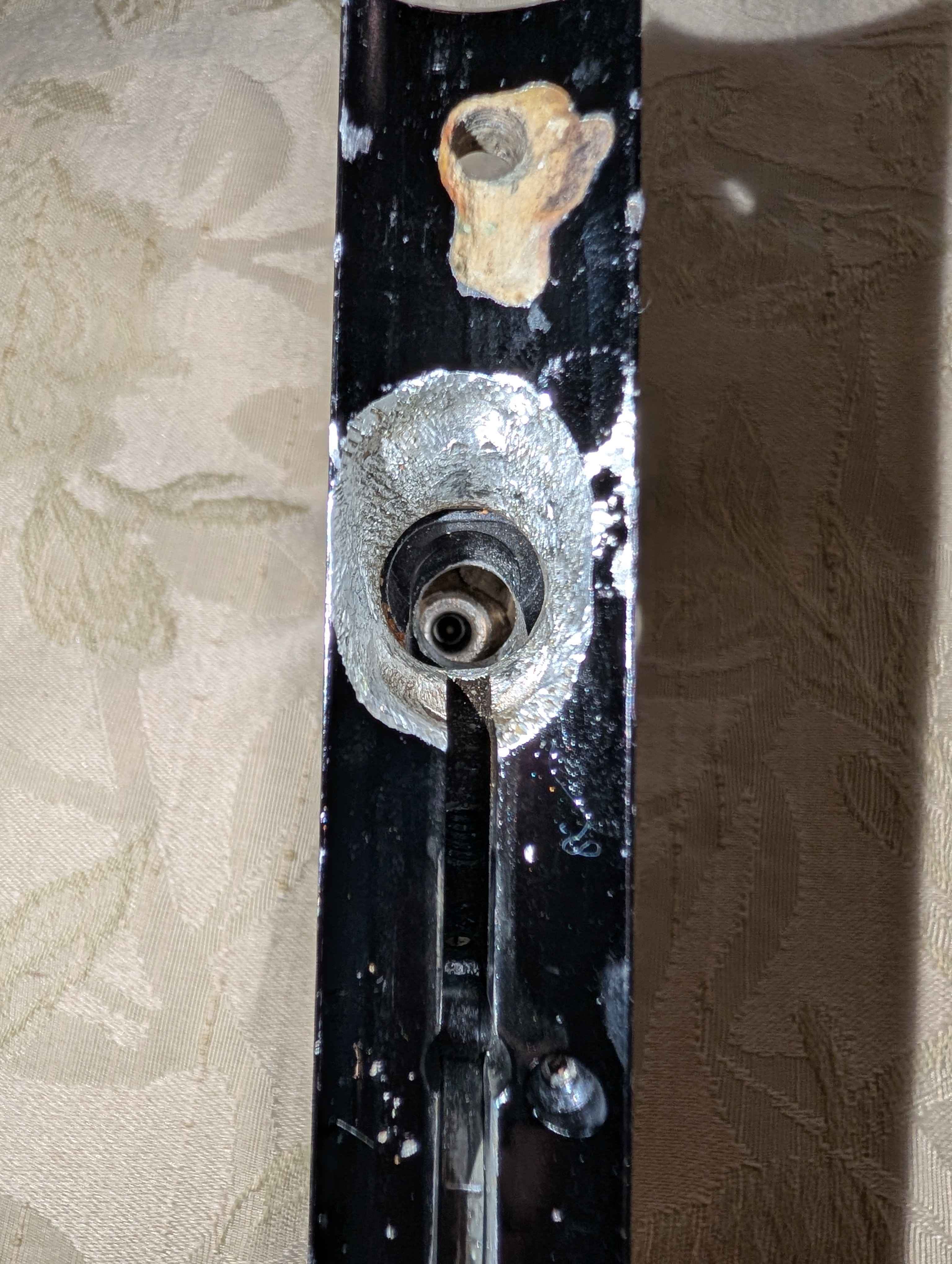

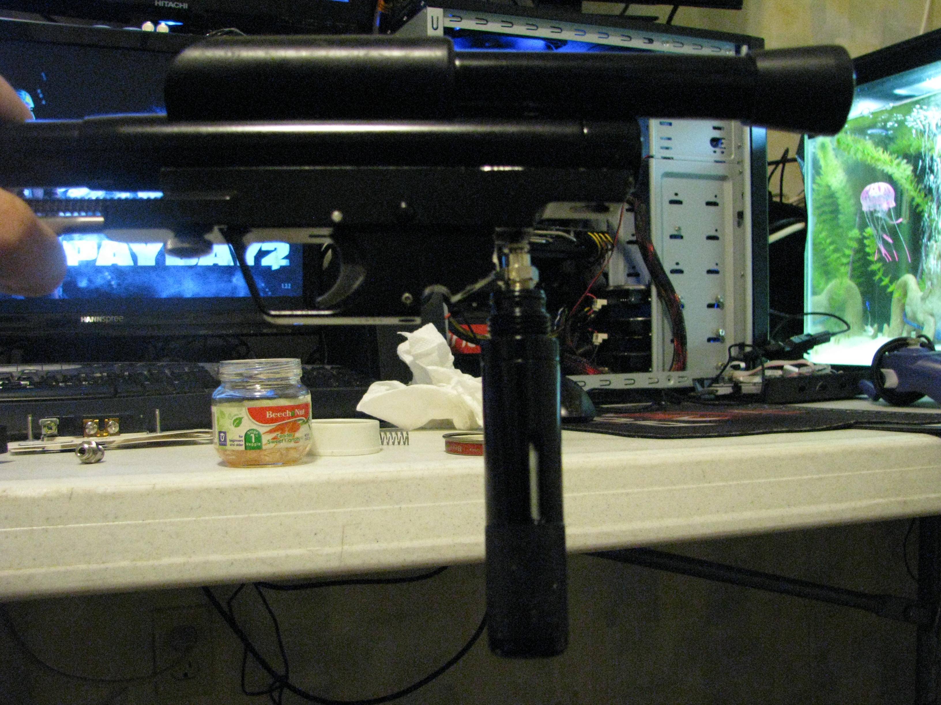

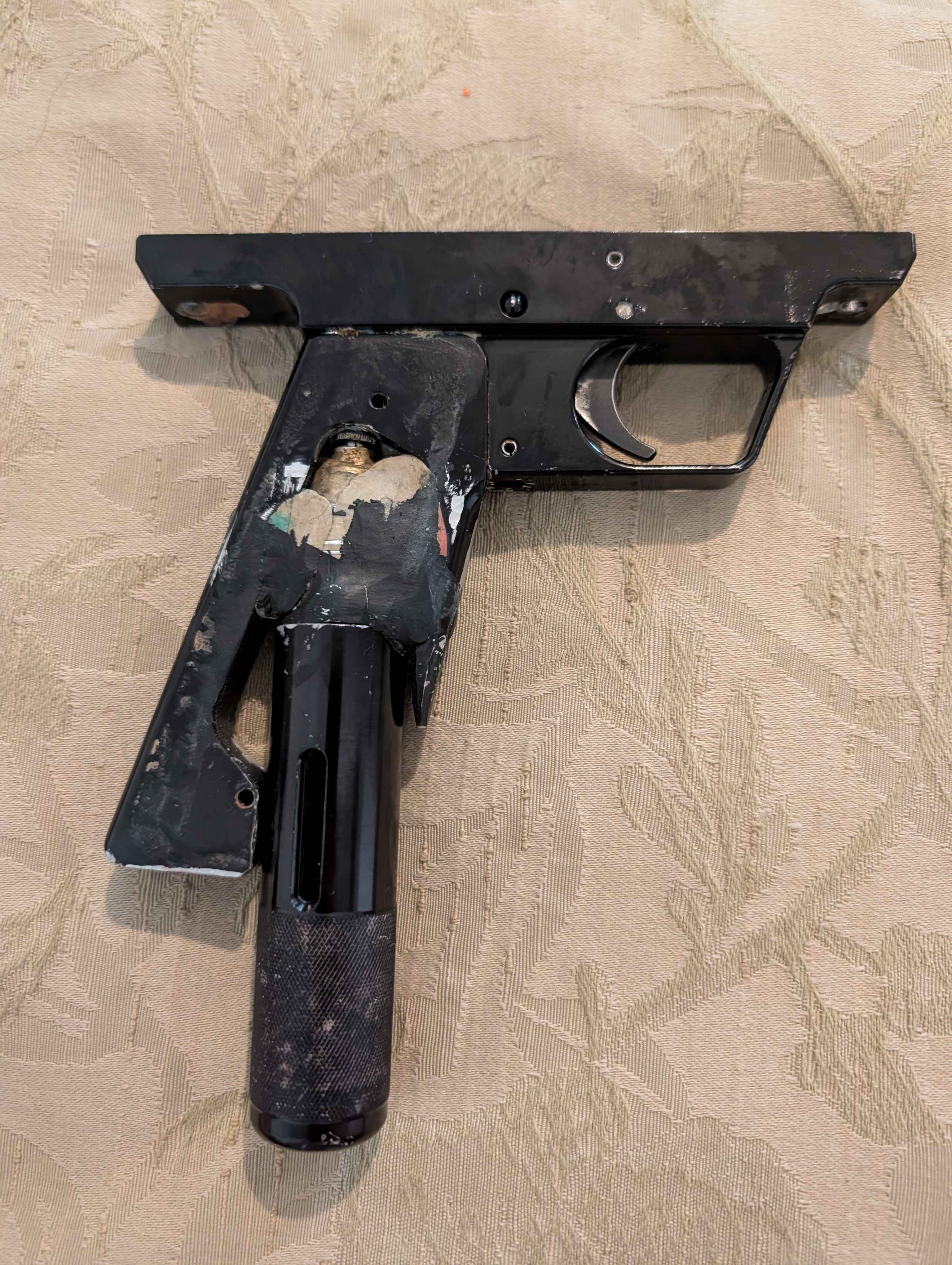

                  I'm trying to recreate a 12g bucket changer in grip system i made in 2012 and I'm trying to source a bobbed valve too.
                  It eventually started leaking because of my impatient sloppy pneumatic die grinder work at the time so i switched back to the normal 12g asa bucket. Since then, the bucket changer in my grip has just been serving as my spare 12g i carry out on the field. At some point I lost the bobbed valve so I've gotta figure out what I'm going to do to source another valve body to tap with a microline fitting.
                  I just reached out to SSC to see if they have any bodies on hand. I'd love to get my hands on one without any ports like the one in my previous build. I may jujst buy another ASA type body and cut off the threads and seal the hole before tapping a fitting on the frame/handle side.
                  imgur actually saved the jpegs from my original posts so i can share those and some images of the frame im still using
                  LMK if you guys come across anything or have any ideas
