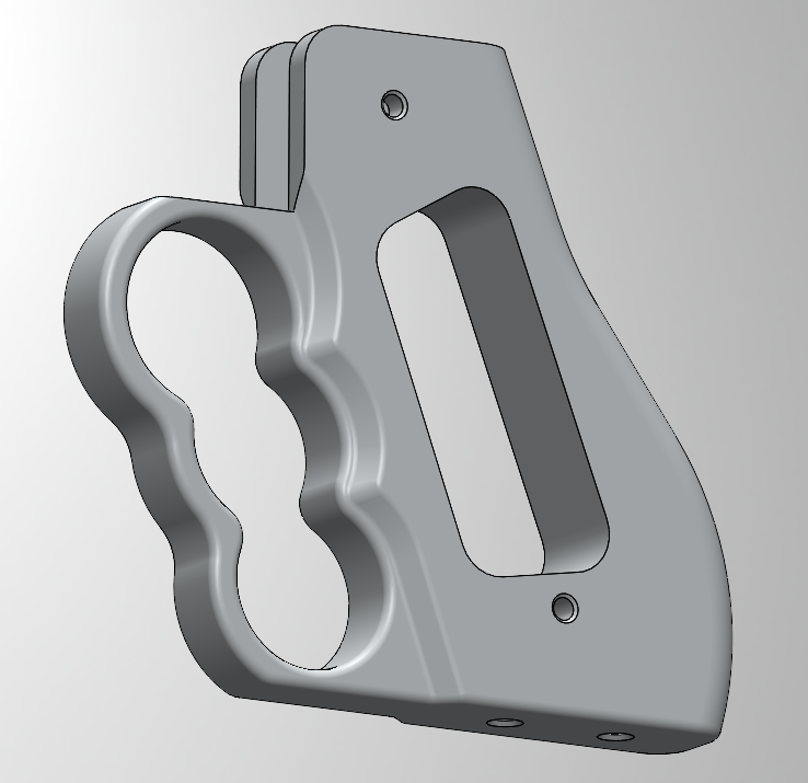

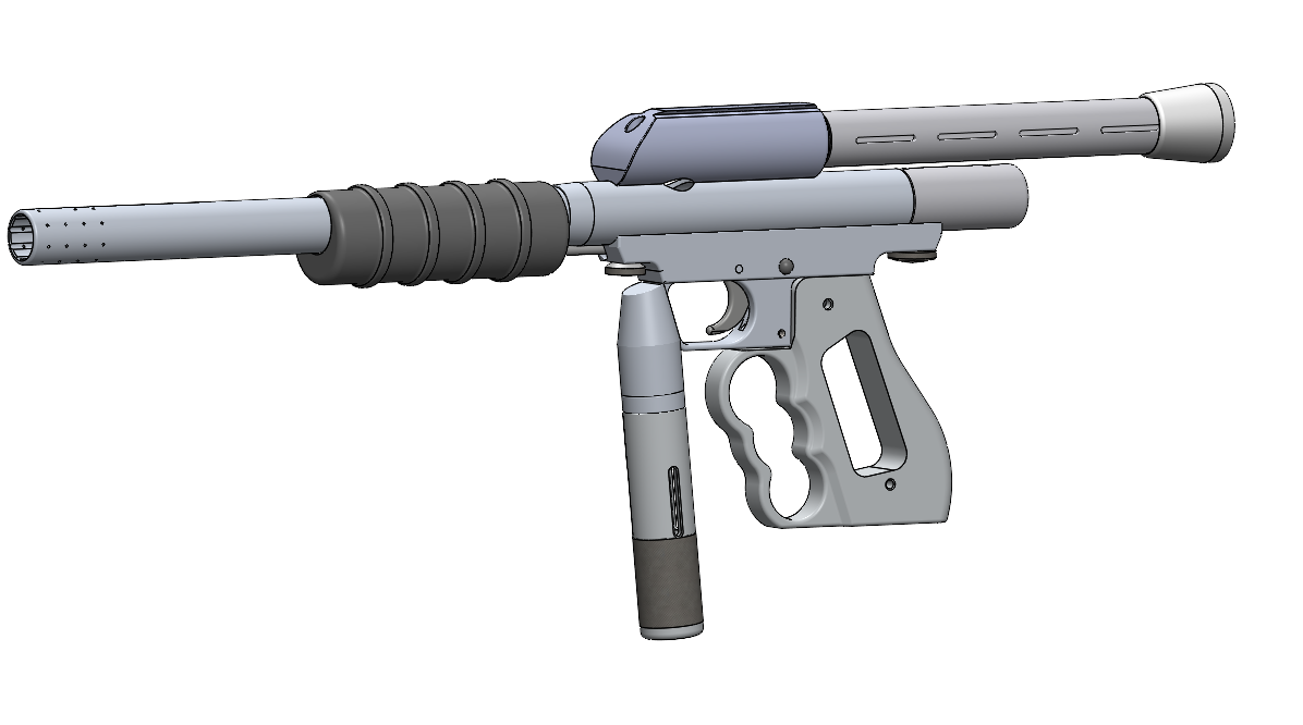

    Alright....
    The fancy version and yes I have a full phantom cad file....
    Unfortunately this is where it will likely die
    Cost at a minimum of 10 units will run $260+shipping raw.

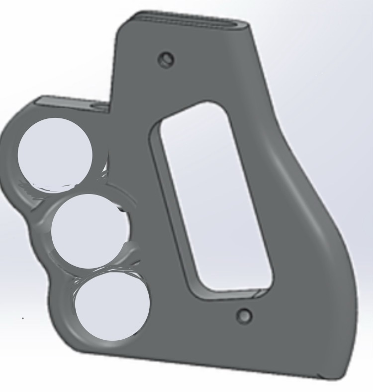

      A GORILLION YEARS in the bootleg photoshop on my phone
      how much of a pain would it be to get the design tweaked for these options?

        redsquirrel commented
        Really like the individual finger holes
        Ecapnation commented
        It's impractical for glove users
      • 4331
      #18
      Nothing is impossible digitally speaking
      The thing is making them wouldn't be cheap

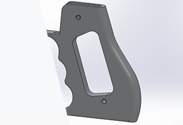

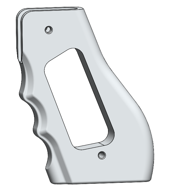

        • 4331
        #19
        Bash guard - less...
        240 raw I would have to order 10.... To get that price each
          To get to that point I'd probably have to order a mile of extrusion to save machining time.
          There's not enough people playing that would order one to justify the costs involved
