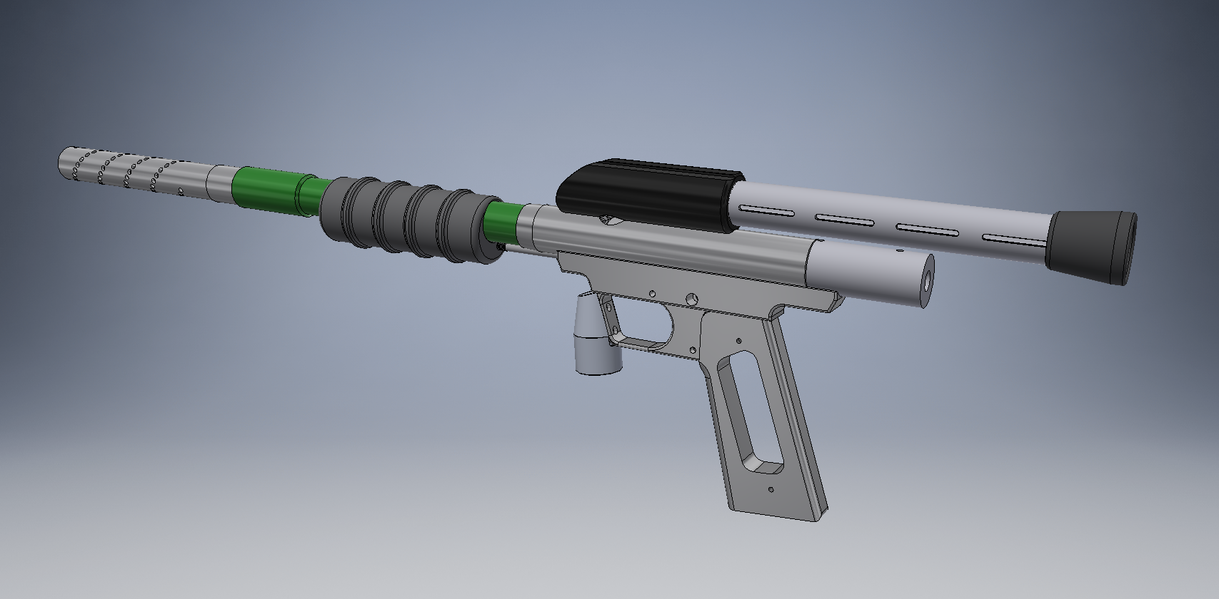

    I sketched something up and I'm wondering if it's worth a run.
    Using a Freak XL insert, a standard Freak front, and a custom back, it should be possible to run a Freak setup on any Phantom stock configuration. Through the stock pump handle, above an undercocking kit, whatever. The threaded portion is far enough forward to clear the pump, like the old school J&J kits.
    Is this something where there would be a lot of interest? Enough to make a few dozen, so there's actually a chance to get it under $100? Shown below in green.

    I’m in for 1. I have a freak threaded Apex tip that’s been waiting to be used on a Phantom for far too long.

      Yes please x2.
      Would you be able to make one designed around a Nova Slide?

        I don't have one to take measurements from - what's the ID of the slide, and how much of the barrel does it cover?

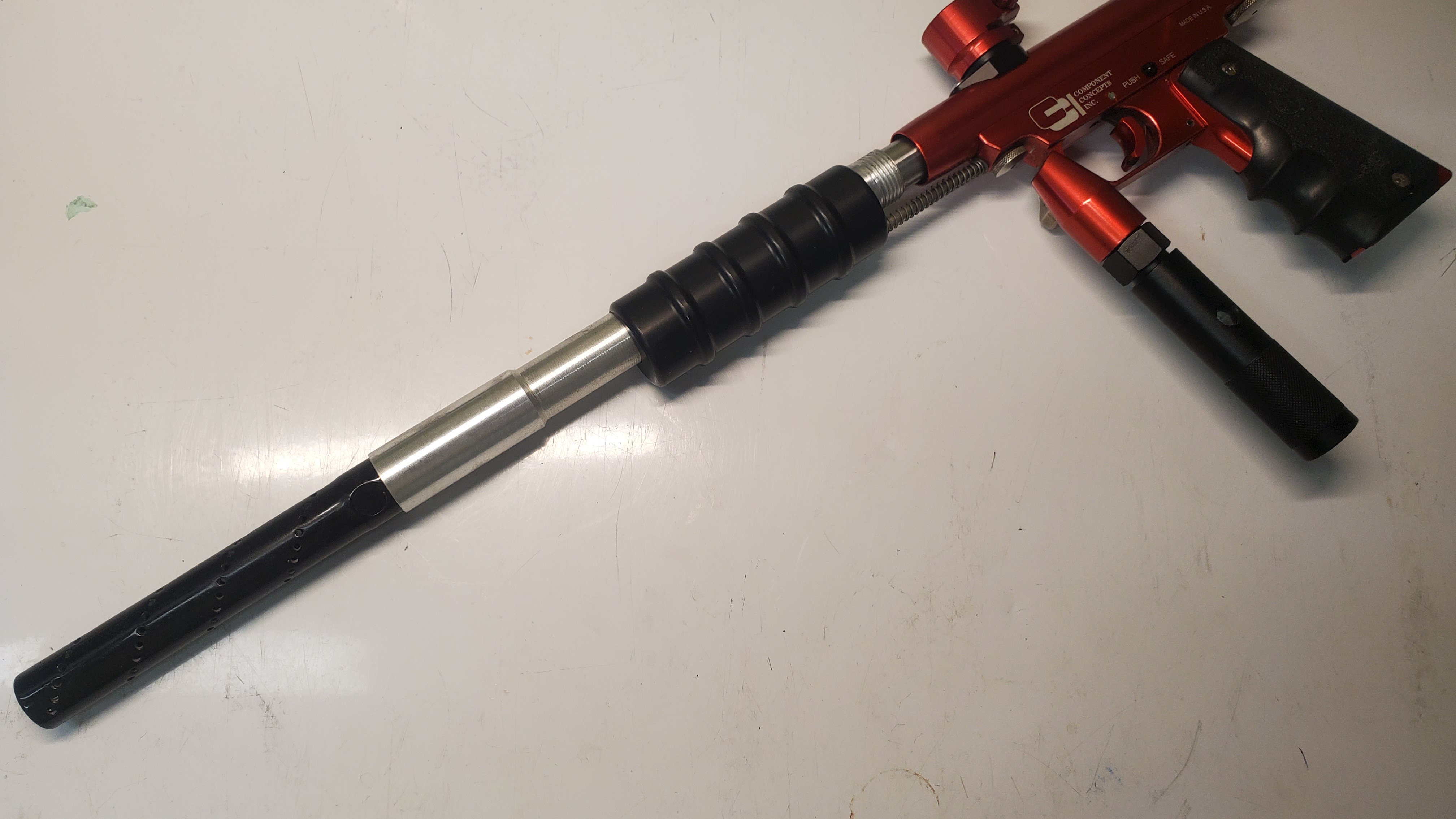

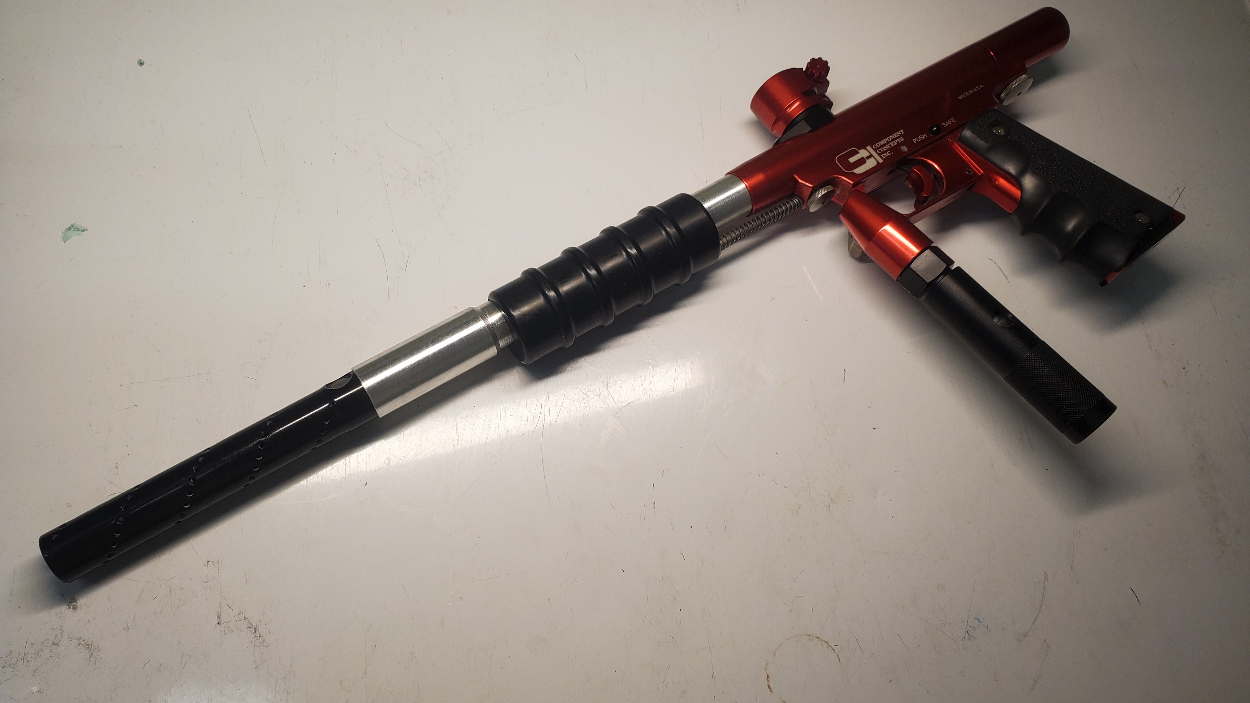

          Made some progress over lunch today, so now there's a physical test unit in hand. I'm thinking preorders at a discount to gauge how many people genuinely will buy.

            Opened it for preorder with a slight discount for the early birds. Gonna take about 6 weeks to get them in hand.

                  These are now for sale/ shipping!
                  I'm also able to bore stock Phantom barrels for either 5" or Nova (70mm) inserts, but will only do batches at the moment due to setup times.
