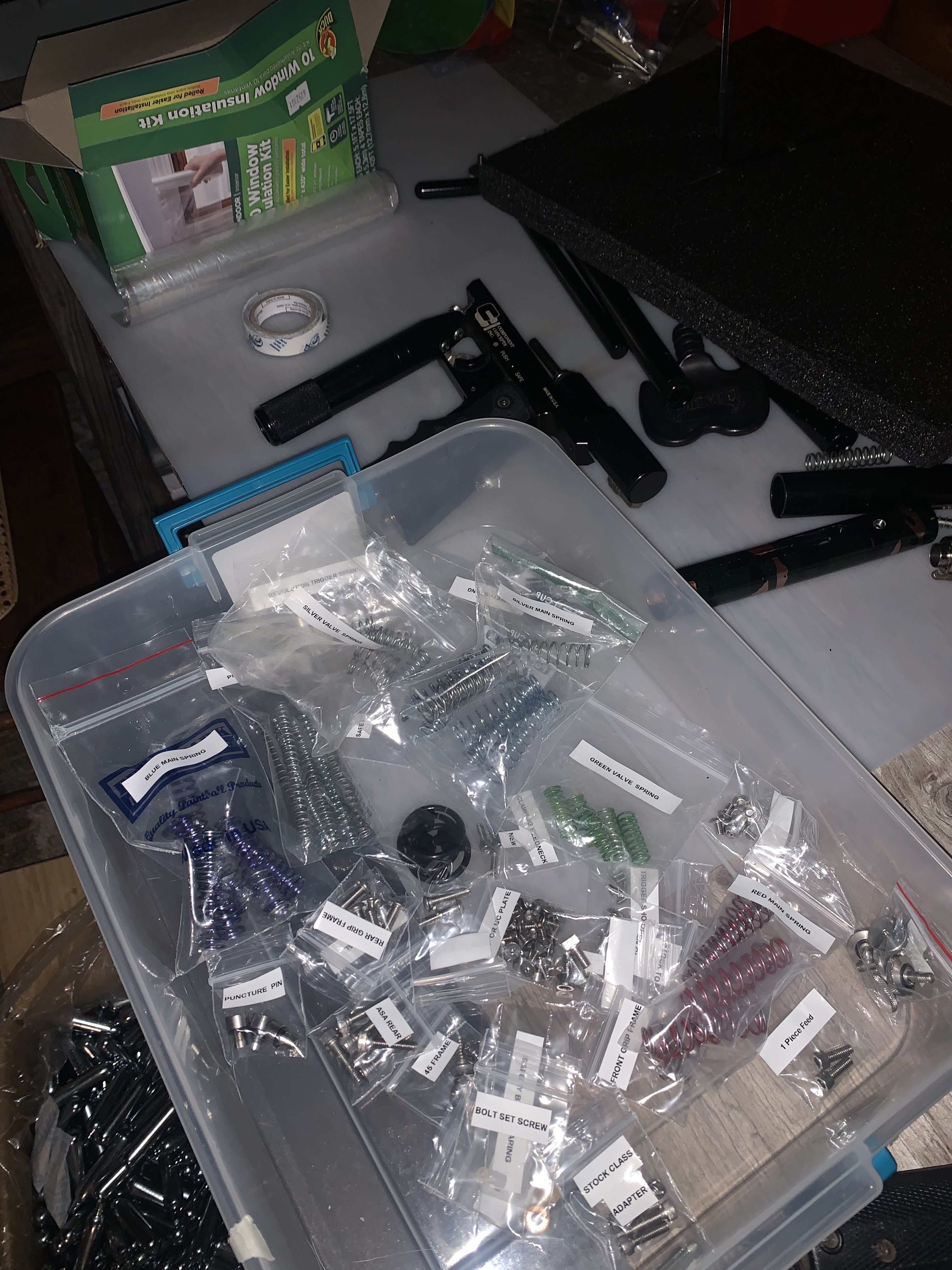

    Next up is sorting my Phantom parts bin and finding a couple Phantoms to test with. One with the ASP mod and one without it. They’ll get a full breakdown, new seals, tested for any leaks with soapy water, etc.

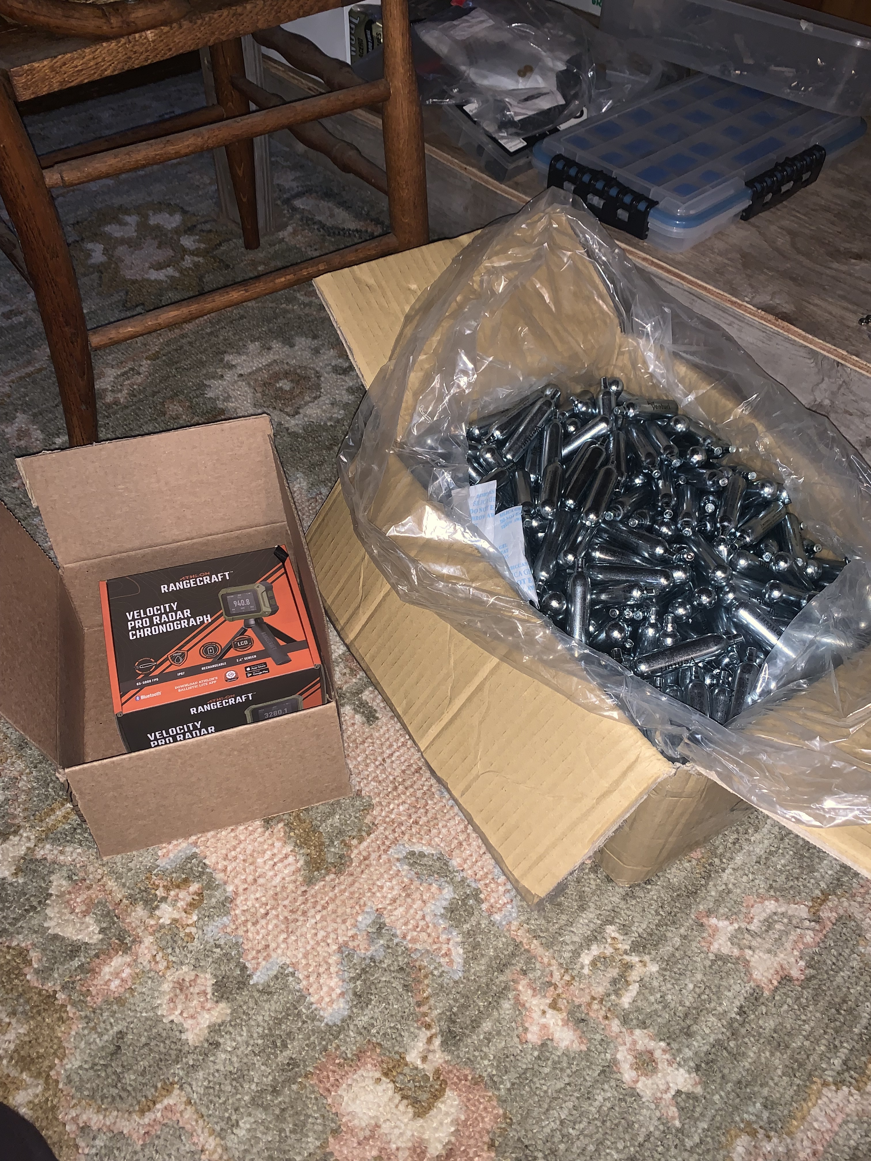

    The 12 grams and chronograph are here. I also picked up some HK paint. Wanted to ship it in before the weather got crazy. Work to be done before the testing:
    1. Sort Phantom Stuff

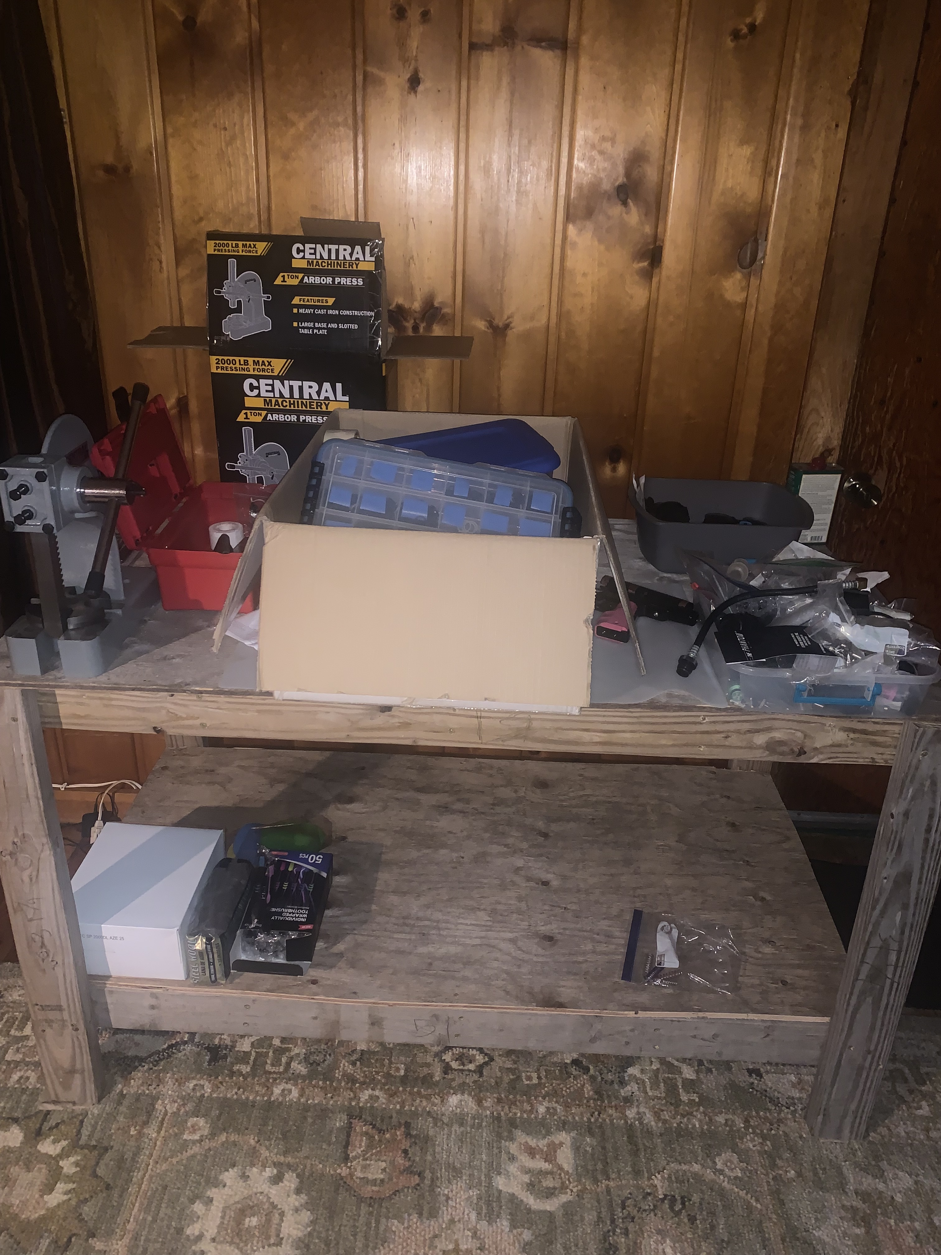

    Organization is happening!
    The goods have arrived!

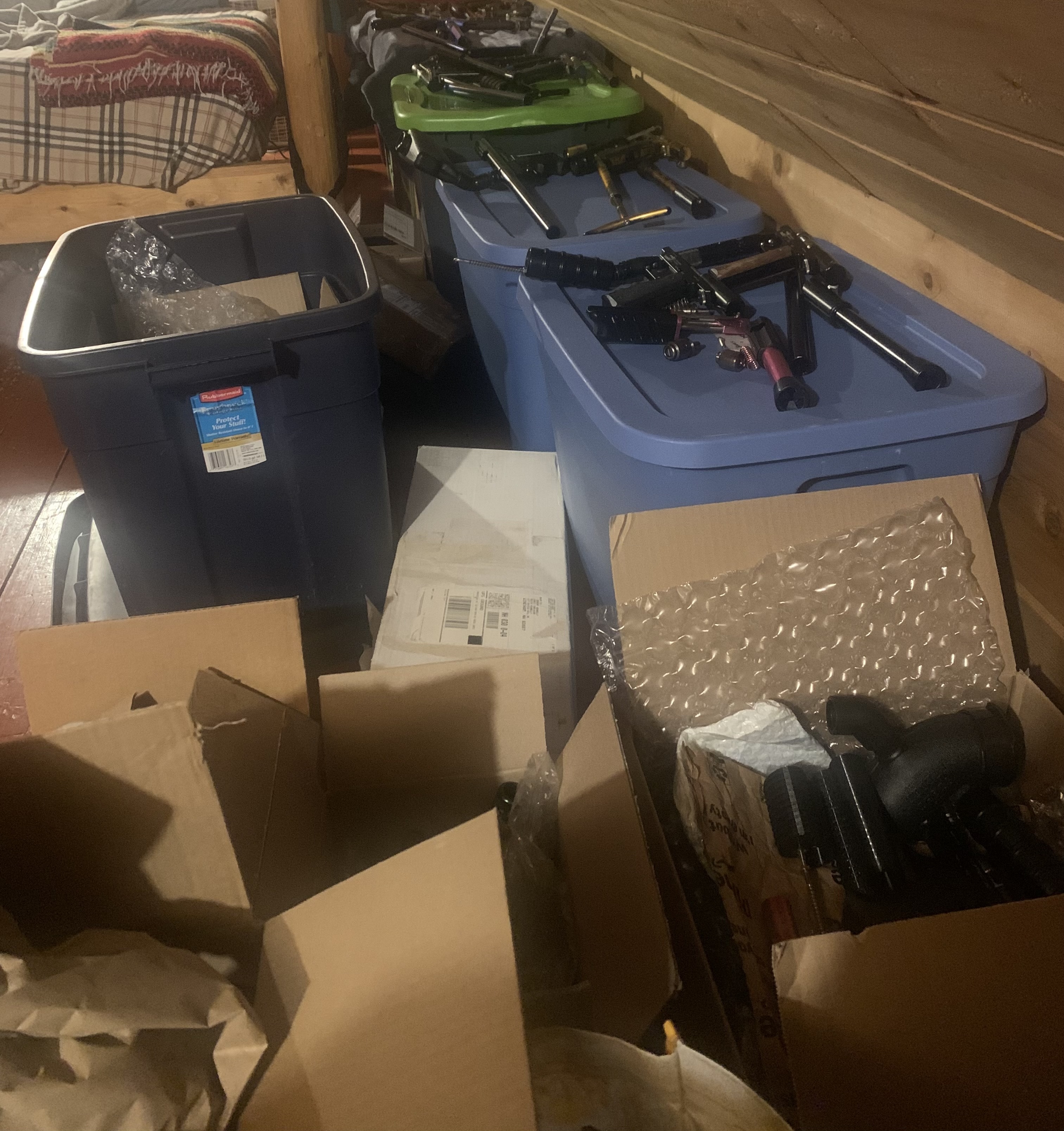

          Weekend progress, mostly studying for my exam this weekend but I managed to organize the Phantom workbench.
          Most of my bodies and barrels are on winter vacation, heading to see flyweightnate. This left me without a Phantom that doesn’t have the ASP mod or a Freak bored barrel. It looks like Phantom1313 and I are going to resolve that. As for the test subject that is bored and ASPed:
