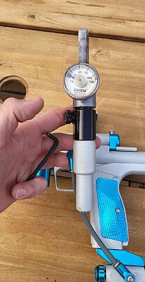

            Revisiting this.. I had a wild hair today, and decided to peek I to the hpr of this beast. This plunger WAS flupped flat side up. I didnt think anything of it.. the pin on the top end is pretty corroded. I cleaned it up with white vinegar best I could. When I put it back together, I naturally flipped the plunger like this. Then I stopped, and looked the manual up online.. maybe this is why it wouldnt work.
              That will do it. Sometimes people adjust the reg in to far and it will mash the top pin requiring a replacement. But if that piece was flipped it won’t balance out pressure properly. You have a reg tester? If not just sweet spot that bad boy the old school way over the chrono and don’t touch it till in needs a good cleaning.
            • 3415
            I pulled the valve and greased that up also. I think the valve retainer nut was backed out some also.
            I tossed this makeshift reg tester together and got it holding air a few notches above the 250 psi line, from what I've read, they come factory set to 290. so Im in the ballpark.. It wanted to leak with the hammer weight on the valve. BBut if pre cocked it cycles. My buddy has my chrono, and my gun shy dog says that's all I get to try today.
