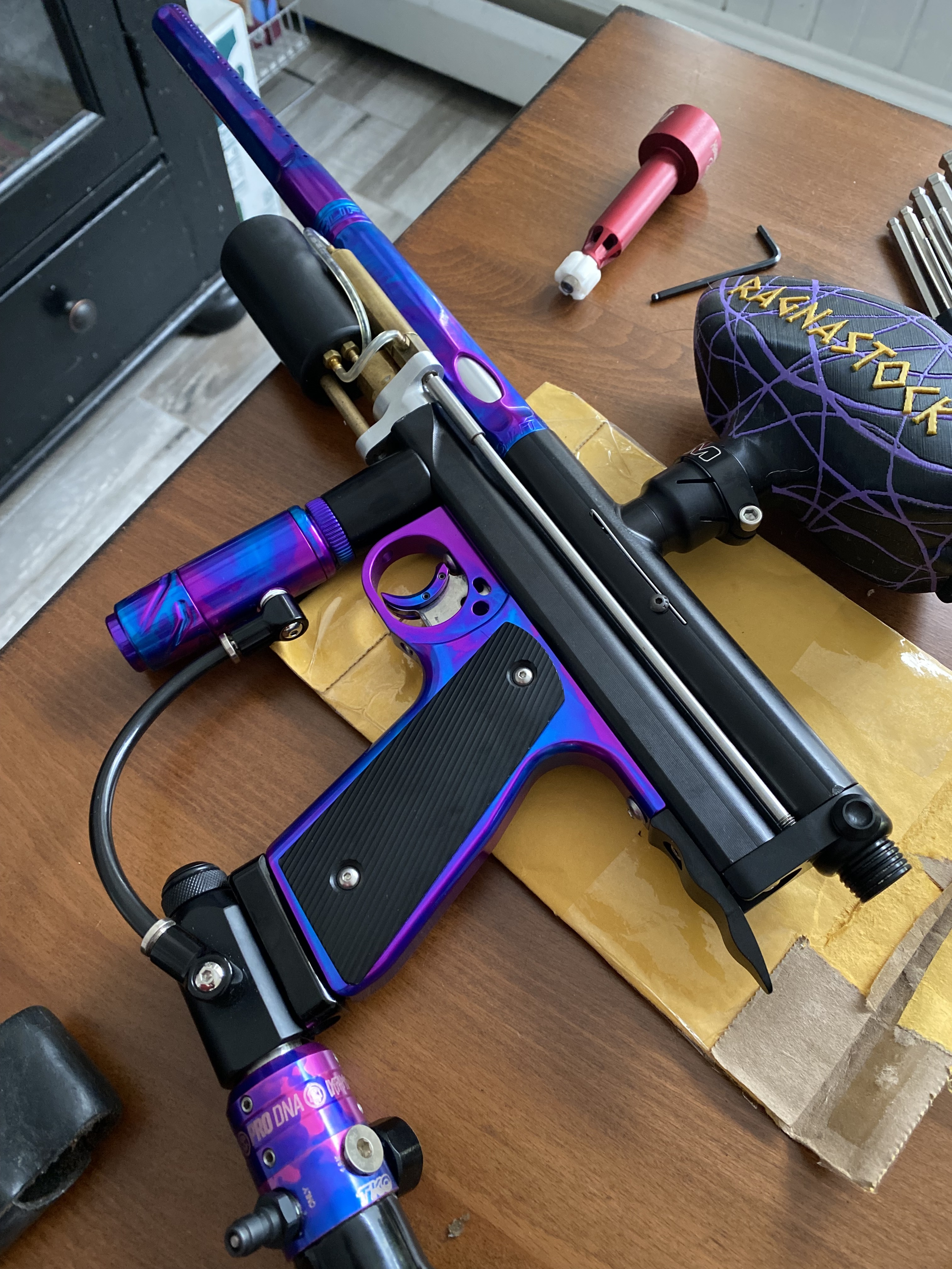

    I’ve done some reading. Lots of options and most of the hpr would be just fine. I was hoping to get options and thoughts on why someone would choose one hpr for their T2 over the others. As of right now, CCM isn’t offering/ is out of stock for regulators for the T2. I got a hold of a T2 that has an after market reg that I just don’t like. It has a gauge on it etc, doesn’t look as right to me.
    What would you guys suggest for a reliable, consistent, and easy to service reg for a T2?
