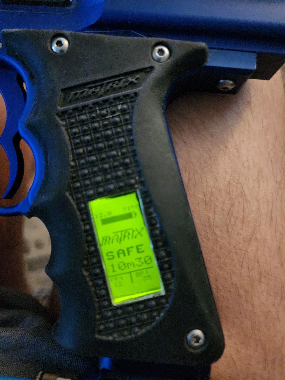

      It's currently at 12fp and 35bp. No fsdo and slow single pulls are fine.
