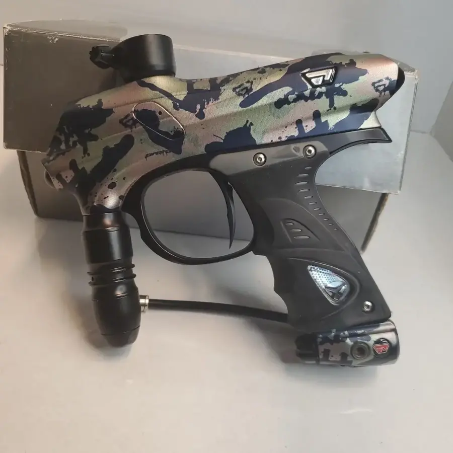

    What choice of better bolts do i have for a pm7? i couldnt find what other years or dye guns fit the pm7 to even begin looking. thank you! pm7.webp

    I thought the only upgrade to these bolts were the Billy Wing bolts, but also not sure how much of an upgrade they are.

        Most bolt upgrades for the Pm/dm series are downgrades... More so with the early 2000's ones.
        Believe it or not best bolt upgrade was the hose mod. Hybrid sold a metal version. Basically it took some volume up and made them use less air

        Cheapest & best:
        - hose mod if you need efficiency and
        - run 050 duro buna orings on the 017 positions. This will decrease friction / lower LPR, same effect as BW bolt/polishing.
        - run 050 duro on the sail or tail too if you like, it will help but I found these positions a bit less reliable/effective. Don't do the 014, it's prone to blowing out.
        BW costs too much, L7 is a totally different bolt. The fuse bolt really is a robust design

          i see someone on ebay has a dm11 soft tip bolt in theirs. i guess thats a easy little ugrade to be easier on paint?

        You can run a DM9-11 bolt, but you basically need to buy a full assembly because you need the DM bolt, tophat, and backcap. You use those with your PM can for the setup to work in a PM5-7.

        I installed a Dm9/10 bwing bolt in my Pm7 with the Pm7 can and DM9/10 back cap. The bolt protrudes into the breach a bit. I know that this can be remedied with an oring on the back cap by the threads but does anyone know offhand what size and duro works well for that?
        EDIT: looks like a 017/70 might have done the trick
