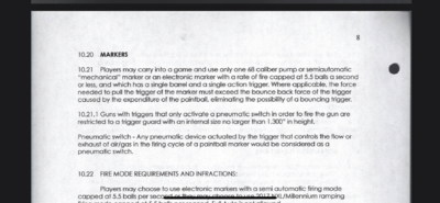

                Is an Emek with either setup still mech-tourney-legal?
                • Toestr
                  • 2875
                  • Poland, Onterrible
                  Yes. The only limitations is that a pneumatic switch operated guns can't use a double trigger or have an rt effect.
                    • 6380
                    Both valves are universally accepted in all Mech Tournament's. This is the snip from the official ICC rule book.
                      Jordan commented
                      So, despite these valves making the trigger "walkable", as displayed by a video by QMTO, they're good?
                      Yes and just like whipping and playing on you can get a penalty for it. The 1.3” trigger frame is intended to negate that. However it can be done with a very light trigger setup. You get caught riding that line well that’s on you. The consequences are worse then the benefits. You aren’t going to last to the buzzer burning paint like that and every body counts in 10 man. Lots of guys run these setups and I have yet to see people trying to jam two booger hooks in a single trigger frame while playing. Fun thing to talk about but real world benefits meh… What I do know is that new shocker engine rips faster then the PE markers with the Hair valve. Seems like they upped the efficiency to. Also these 10 man events are not won with ROF. It’s all about how well your team works together. Sure you can shoot lanes but most 10 man fields are long. You Only really got a chance at hitting the front runners looking to take Real estate off the break.
