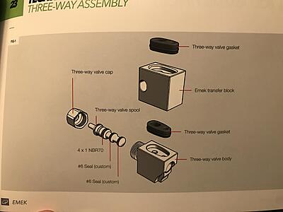

                • 6380
                According to the manual they are 4x1 NBR70 I think that’s a metric size.
                Looks like it’s a “special o ring” .49 cents a piece They don’t give you the actual size of the Oring. I find it hard to believe they made a special size specifically for the valve. They are just not giving you the actual size to cross reference it with. Maybe shoot there tec a message see if they will give you the size so you can buy them in bulk. They may even send you a bunch if you explain what happened.
                • Toestr
                  • 2875
                  • Poland, Onterrible
                  According to the manual they are NBR70
                  It's a 4x1 oring (which doesn't come in PE rebuild kits), NBR70 is material and durometer.
                  Sent from my Pixel using Tapatalk
                    4x1 is Planets Reference on size.
