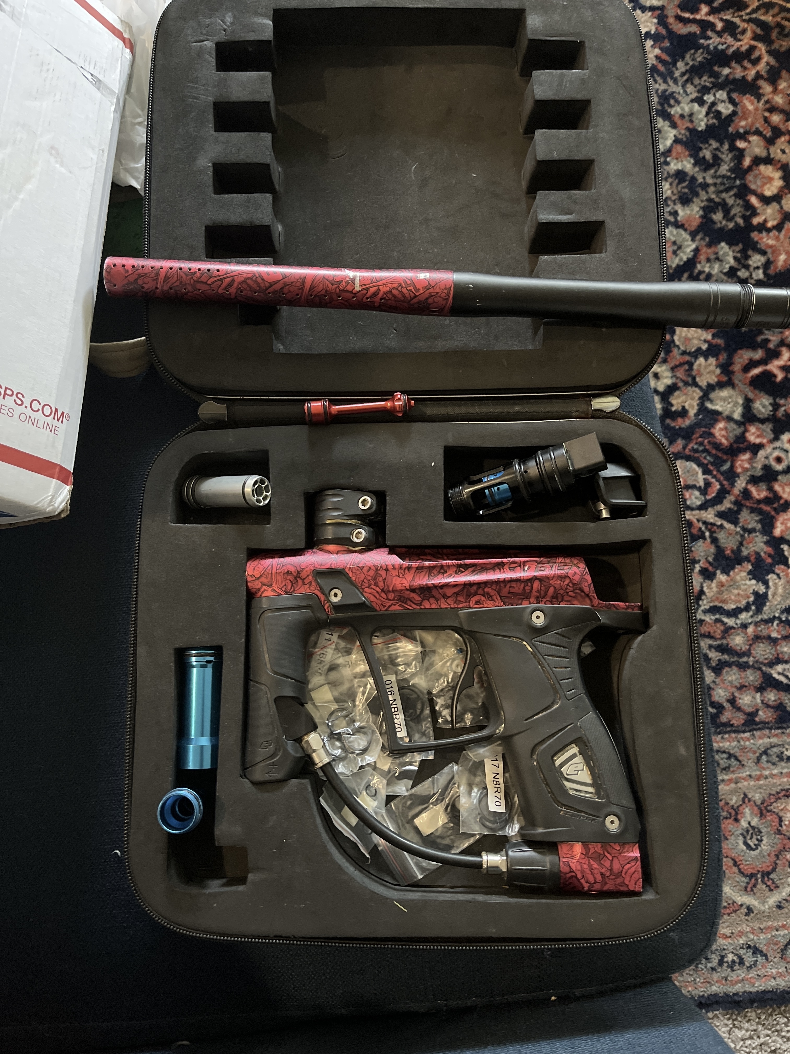

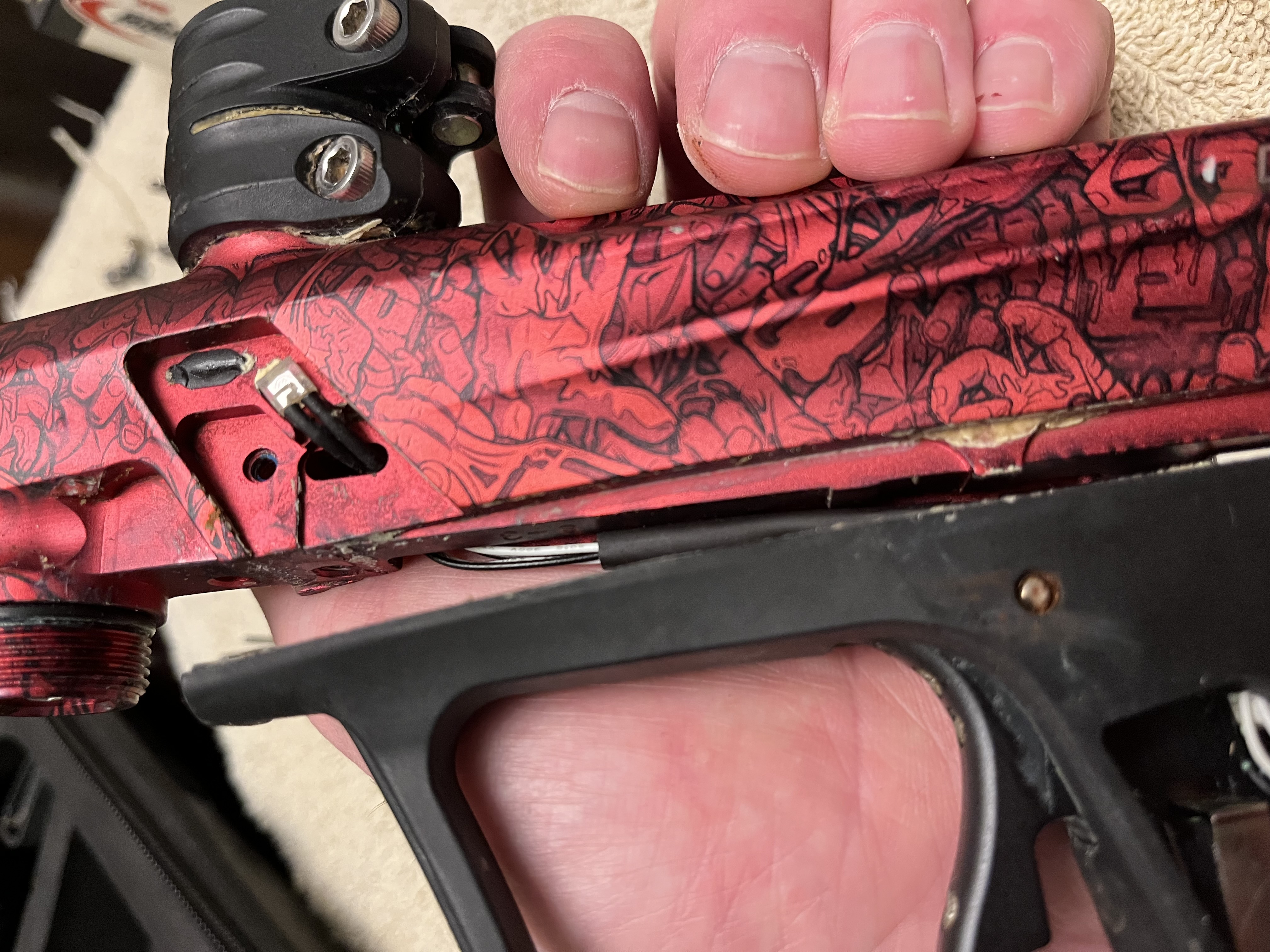

    Got this beat GTEK in the mail. Paint was crusted in every crevice, and parts of the engine were missing or broken, and the barrel was fused together.
    But the price was nice and I wanted a full-time mech anyway. The ano (Stretch Fire - limited run) in this was loads of fun. Too bad the previous owner mauled the barrel front trying to get them to separate.

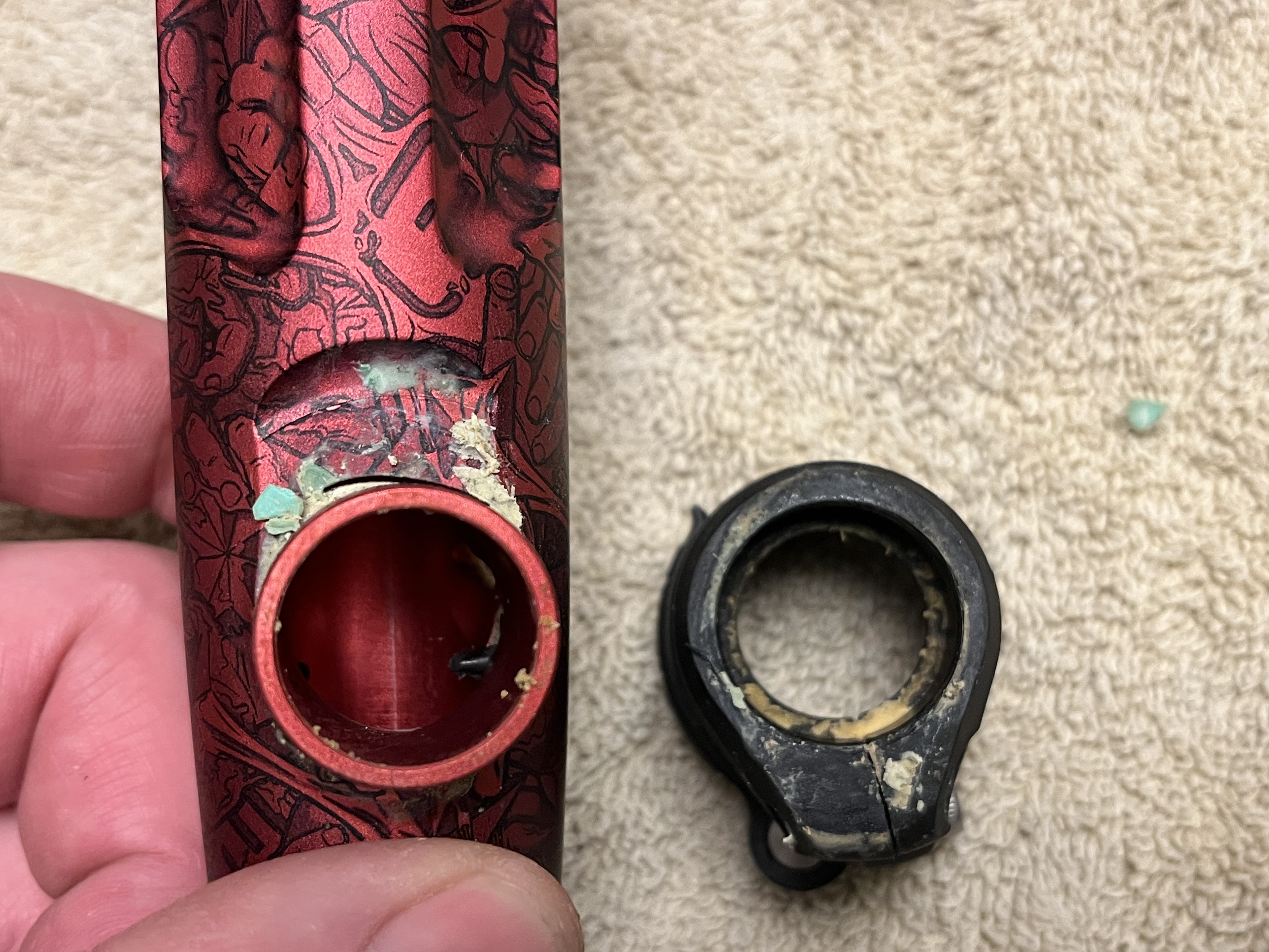

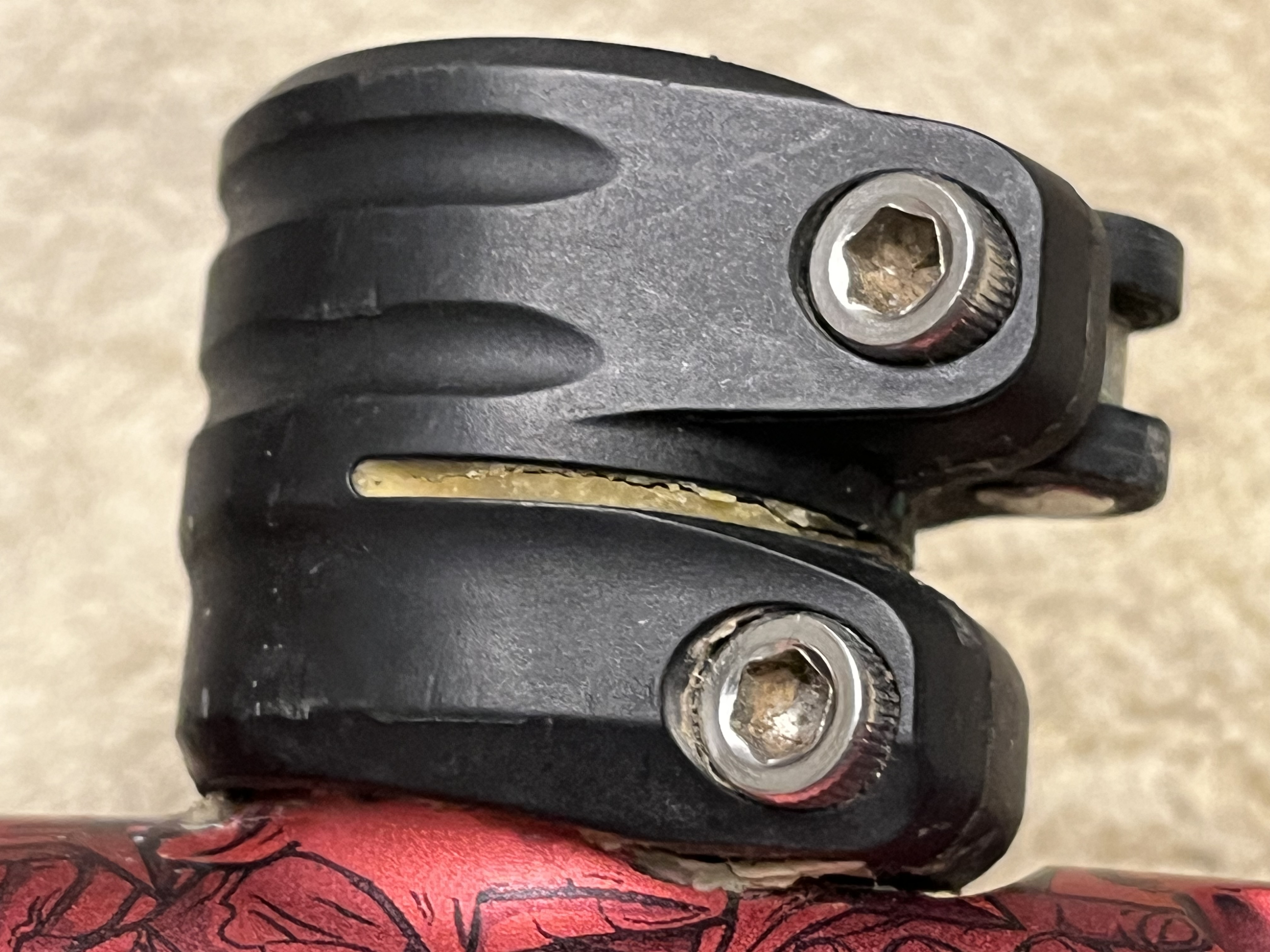

    Separating the barrel halves

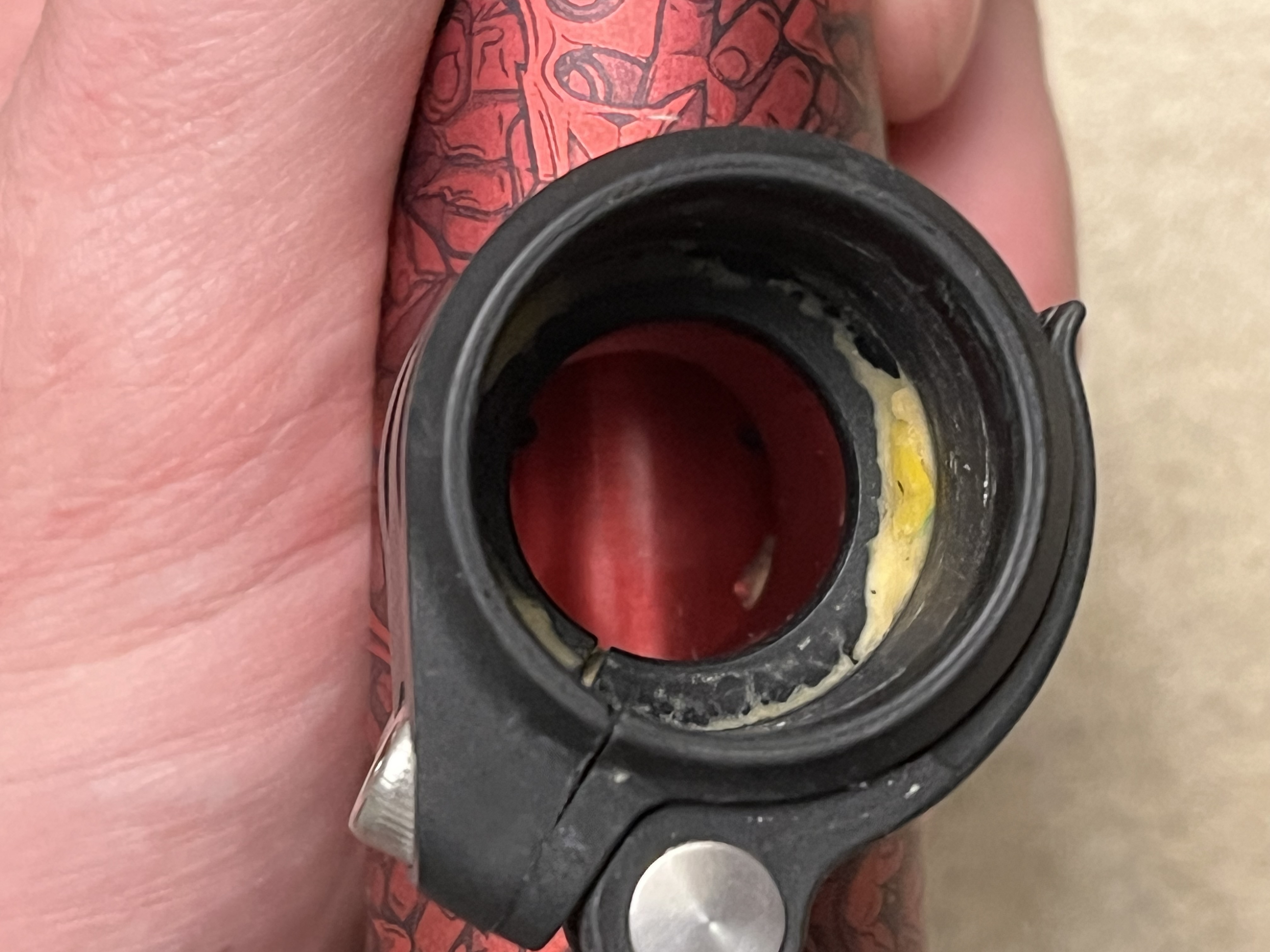

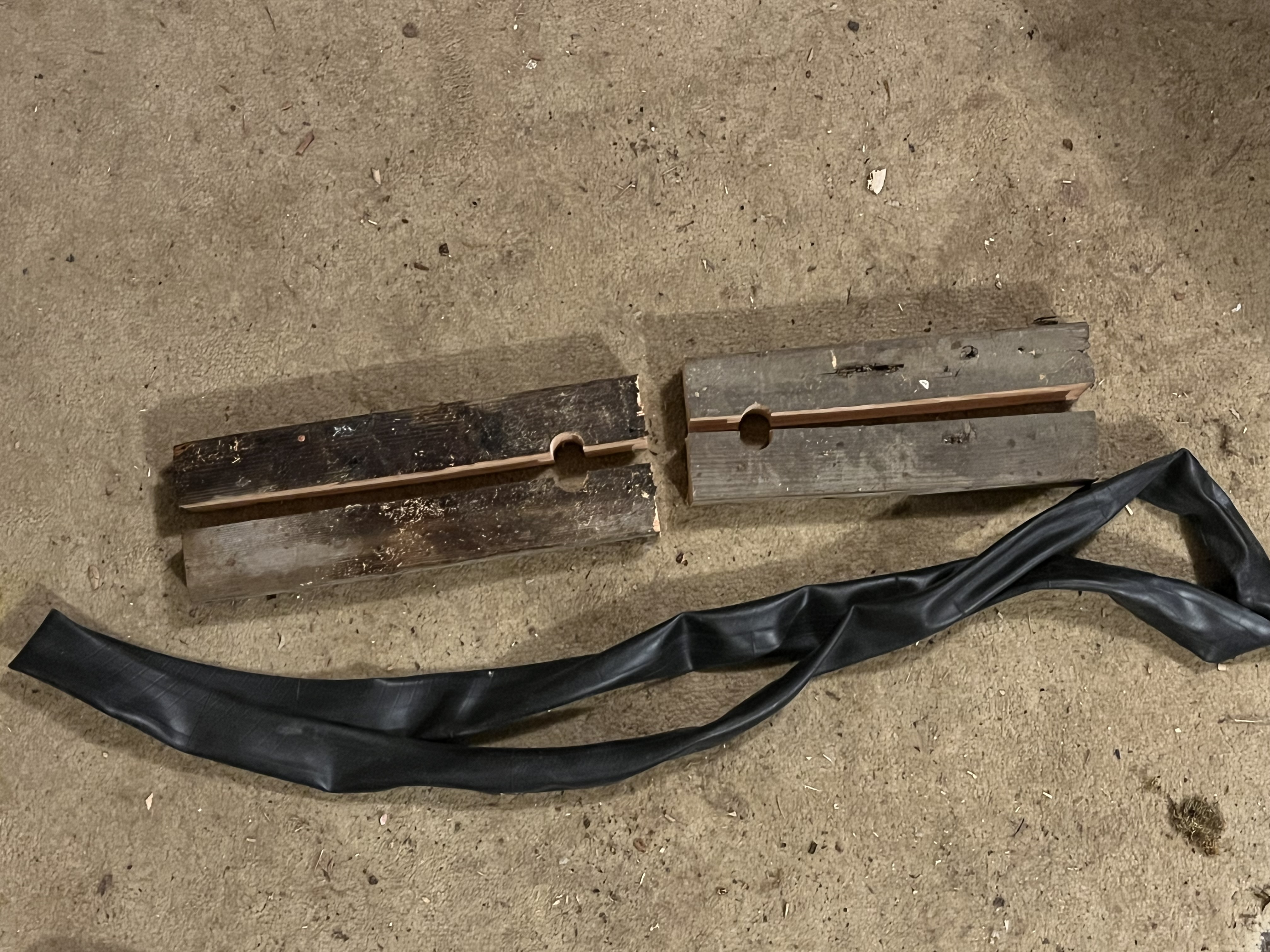

    This was a fun puzzle. I tried:
    1. a heat gun
    2. the freezer
    3. two strap wrenches
    4. penetrating oil

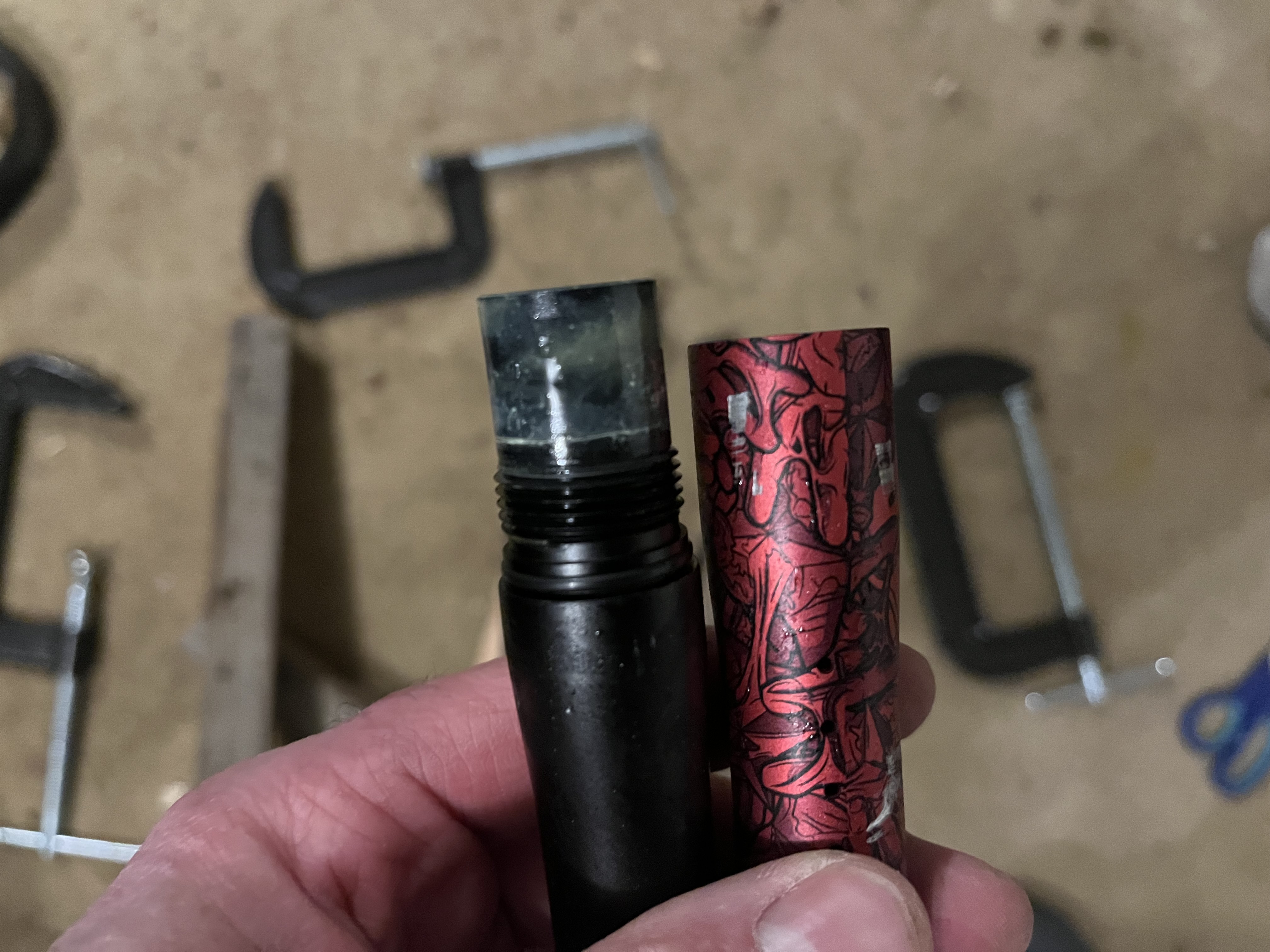

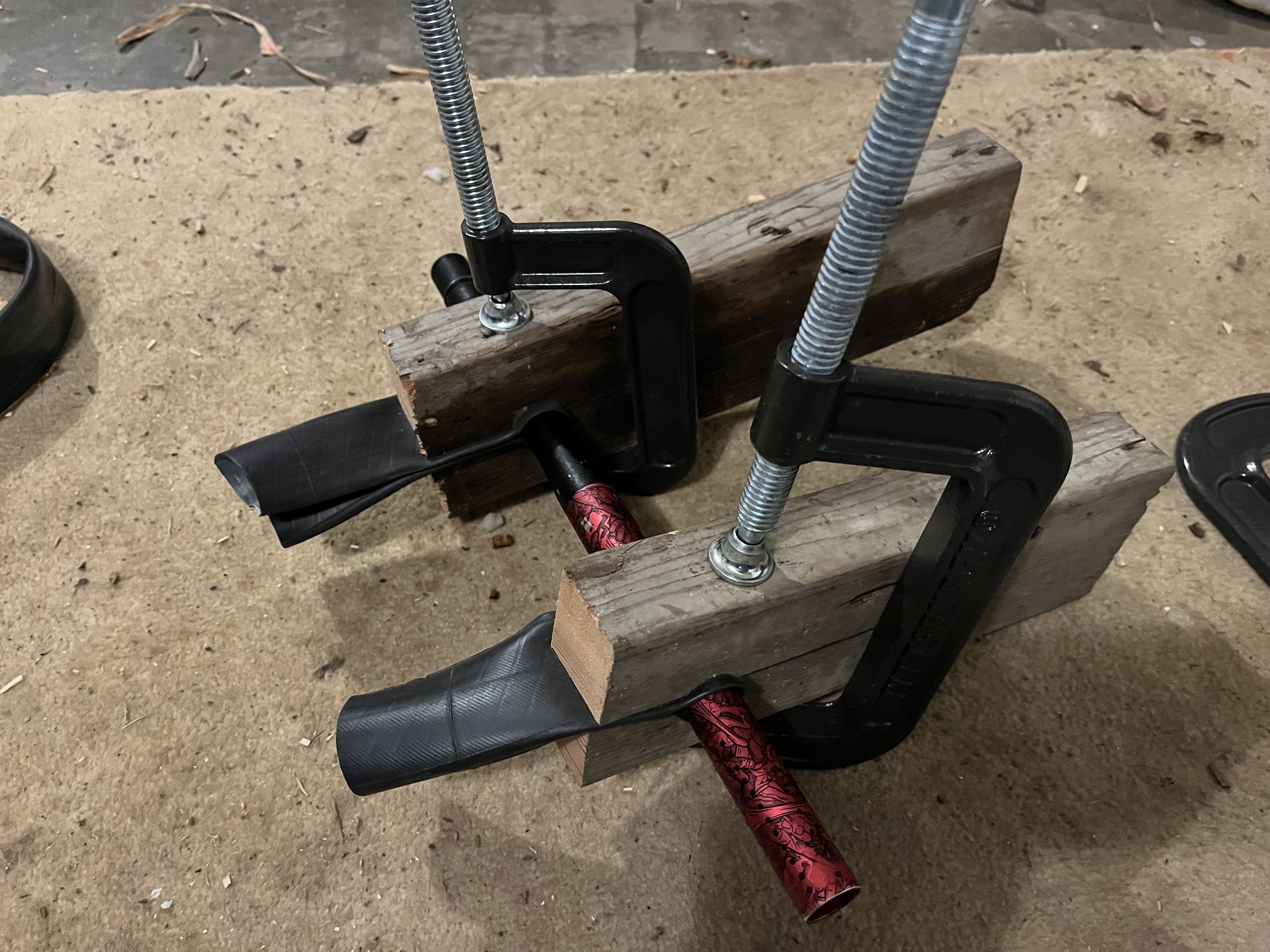

    but couldn’t get the barrel pieces to separate. I finally broke down and built the tooling to get this done. Used an old 2x4, a 7/8” spade bit & drill, a circular saw, an old bike tube, and C-clamps to build grippy non-marring barrel separators. The narrow parts of the barrel halves were 13/16” or so wide, so I chose to drill 7/8” holes to give the bike tube some room. Worked pretty well! Slow pressure didn’t do it, so I tried a quick twist and the threads screeched, allowing me to untwist them.

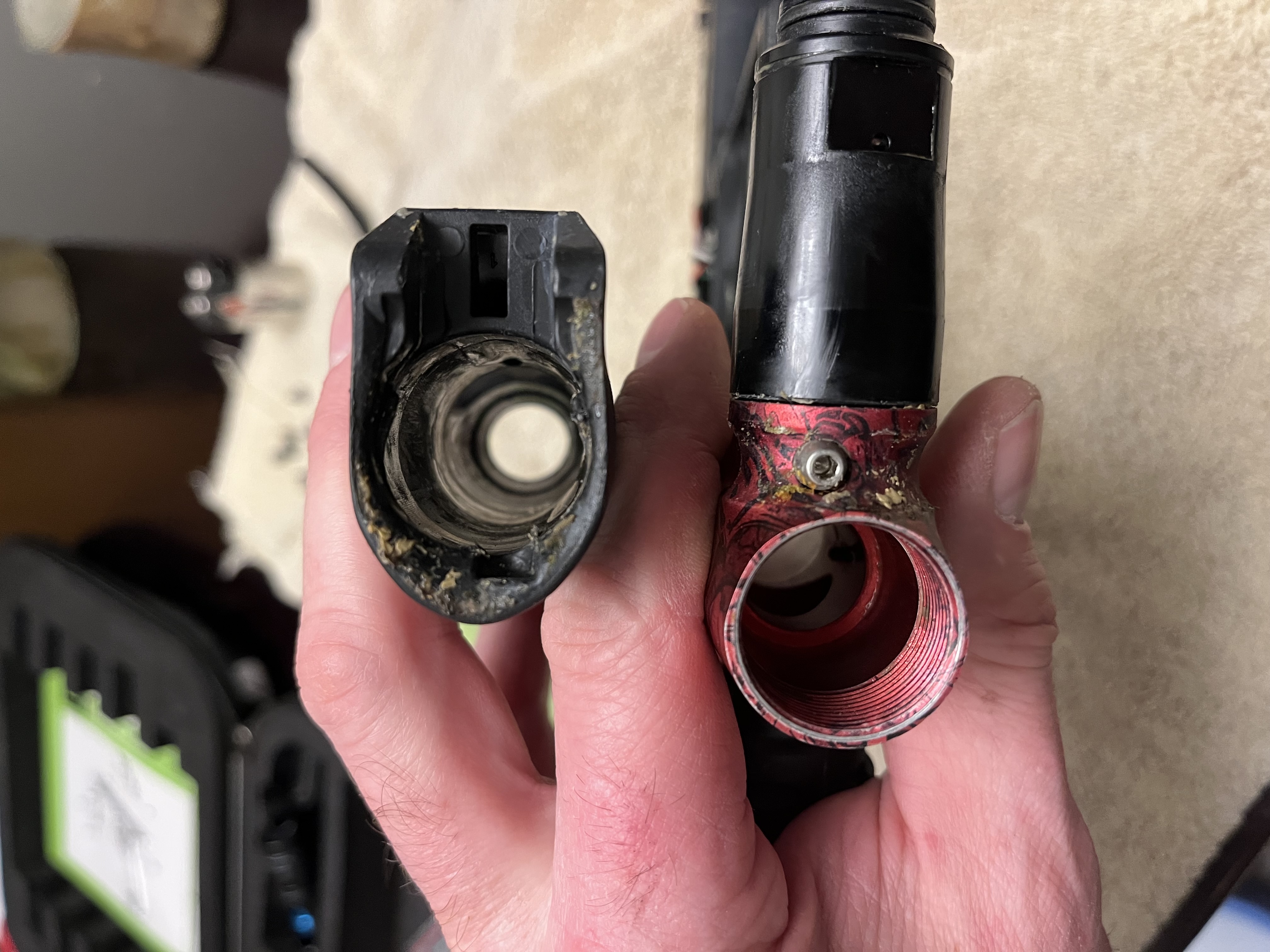

    Someone just didn’t think cleaning his gear was worthwhile… the marks in the pictures indicate that when the barrel stuck together they tried wrenches to separate the halves. The paint in the barrel dried out & acted like loctite.

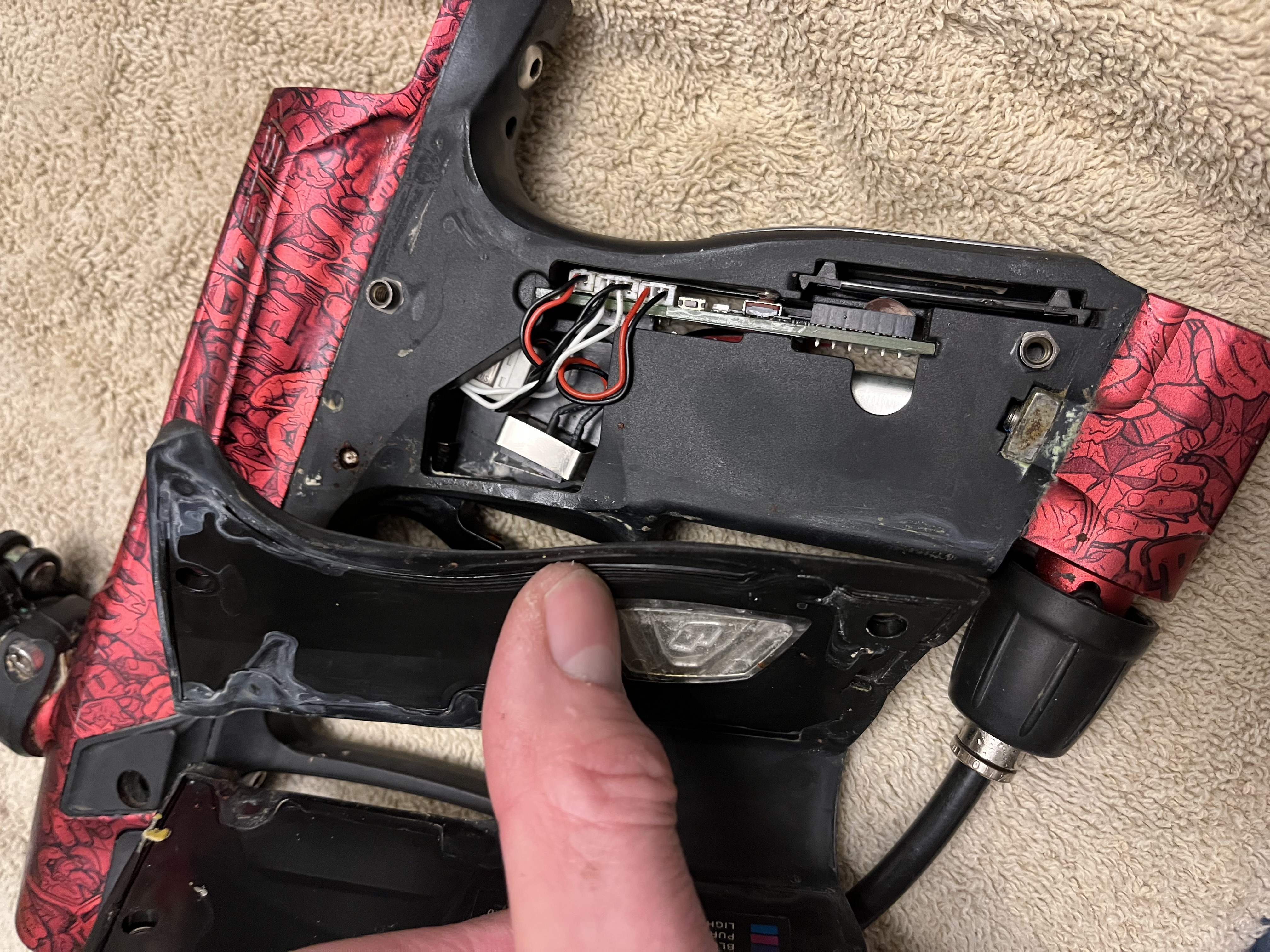

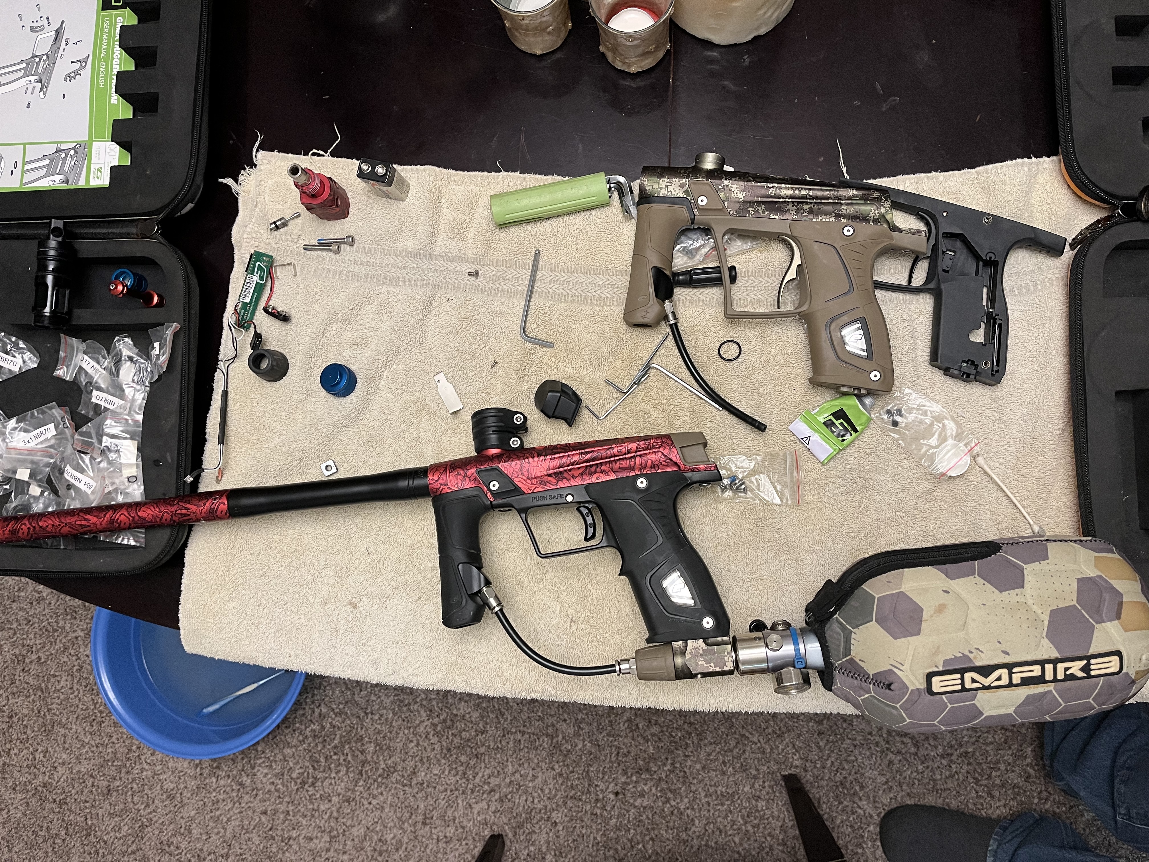

      Cleaning & testing

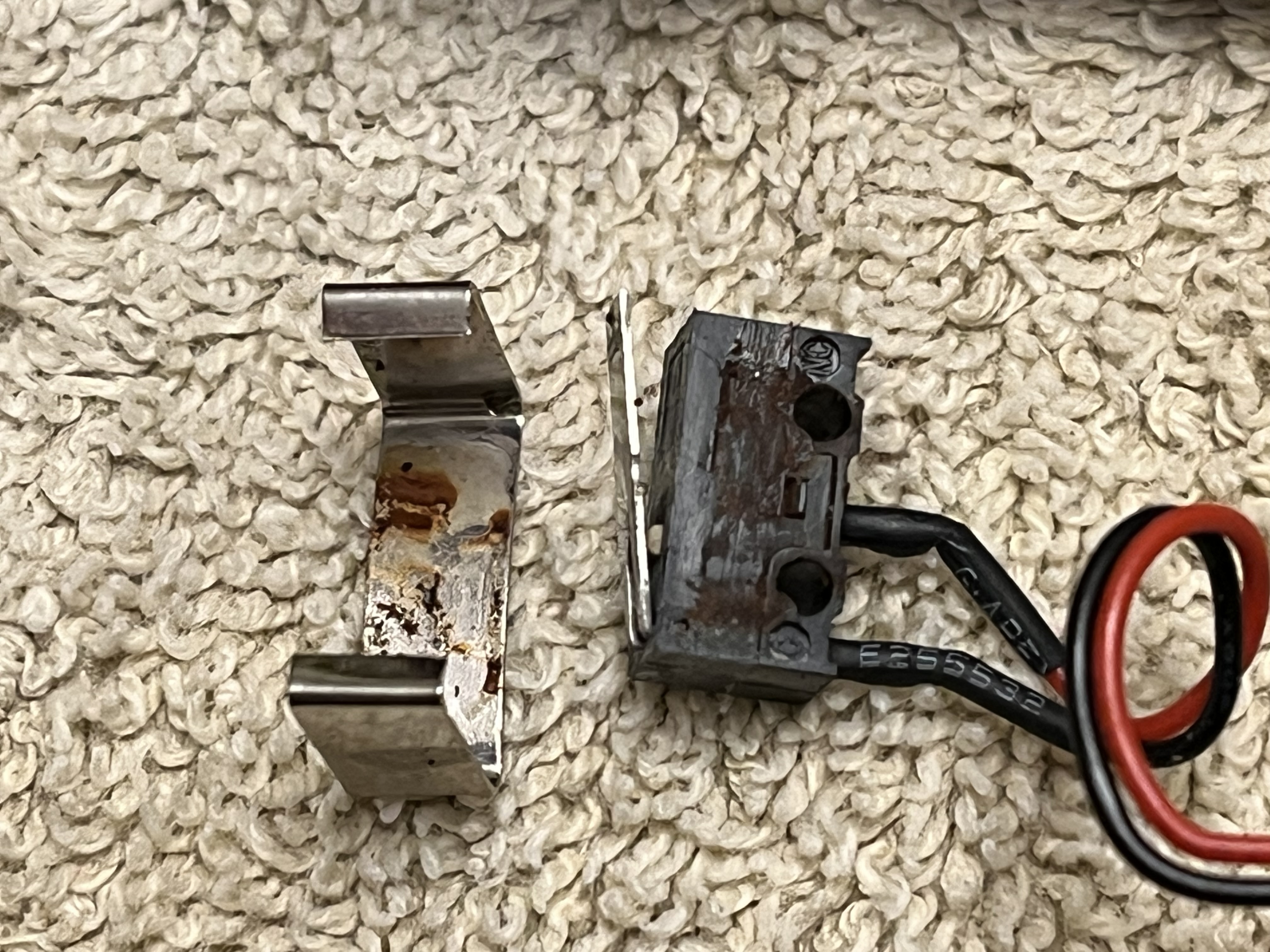

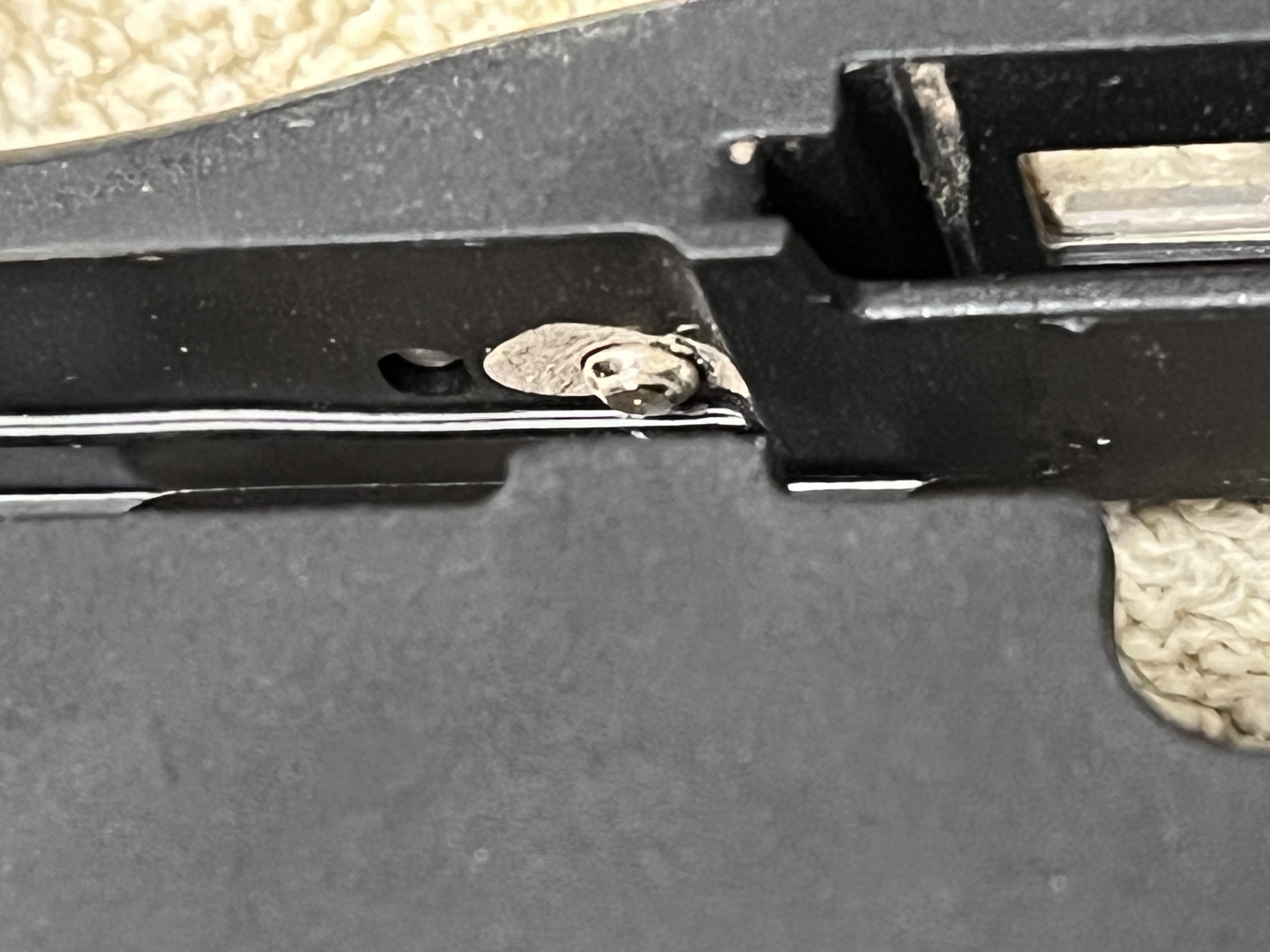

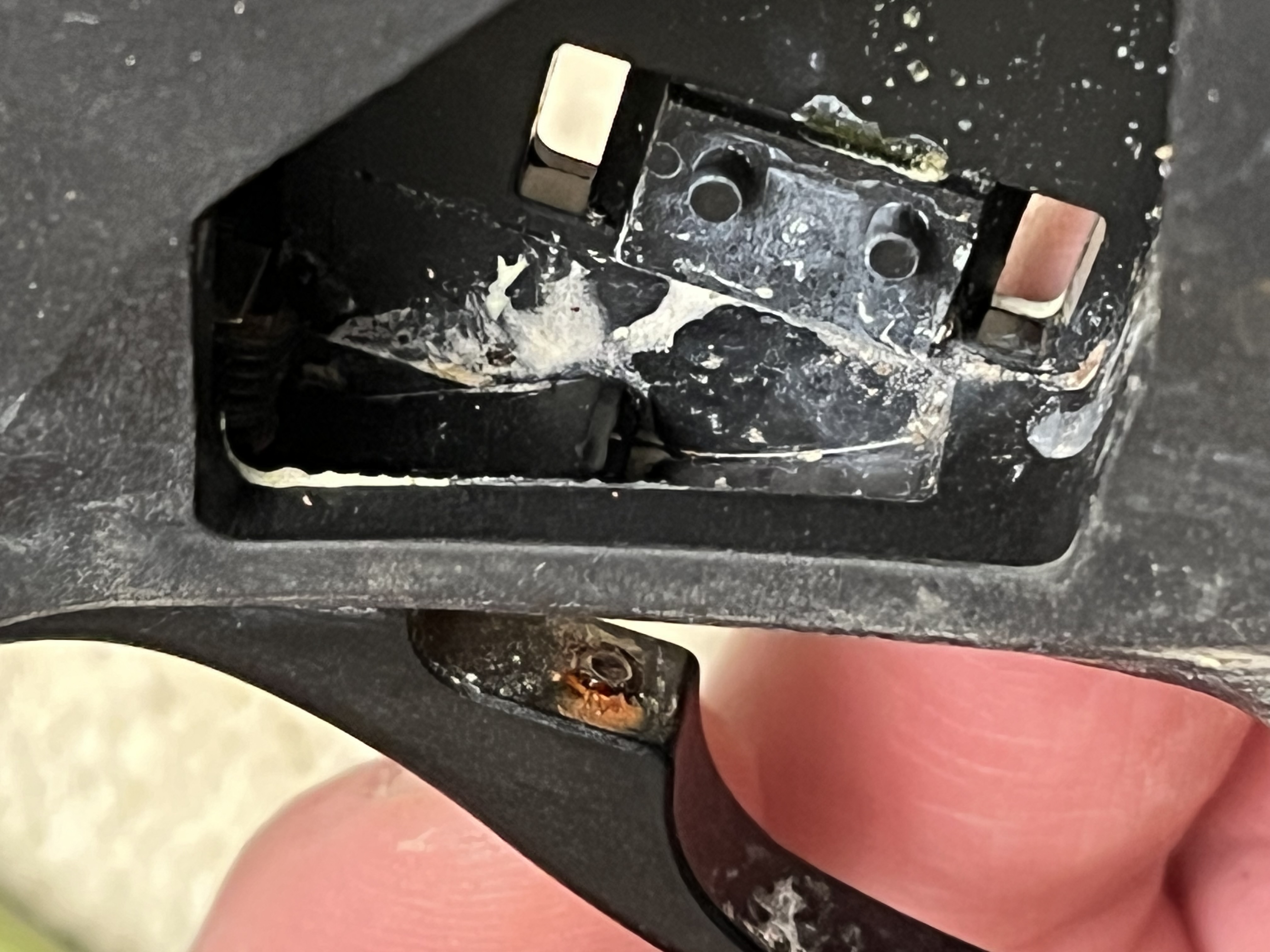

      What. A. Mess. There was paint and mud in the inside of the electronics button. The detents had sat in paint long enough they turned to black goo as I removed them. I was surprised the board, eyes, and solenoid all worked. Thankfully the reg was easy to disassemble and didn’t require a wrench - a few new seals and a reg seat and it was ready to go.
      Slapped the core (and OOPS) from my other GTEK in to do testing (red OOPS was drying from a deep clean still) and aired it up. No leaks! Shot great, and it looks good with the black mech frame I had.

            Seems like previous owner didn't know about reverse threaded barrel and ruined it
            • lhamilton1807
              lhamilton1807 commented
              Yes, the marks on the barrel indicate they tried to get it separated with some hard surface or wrench. It was just paint inside the barrel threads, just like everywhere else. All they had to do was take care of their stuff and it would have saved the ano. It could have been that they just tightened the pieces together, but I think the dried paint also served as loctite.
              The threads and barrel bore are fine so it’ll still function. I’ll be on the lookout for a new tip - would be cool to have this looking nice again.

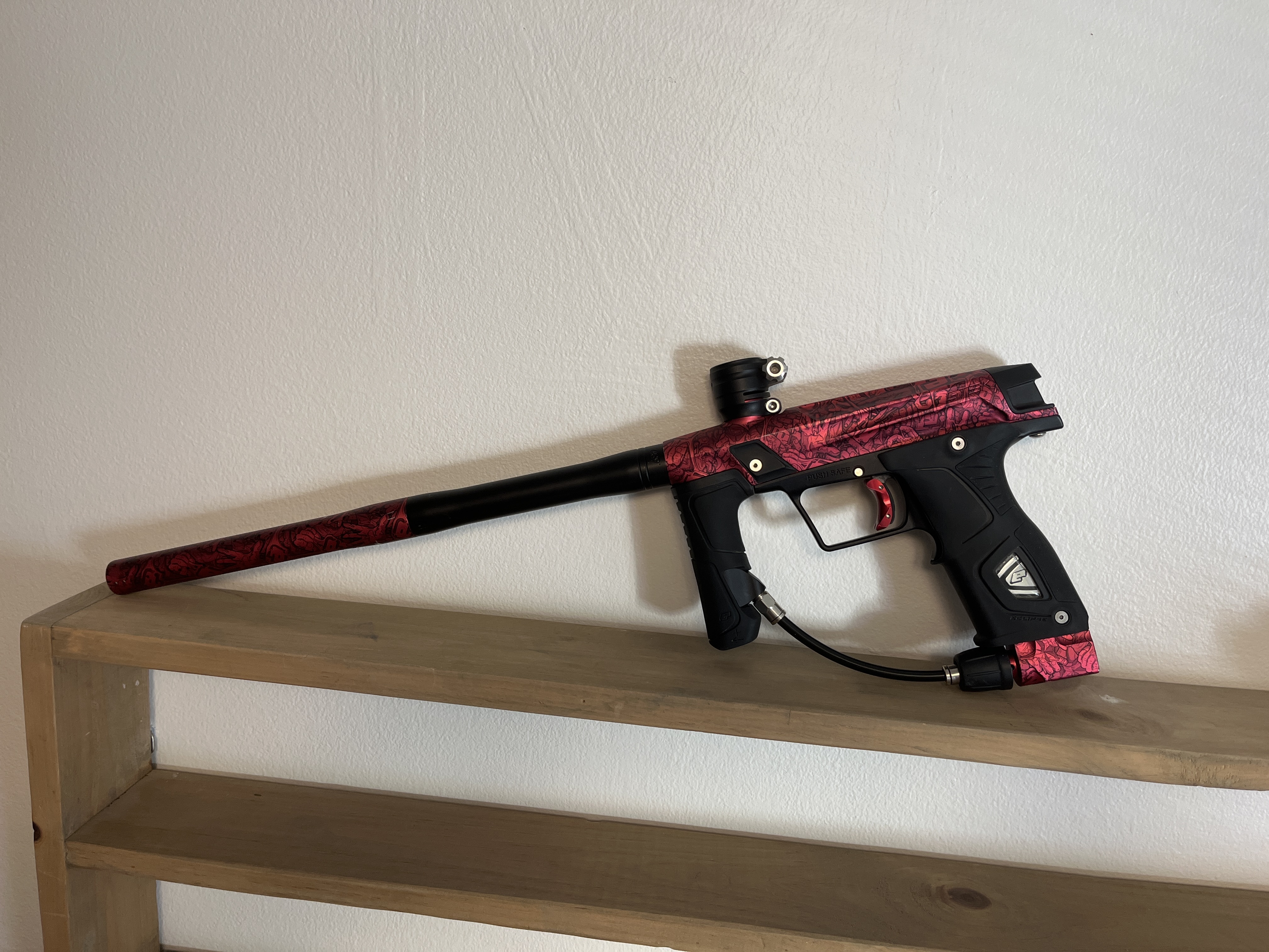

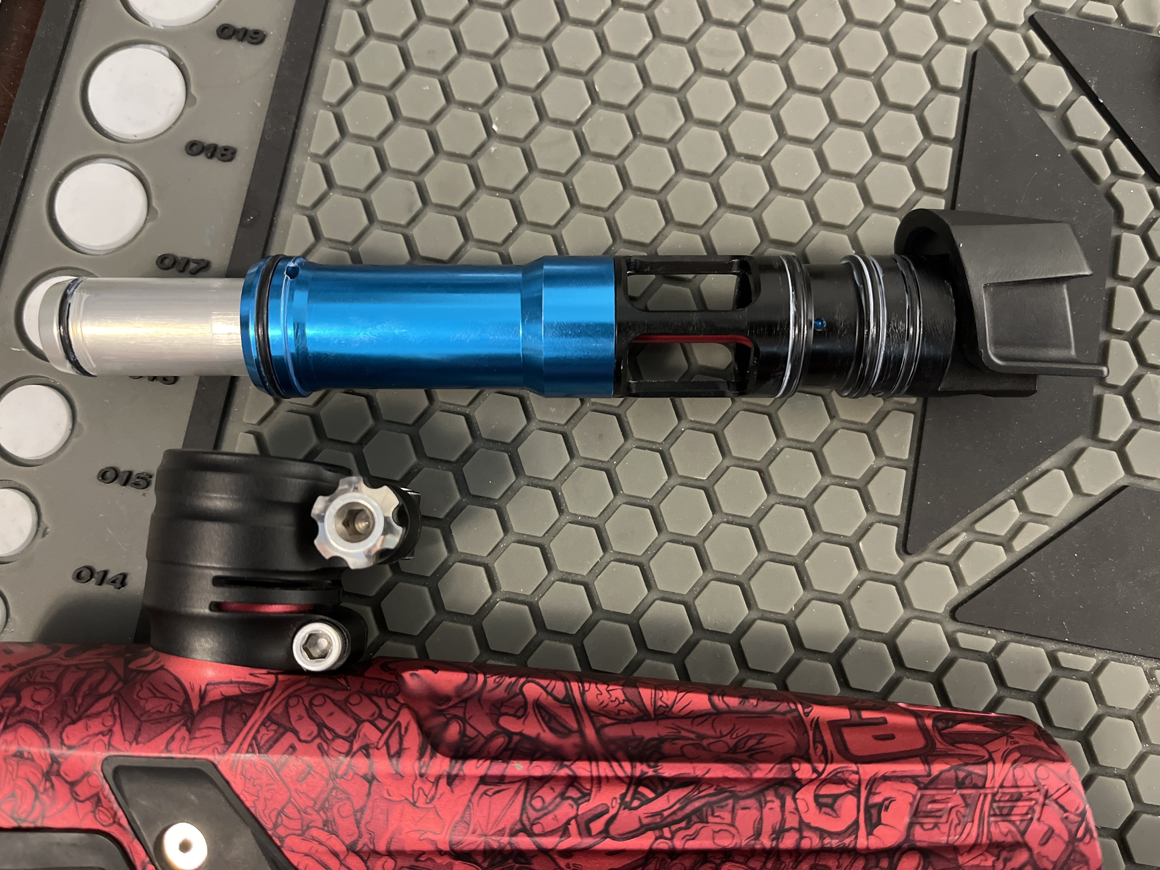

            Resurrection
            Click image for larger version  Name:	image.jpg Views:	9 Size:	3.39 MB ID:	654157

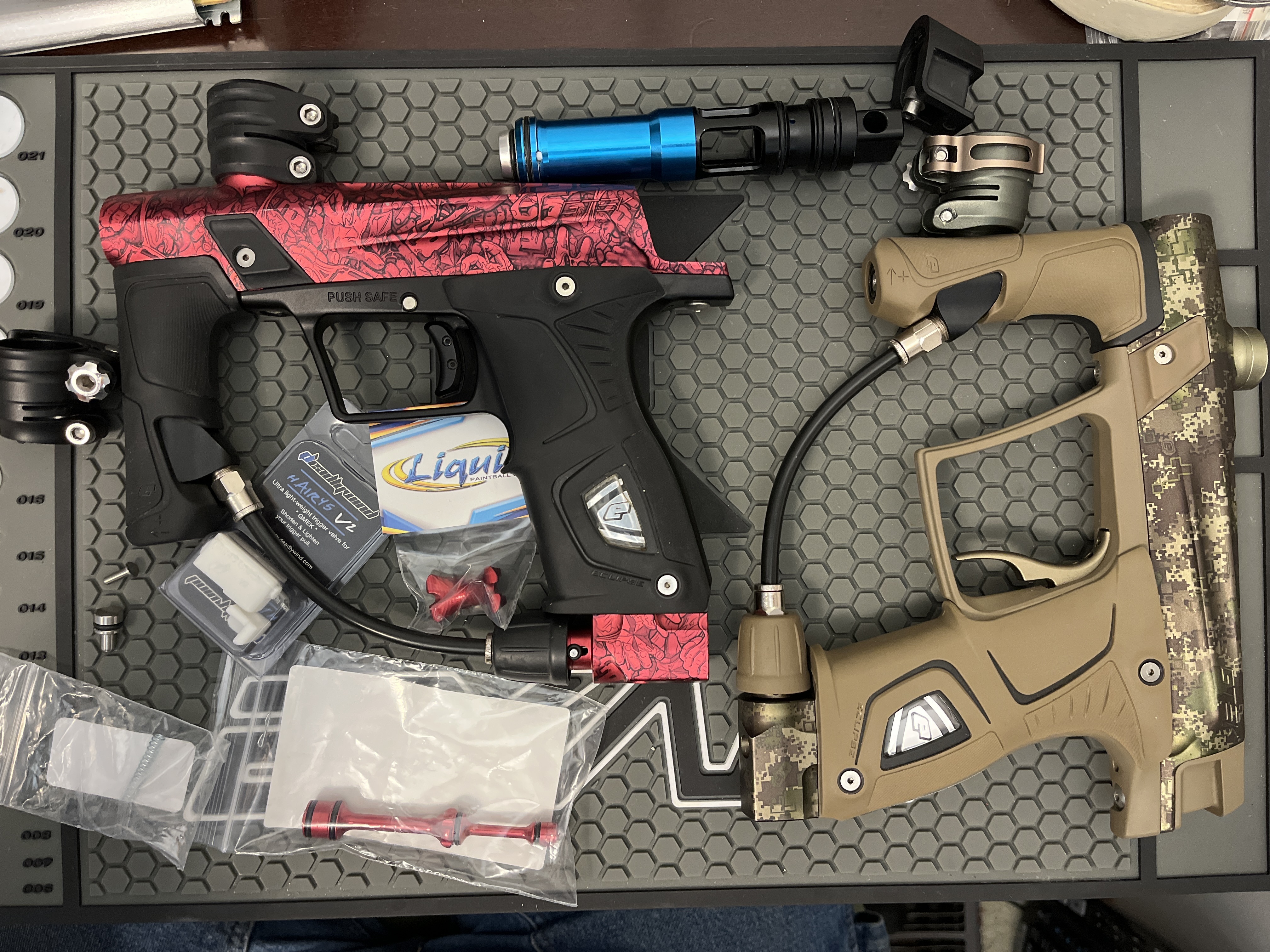

            They’ve arrived! Time to get this put together and tuned.
            • New green/brown feed neck will go on my HDE Earth Gtek
            • black aluminum feed neck will move from the Earth Gtek to the gmek
            • composite feedneck will be for spares or another future build
            • Bits for getting the Gamma Core running and making the trigger pull light and fast

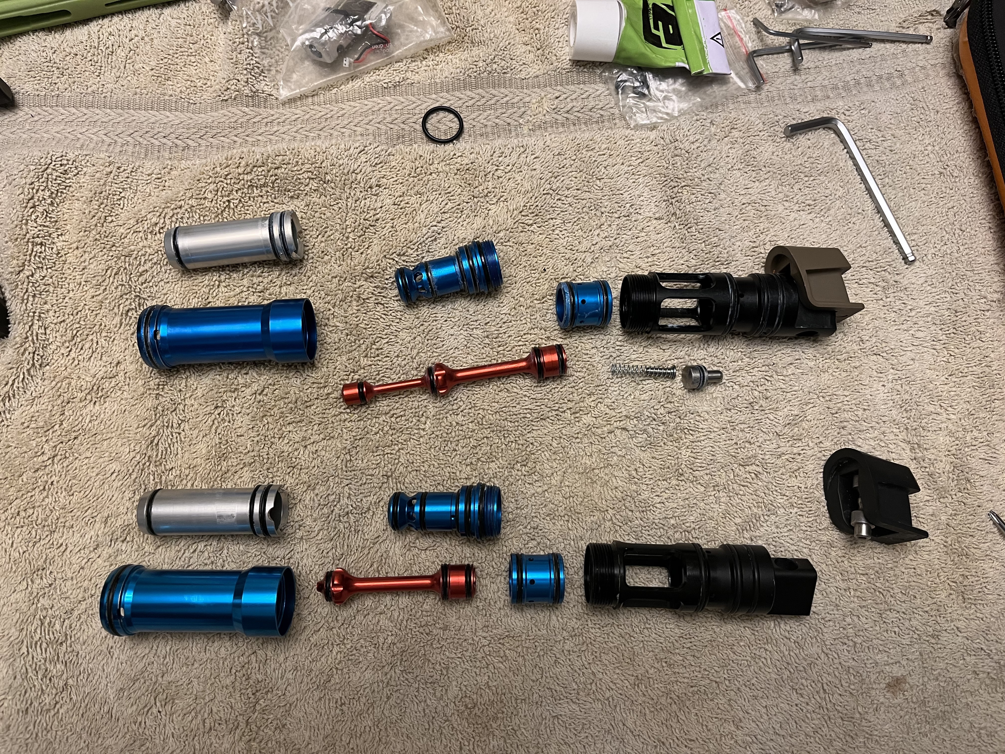

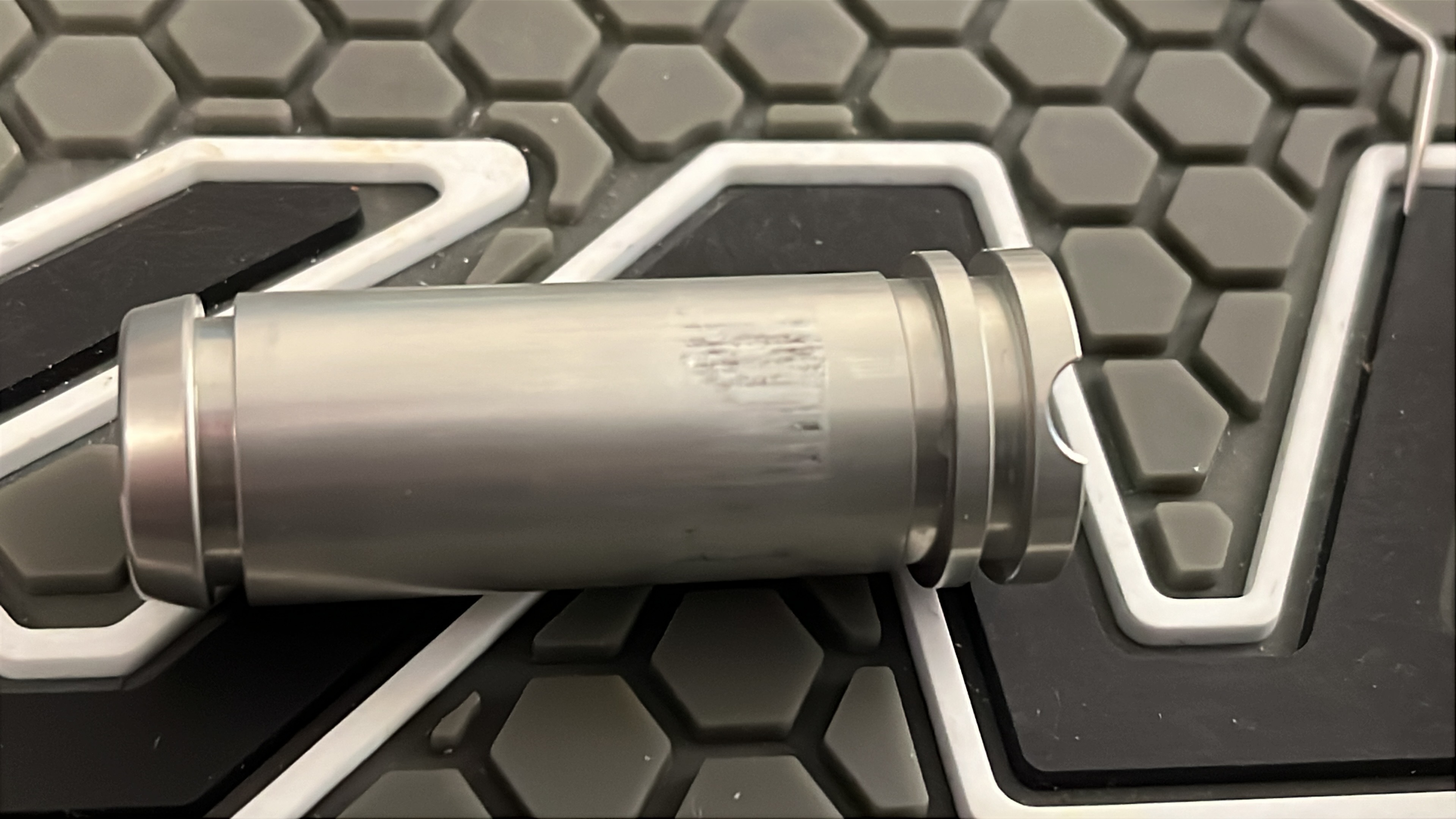

            The Bolt has some wear, likely from cycling with a broken spool. It feels smooth enough - I’ll give it a try. Did a complete seal rebuild of the entire gamma core just because I don’t trust what the previous owner may have done to the innards.
            Click image for larger version  Name:	90ED836D-2B82-4805-B28D-64FCB720882A.jpg Views:	4 Size:	903.6 KB ID:	654176 Click image for larger version  Name:	image.jpg Views:	3 Size:	3.03 MB ID:	654179
            And it’s ripping! The DW valve makes such a difference in both the pull distance and weight. Wow, this thing is just so much faster!
            I’ll have to wait on the Bone GTR install - the adapter for the GMEK trigger plate is coming separately. Updates to follow.

              The DW valve is very walkable with the Bone GTR trigger shoe. It’s so much lighter than the stock valve.
              The wear in the bolt hasn’t been an issue. The worn spots are smooth so I don’t anticipate any problems as long as I keep the bolt engine clean.
              Unfortunately the hair valve started leaking and wouldn’t cycle the bolt so I have the stock valve in again. I would not suggest the GTR trigger shoe unless you get the DW valve - it’s only eye candy right now since the force required to pull activate the pin is too high to just tap out a high rof.
              I’ve contacted DW for support. Still a fun shooter.

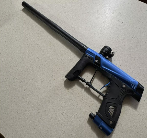

                • PBGunny
                  Seasoned Shooter
                  • 166
                  • Northern IN
                  Two years ago, I picked up a Flecktarn Gtek along with a black mech frame as a loaner/ beater marker for myself.
                  I spent most of the summer working on it switching it back and forth, installing a OLED board and adding the soft bolt and putting a Hair trigger in the mech.
                  It shot really well both ways, but I made the mistake of letting a friend of a teammate borrow it for a big game in the fall.
                  Cash came out and away it went.
                  I ended up getting a HK 170R and I have been playing quite a bit with it.
                  Last fall, another friend brought along his step-son to a game, his first one.
                  The kid has been having problems in school paying attention, finishing his homework and being disrespectful.
                  Well, he played and we worked with him all day and he ended up getting a trophy at the end of the day for finishing a "Young Guns" mission.
                  Things have changed since then, he is getting better grades and he is behaving much better.
                  I can't let that go by without a reward...
                  His favorite color is blue.
                  • lhamilton1807
                    Looks great! Thanks for investing in this young man. I have seen these converted with the Gmek frames as well just in case he wants one down the road.
