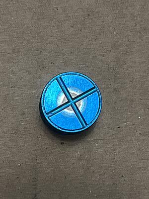

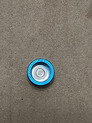

          Problem solved! I put the core from my other GTEK in and everything worked fine. From front to back, I swapped a part from the red GTEK in until the leak happened and found out the switch - the blue cup waaaaay at the back of the core - was leaking. New orings changed nothing, and it causes a leak in both markers. Will have to replace it.

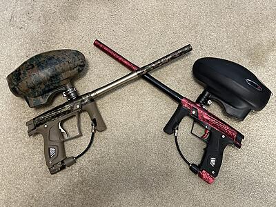

            New gamma core switch came in today so these two are ready to roll. Also got a vmax+ and swapped the internals with the camo vmax so the GTEK has the faster loader.
            The old switch in the pictures was also a victim of the previous owner’s abuse - the ano wear is really apparent, and is heavier on one side. Amazing to think the tolerances are so tight that some uneven ano wear would cause this piece to fail. PE says the red spool was getting stuck in it. I couldn’t find anything obvious (like scratches) that would make it catch but the new switch solved the problem.
