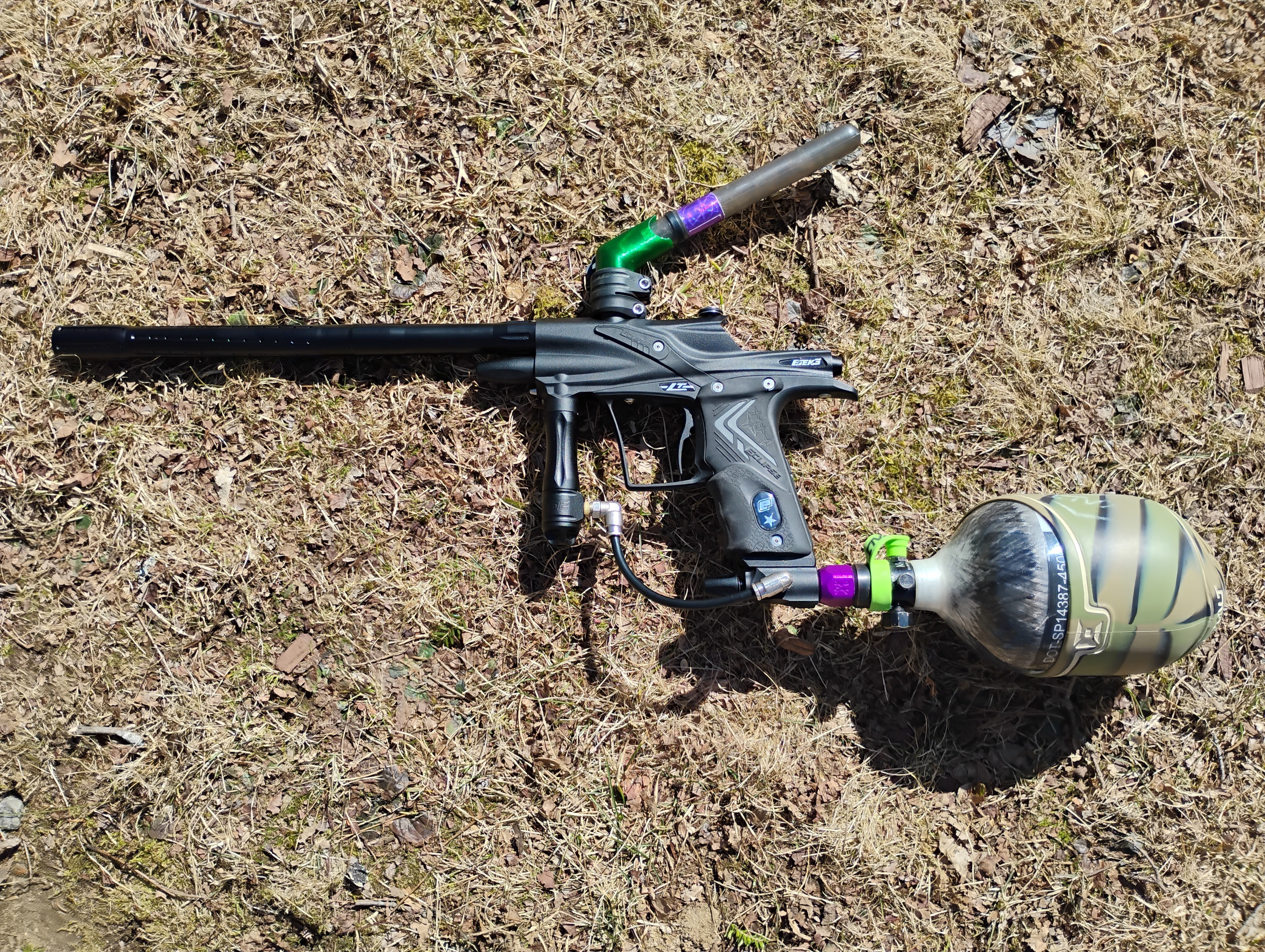

    Hey guys so I got this off Facebook marketplace locally clearly was sitting for some time. Shot it in the backyard seemed to have a lethargic bolt. Did some maintenance put a decent 9v in it. Shot fine no leaks. Then it started to have a slow leak. Broke it down further noticed the lpr reg seat was jelly. Ordered some new ones replaced it now it's leaking worse from the trigger frame. What gives? Not super familiar with poppet Valve guns always wanted one of the egos back in the day. Any help would be appreciated. Basically just been breaking down cleaning/changing o-rings and seals as needed. Greasing reg Orings and oiling bolt/ram orings per manual instructions.
    Any help would be appreciated wanted to get it going for some recball. Cheeky limited paint set up I posted a few weeks ago
