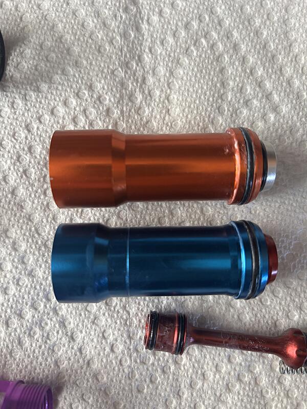

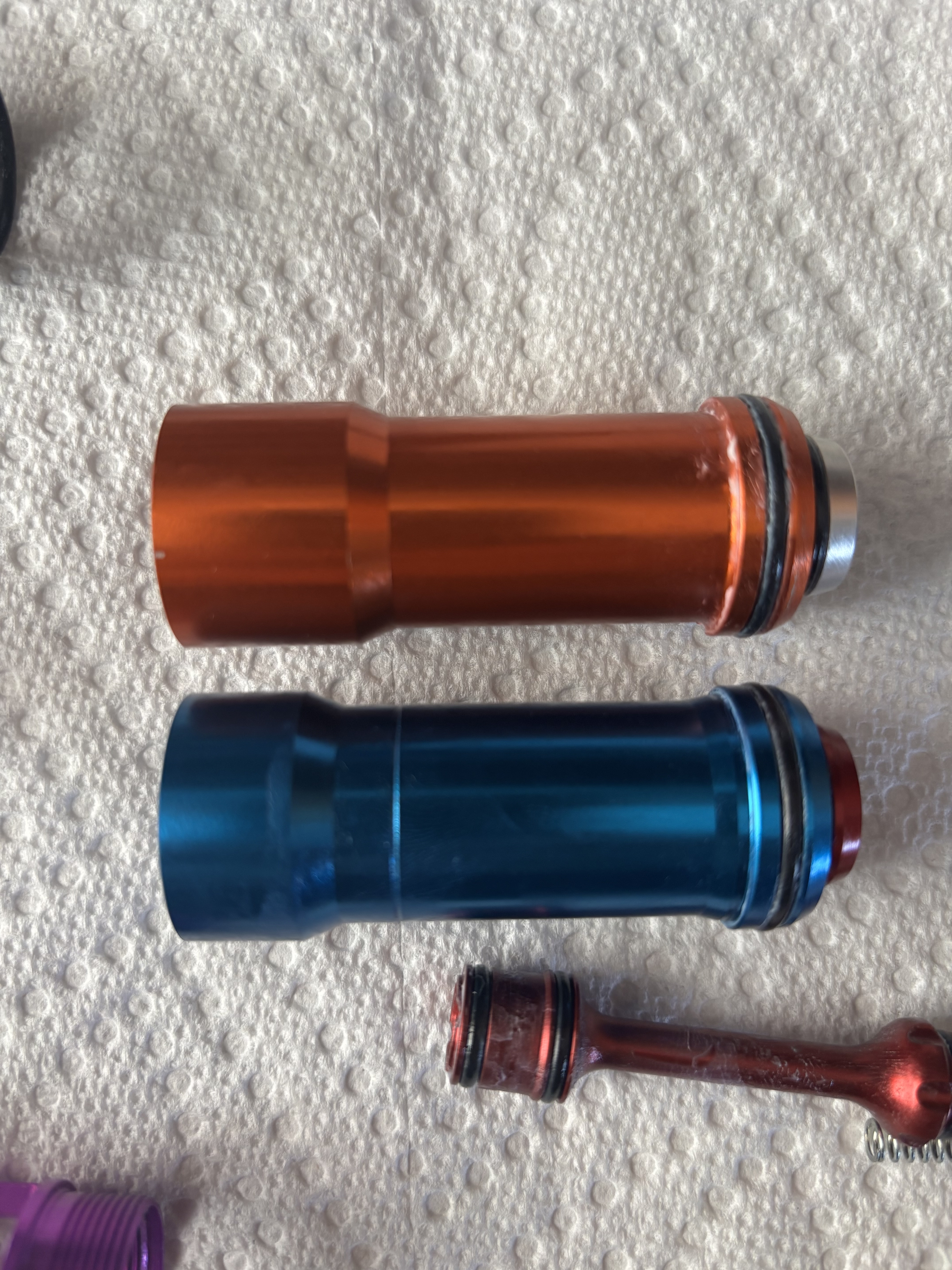

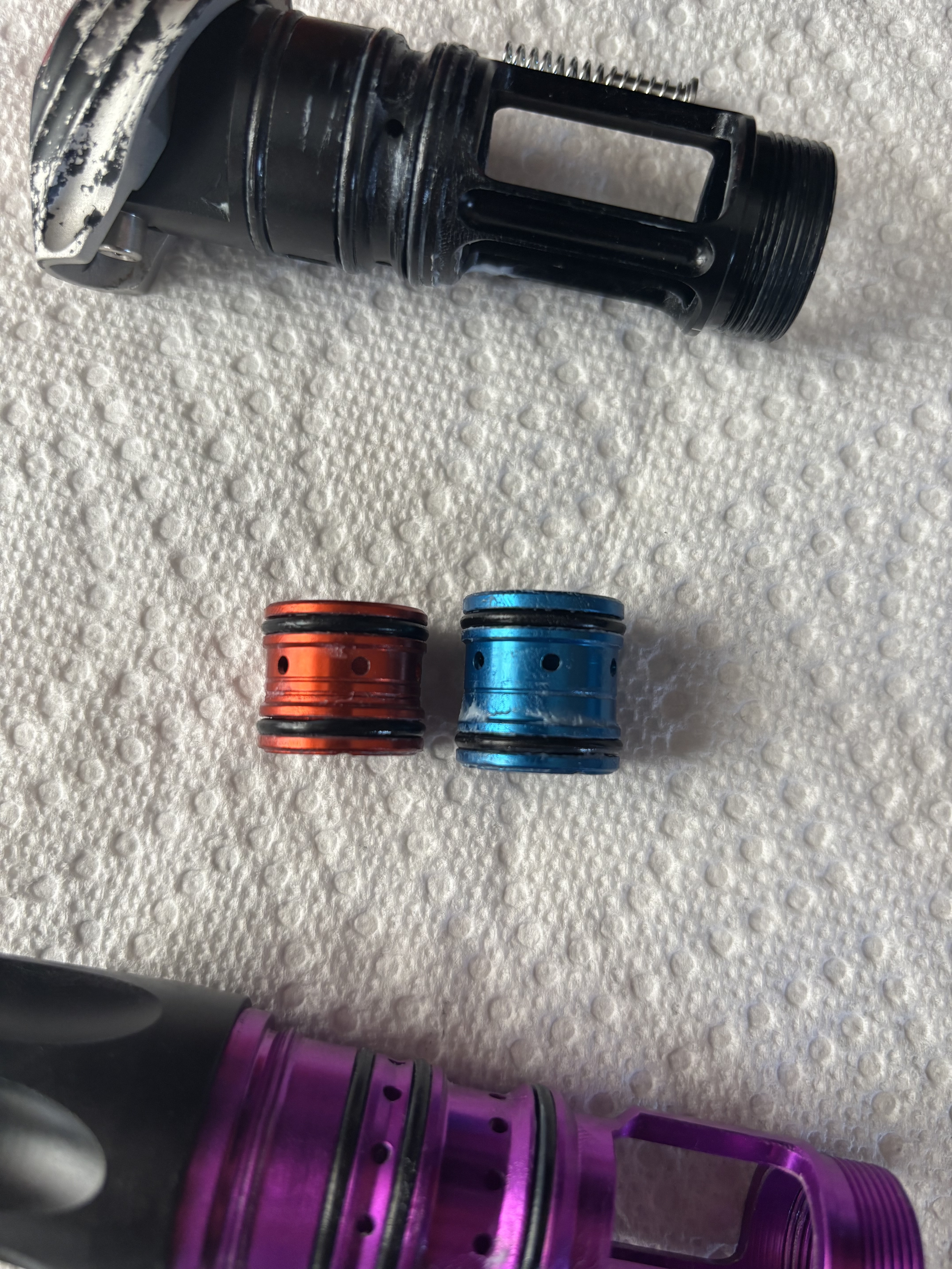

        Yup, that what I ended up doing. I have a CS2 and was like woo! Compatibility lol. Switch is physically smaller by maybe 1cm. Full auto when air is applied. Other part which I tried was the Can. Same dimensions except the dia change where it screws on the Bolt guide. It flares out at a different point. With air, noticeable leak out of the bolt but it will cycle. So my conclusion. Bolt/Spring/spring guide and rear cap plunger/cap hardware are the only cross compatibility in the two systems. Didn’t not completely swap core to the emek/etha/160/170 platform though. Might do that today just to see if it would still work as I believe all those parts are still available to make a compete engine. I unfortunately would have no need to do that as I was/am building off spare bolts and valve chambers.

      • The Hobbit
        The Hobbit commented
        Orange switch and blue bolt for the cs2?
      • Mearleman
        Mearleman commented
        Orange switch and orange can are the cs2 parts
