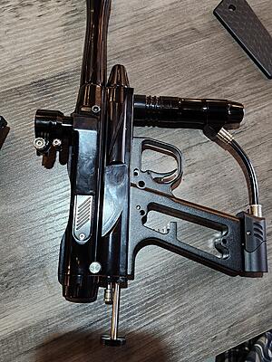

    So the frame spacing is so close to the autococker. I have an ACP single hinge with key slots for mounting. The sear location is the same as the stock frame. Only thing I need is another 1/8" of sear. I wonder if there's a set screw under this sear? Click image for larger version  Name:	17052534758622329960130838429300.jpg Views:	21 Size:	3.35 MB ID:	497450

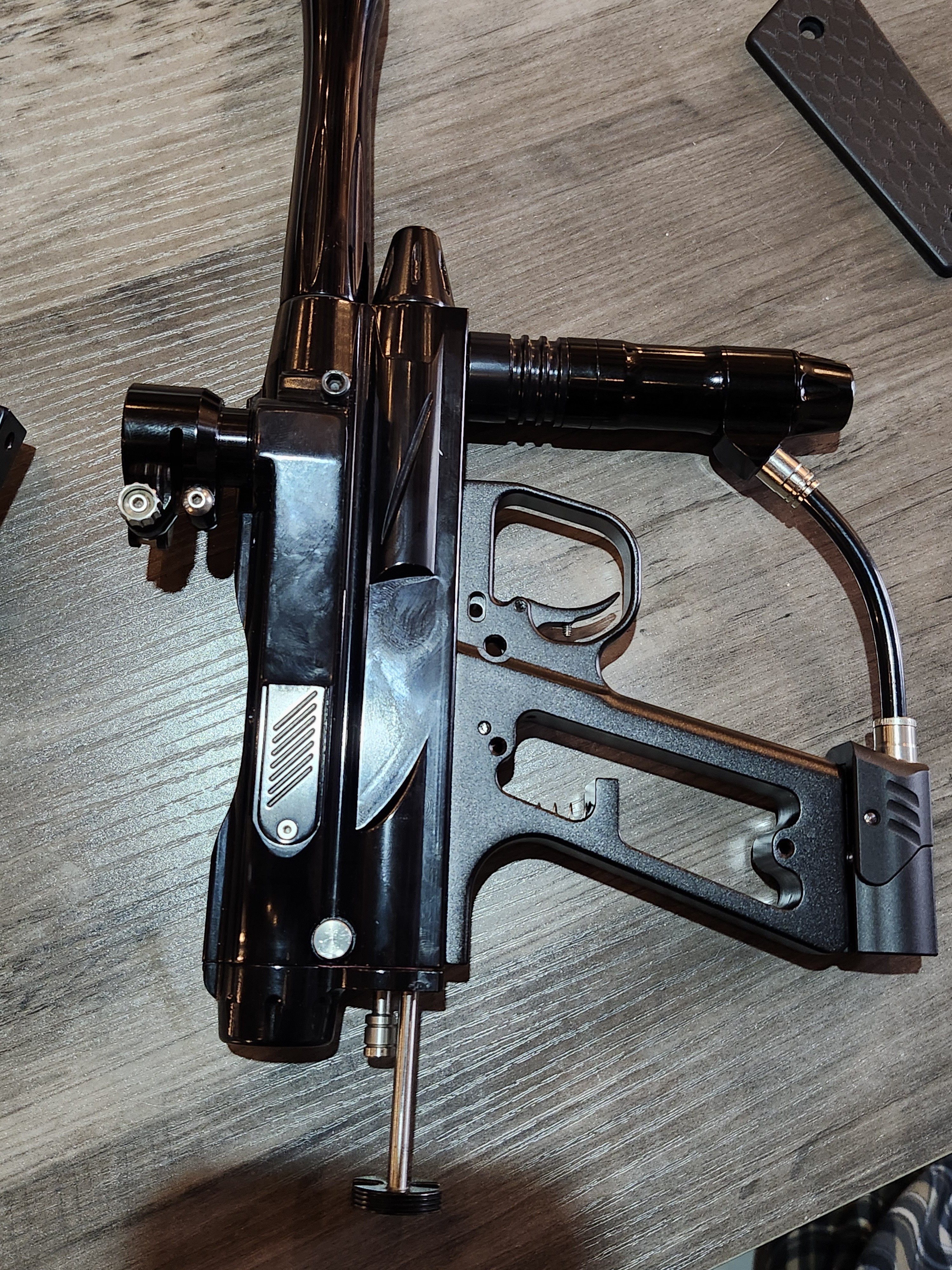

    And yes, that is the Nummech Intimidator length feedneck adapter.....

      cool project

        Thanks! The ID feedneck doesn't quite mate the way I like with this. It is secure however.

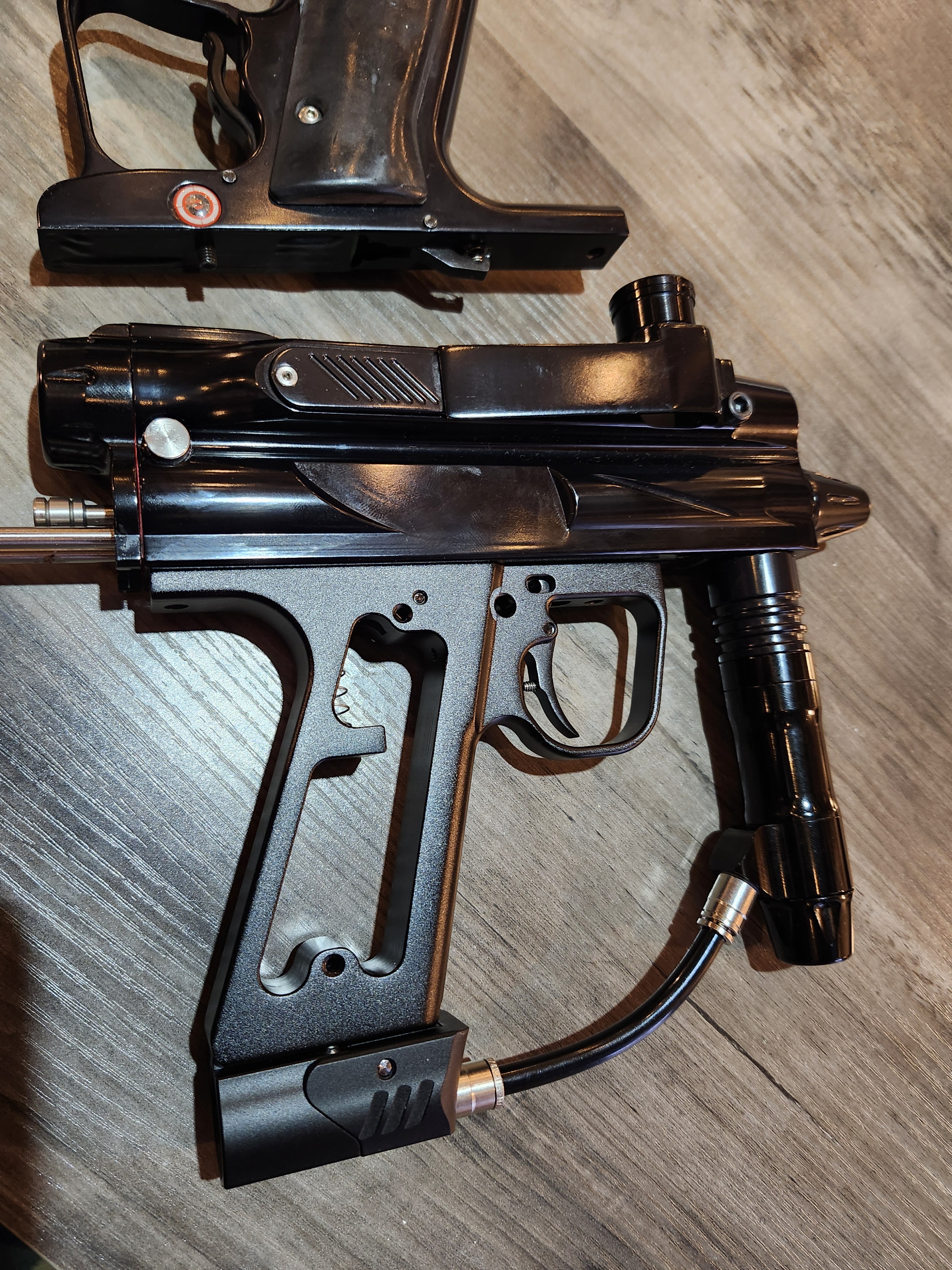

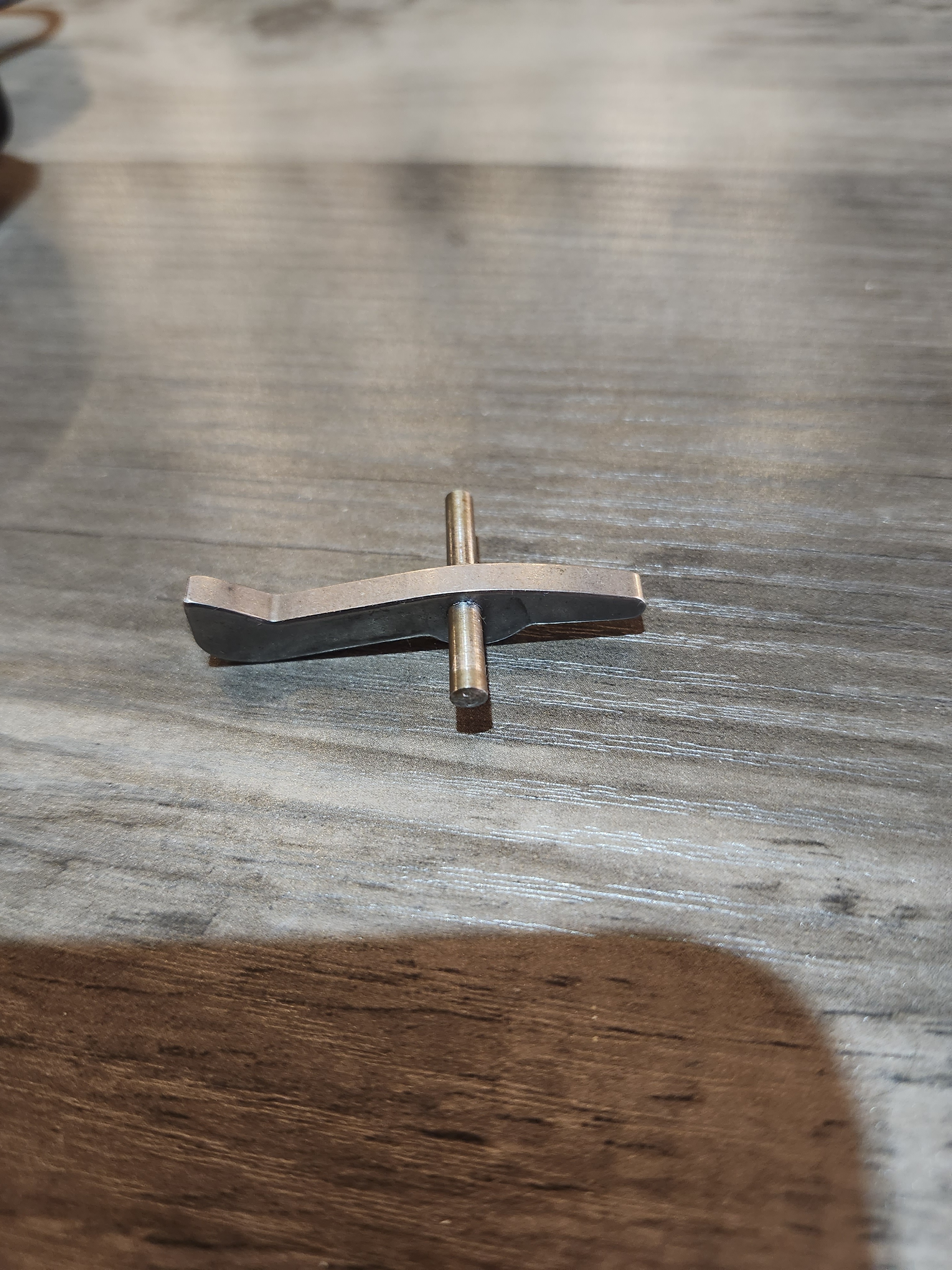

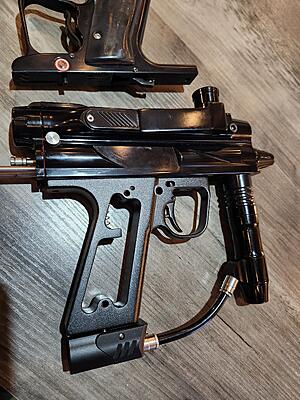

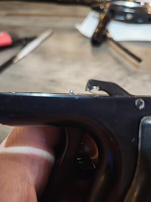

          So much for my editing skills....Anyhow, you'll note the sear height and location is a little off.
          Click image for larger version  Name:	image.png Views:	0 Size:	108.5 KB ID:	497538​My goal, make a new sear. I'll start with a sear I have lying around. I've taken a tapered pin and drove it into the existing pivot hole. Click image for larger version

            • 3508
            How's the sear going to reset? Right now you have a F/A trigger group - the sear will stay down as long as the trigger is held and the hammer will cycle continously until the trigger is released.
            • fierymartel
              fierymartel commented
              Return spring?
            • fierymartel
              I see, the stbb has a slider, right?

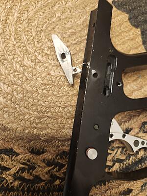

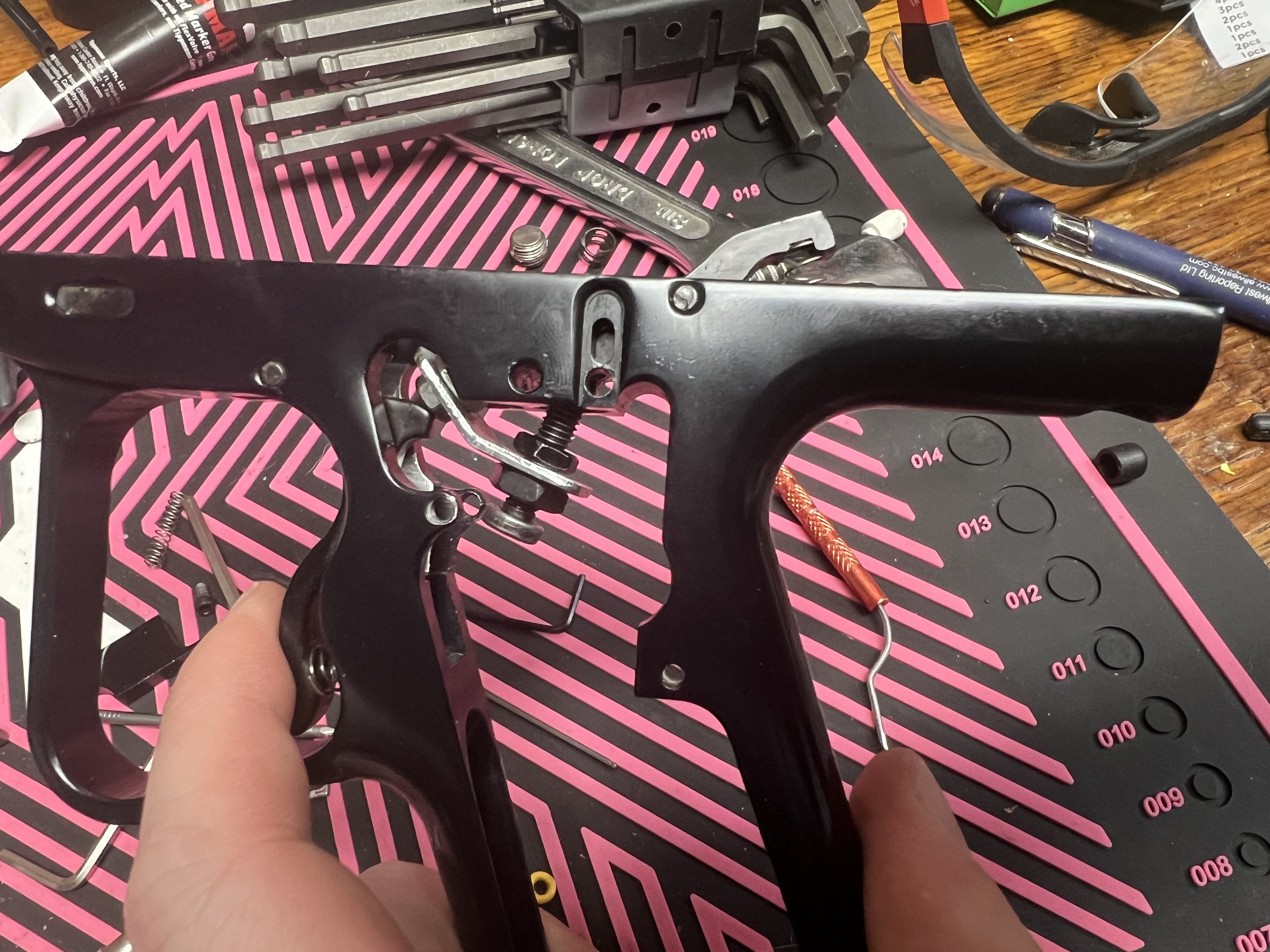

            Forgot I had this. How to fit this?
            • dano_____
              Tinker Tinker
              • 316
              I used a trigger frame and sear from a aci griffin. It actually needed a small shim to space the frame off so the sear could drop enough. Maybe try a sear from one of those?
                • 4559
                Trying things…. Will it work?! No idea, but the sear moves and I can adjust the action.
                  Cdn_Cuda commented
                  Brief revision and the sear drops!

                Whatcha got there?
                  • 4559
                  Mechanical linkage for the original frame! It shoots with air, but not recocking. Need more experimentation
