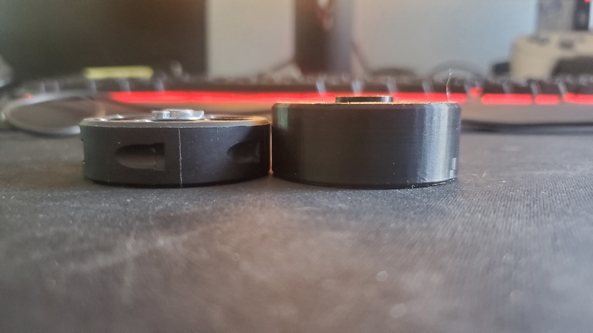

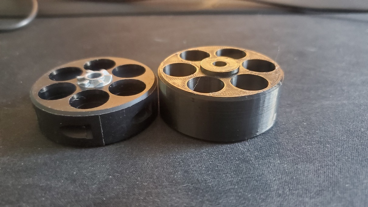

      3D printed a mock up cylinder from the dimensions provided by Lt. head-shot
      Diameter and the center rotating device are not an issue with my pouches. The thickness makes it a little tougher to put the mag inside the pouch since I use shock cord to keep the pouch together and ensure the mag doesn't just slip out when running. I'm sure if I loosen the shock cord tension it'd be easier. Good to see overall should be able to use the pouch for either one.
      The only snag is needing to know the size of that chamfer along the top and bottom lip of the mag. I did a 1mm @ 45° and it just doesn't seem right when I compare to pics.

          Thanks for the pics.
          Hmmm yeah the 'face' and the 'lip' of the cylinder seem to be very rounded.
