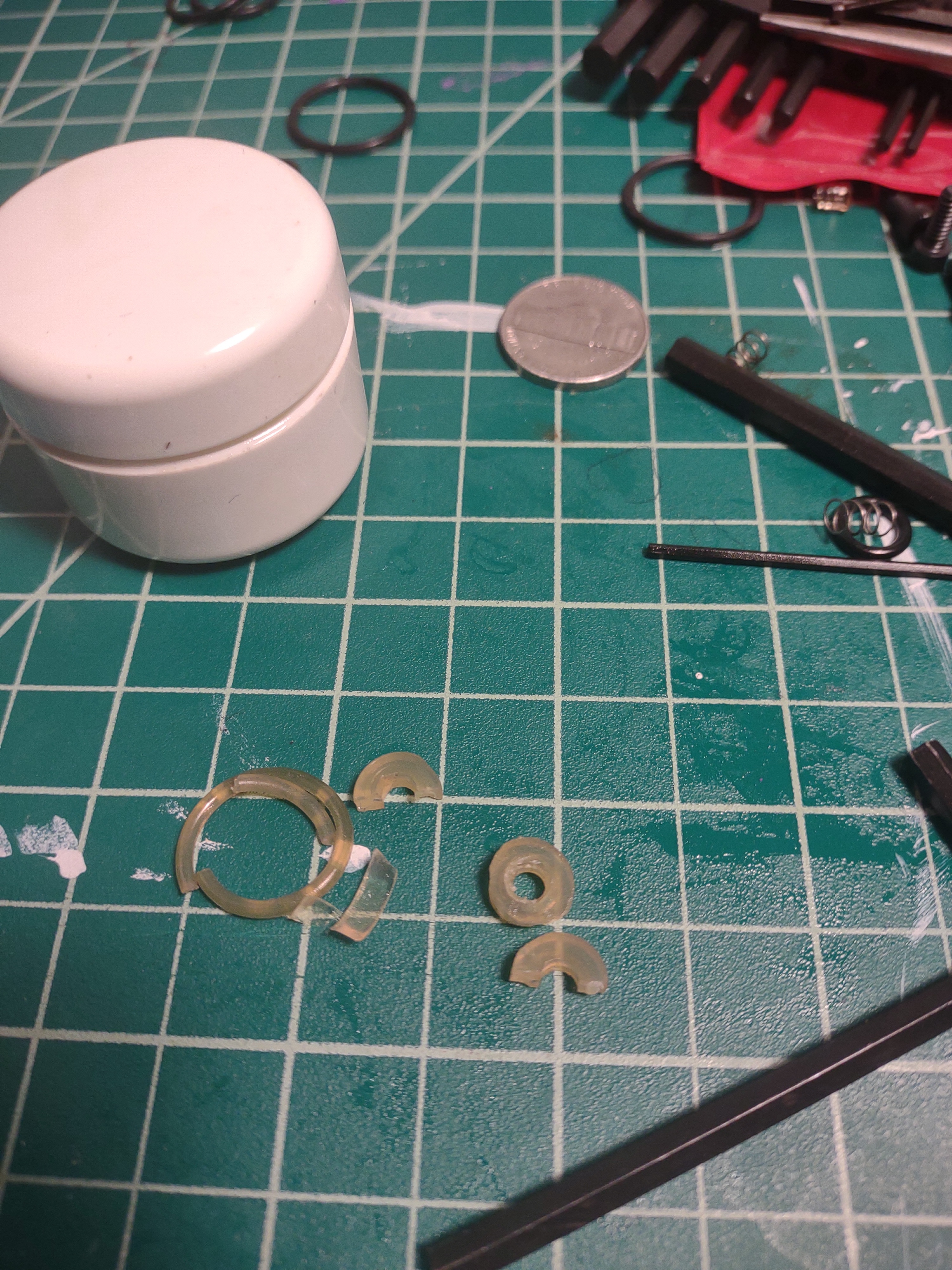

        Alright. After burning the last of my psi and trying at various levels, it won't recock and the most it'll do is start blowing air out of the noid. I am gonna take a break, go pack lunch for tomorrow, reassemble and give it one last shot before bed. I'll re-read the manual but I am thinking it's either a reg seat issue or a wrong oring. To no fault of Mr. Autococker04 I knew there were going to be issues, and this is what I pulled out of it earlier. Brand new reg seats, cup seals, etc.
        Edit #2 - I'm pretty sure the oring that was in the lpr was the literal glue keeping this thing working. Done with it for tonight. My mag works and the wife has a working axe, so, I'll shelve it for another day.
        Edit #3 - convinced its something in the lpr. Wrong reg seats perphaps? But ICD used a universal design. Found a few urethane mag seals lying around and I was able to get it to recock. Who made an aftermarket lpr for one of these? I thought palmers did but they only made stabilizers for the freestyle.

          AKA still sells LPRs for the Promaster, although at $70 I don't think it is worth it for a Promaster today. I have a Promaster that works fine, apart from lacking a valve pin and a vale cup (and the valve seal obviously), and I haven't been able to justify the cost of $70 to get it running.
          Yep, those valve seal looks exactly like every other valve seal in an old Promaster. I had a couple that worked just fine until developing a leak from "nowhere", but upon disassembling the LPRs, the valve seal simply fell out in parts. You may very well have a perfectly working Promaster, as long as you rebuild the LPR.

              I got some new cupseals in a parts kit from them, but upon closer inspection the one I am working with looks more like a torus than it does an actual circle, and it looked tapered for some reason, as if it wasn't cut correctly. I sent off an email seeing if I can get a replacement. I saw they had lpr's for the freestyle, which, tbf, is still a worth it upgrade on most freestyles; didn't see it for the promaster.
