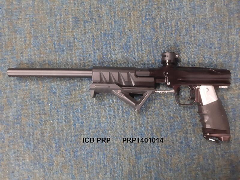

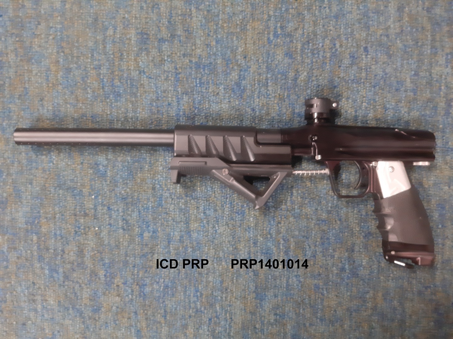

      • capitalpaintball
        • 309
        • Coventry, Rhode Island
        I put a guide rod with return spring . threaded right into the frame. it does make it so you cant field strip with the pivot.

          Very cool.
          Ego10Baller , did the sag cause it to bind or anything?
          • Ego10Baller
            Ego10Baller commented
            It did cause it to bind, unfortunately
          • Siress
            Siress commented
            Ugh. Sorry to hear that. Do you think it could be shimmed, or maybe have a couple of these threaded up into the bar? https://www.mcmaster.com/93339A245/
