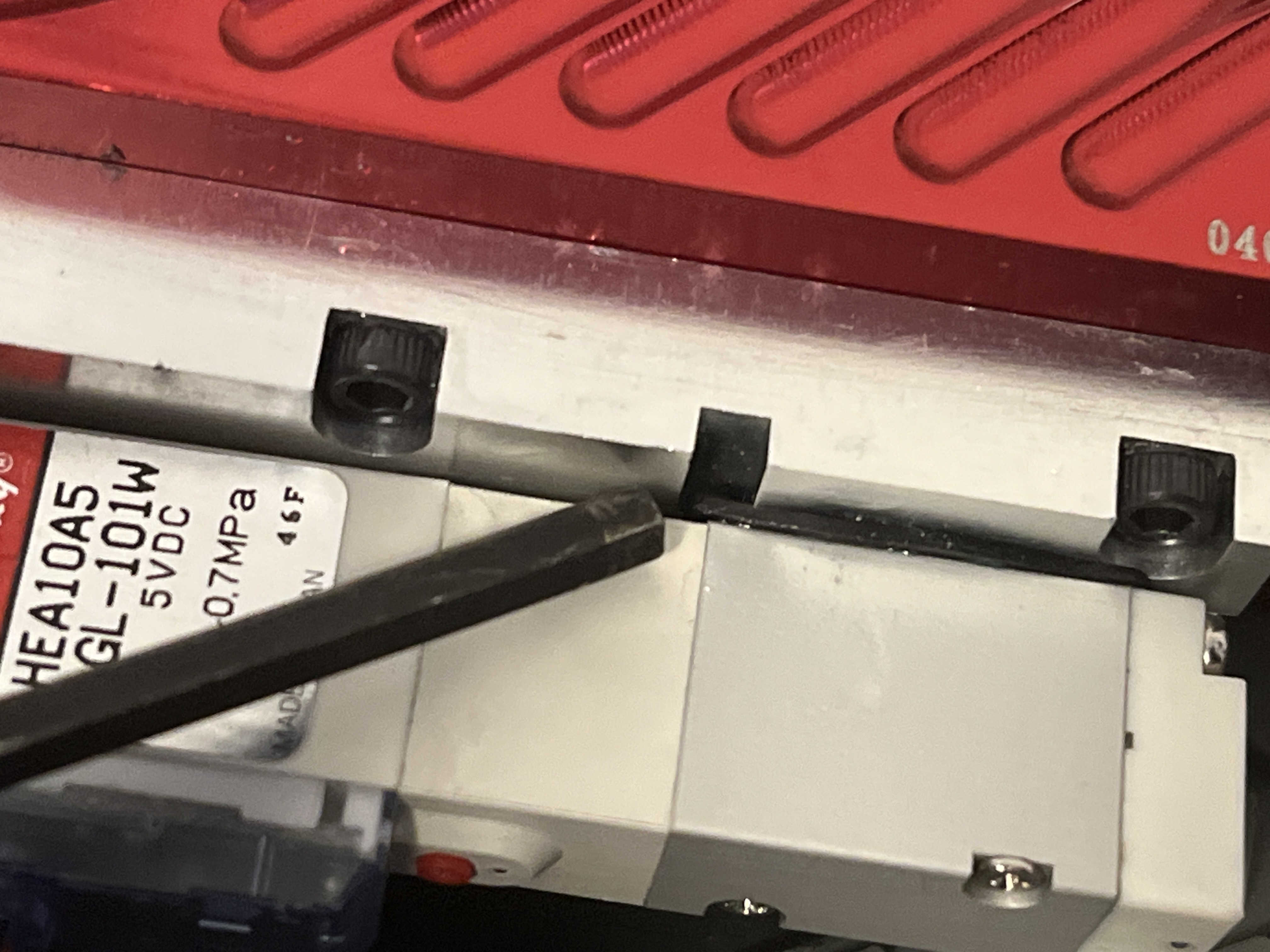

        Moving on… here’s where the leak is. Pointing to the hole with the end of my hex wrench. Seems like the manifold is fine - nothing leaking from between the manifold and body.

          That's where it blows off if your LPR is too high (most likely), or if you have the wrong durometer rings on the manifold (ruled out) or if your ram has a leak, or if your noid has a bad internal seal (least likely).
          What does the seat look like in your LPR? How about the cup? Did you remember your cup spring?

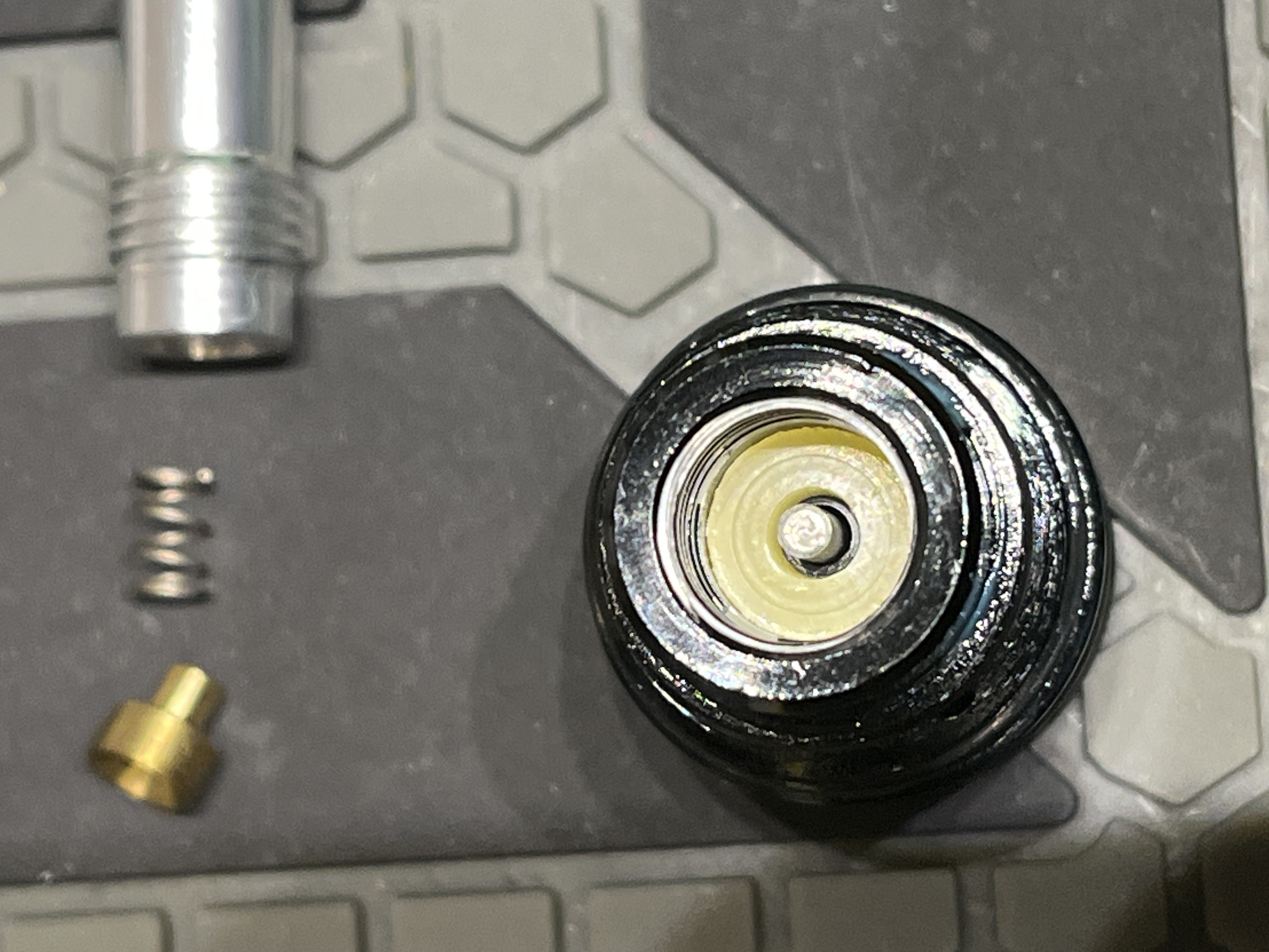

        I’ll take apart the ram and check for failed o-rings. Here’s the cup seal, cup, and spring.
        I put a new spring in the plunger from the minor rebuild kit when I serviced it a few weeks ago. The leak starts just a few turns in from where the adjuster is flush with the outer rim of the lpr - I assume this is around when it begins supplying air to the manifold/noid so I doubt it’s over pressurizing the solenoid unless I’ve put something together wrong.

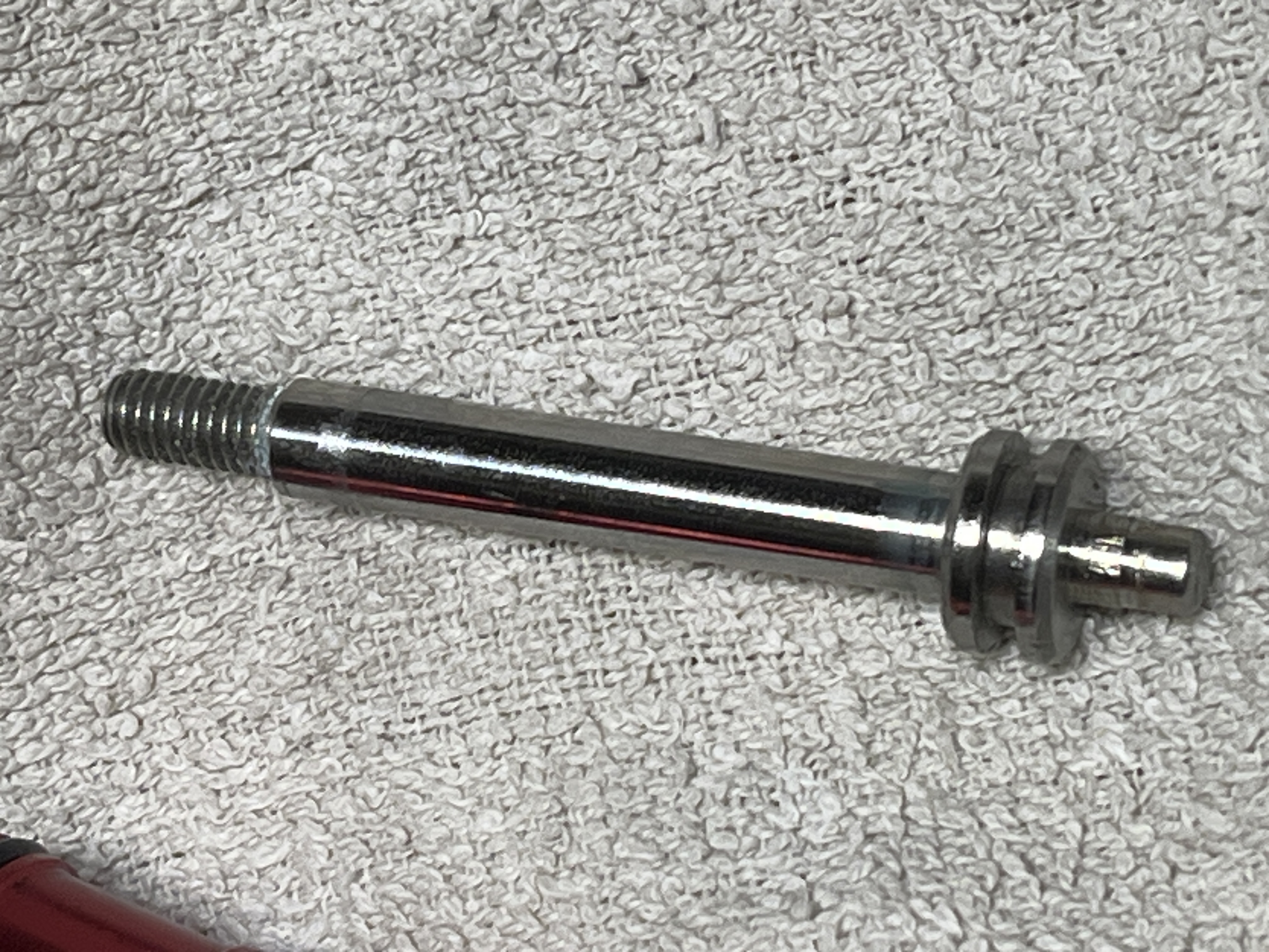

        Edit: yeah apparently I’m an idiot and was so excited at how shiny the ram was that I completely missed putting an o-ring on it 🤣

          No, there was no o-ring on the ram shaft so the first hint of pressure to the ram caused a leak. I had to burn out the loctite again to find this.
