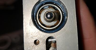

                    Heres one of the few I snapped when I opened it judt to get to know it.
                    The valve is there in the grip frame. That silver part with the ports are the ports we are talking about.
                    The pin sticking through it is attacked to the "star" its pretty self explainatory once ya see it.

                    I see what Jordan modded. The valve has a brass "star" around it. Air passes around the valleys of the star when the valve opens. It then runs up and out of the valve jets. Open the valve star valleys up, and the ports on the valve up, then polish it all shiny.

                      I think I filed grooves into the star's "points" as well... I left enough to stabilize the cupseal in it's cavity, but took some off to increase flow through.
                      A little at a time is better than too much... and a lighter valve spring (to increase valve dwell) isn't a terrible idea either.

                        Here yA go man. Knowing i need parts I just quick cleaned and lubed a bunch up. Heres the brass star I mentioned.
                            Awesome. Good to know. I have not opened my Cat up yet - so that gives me some clue. Please give me a after photo so I can see what extent you took it too. Thanks man.
