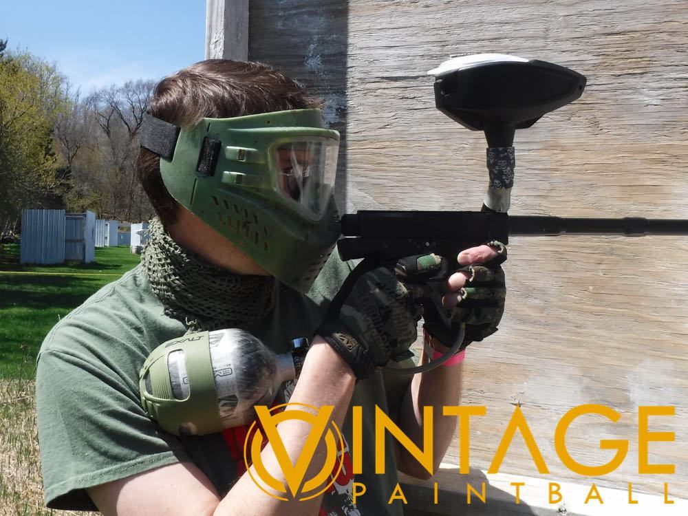

        I run a Spyder gas through grip and a bottomline. And had to tune down a bit from the factory screw settings to be under 300fps.
        That's how much better that setup is than a back bottle on these. I did open up the hole on the front block a tad also.
