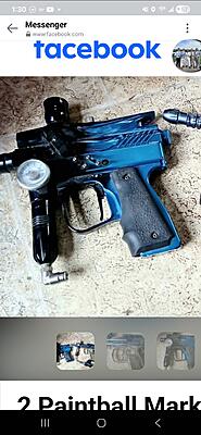

    Picked this one up off market place along with the spyder. Both are nostalgia projects honestly.
    If im looking at this gun right, it's had an aftermarket ASA added correct( looks like a cp reg... ive got a gladiator coming ill put on it). I think the lpr is stock as well.
    I had one years ago we ego framed, this one I'm going to build a shorter tray for and run a logic vert frame intended for an SFT shocker on ( FSP!!) and a nxt/break beam compatible board with the eyes.
    Im seeing palmer advertising an ICD compatible lpr, will it work on these?
    Always loved these little gun, and its one of the last stack tube gun that can realy be tinkered with.

    LPR is stock.
    Reg is indeed a CP HPR, but the vert ASA is also stock, they went to a standard Vert ASA in 2003 so it was easier to swap out the HPR (Thankfully).
    As far as I'm aware, PPS only has freestyle LPRs in stock which won't work. AKA somehow still has Bushmaster SCM IIIs listed on their website.
