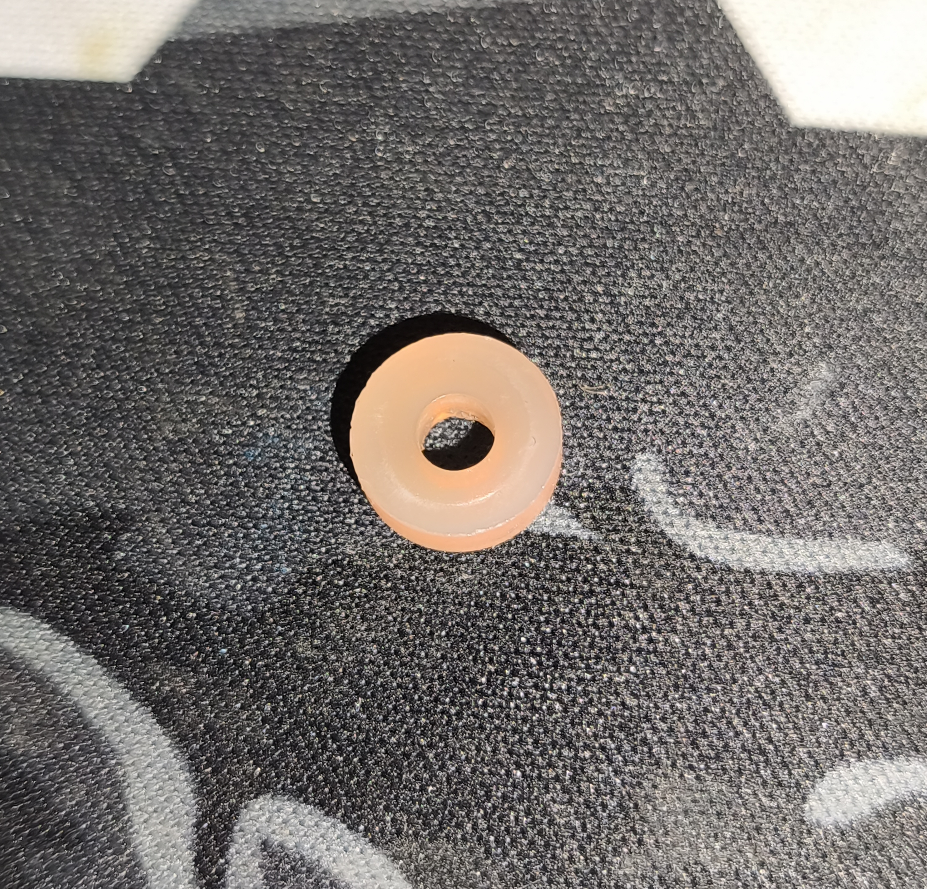

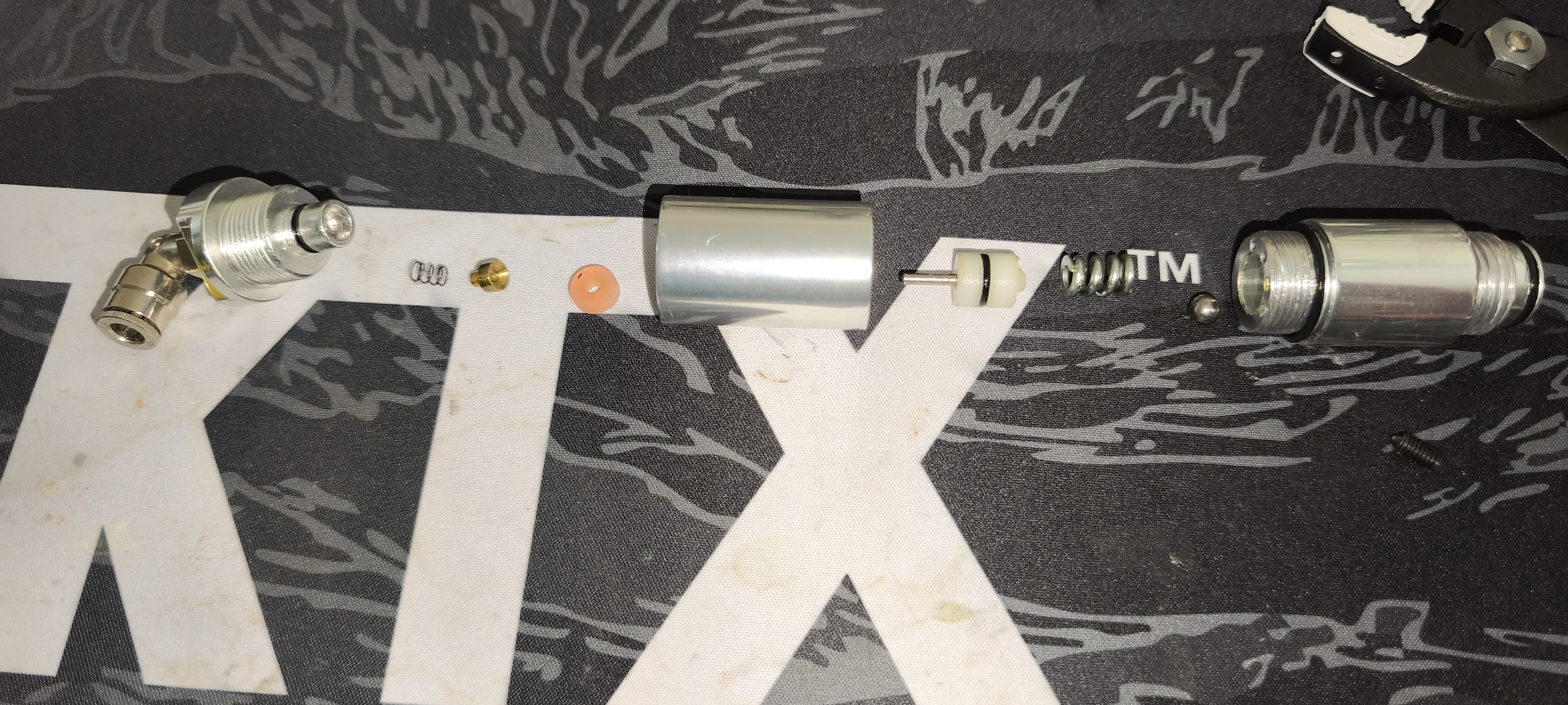

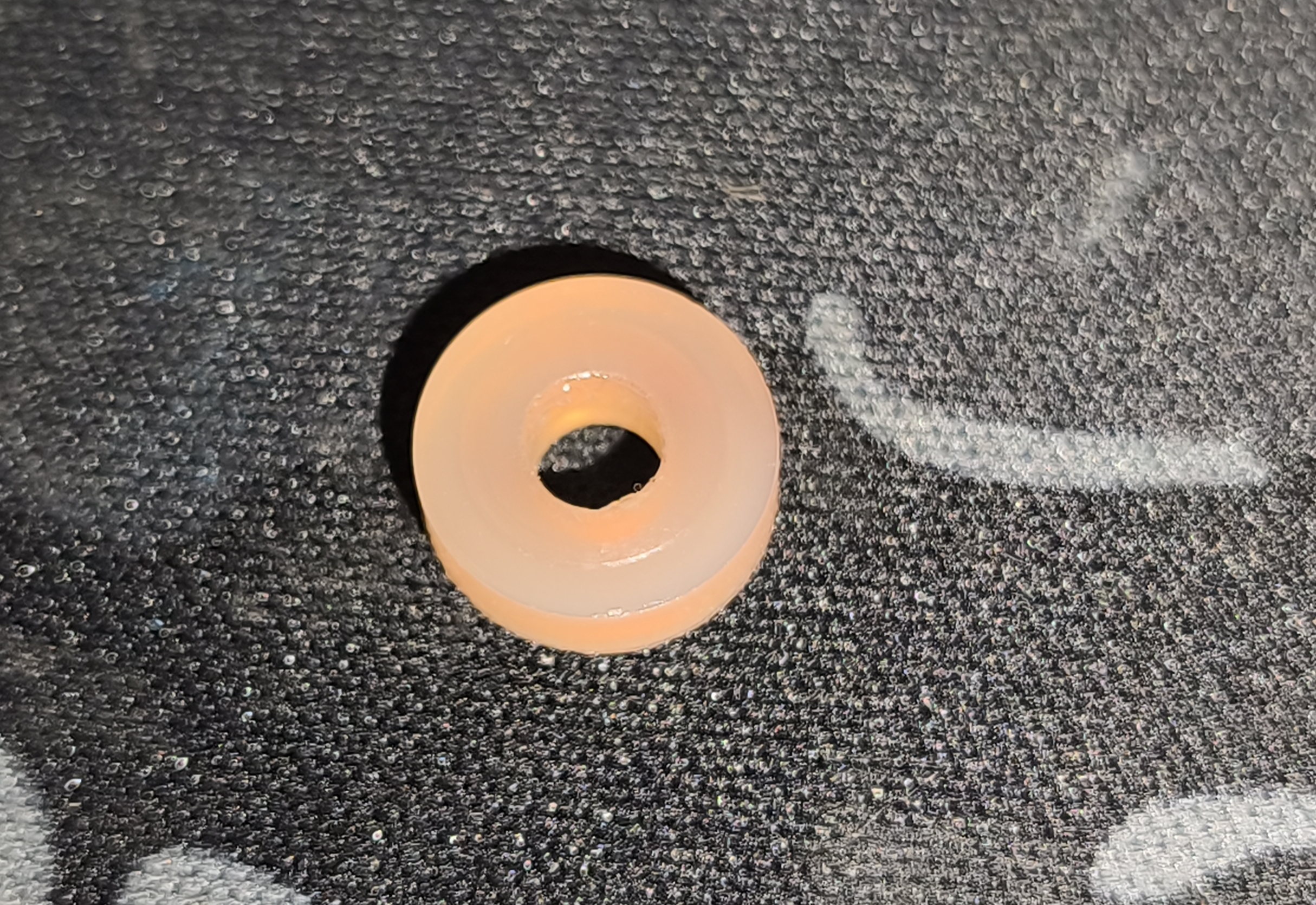

    Myrkul here's the internals and both sides of the seat. It still has some give when I squeeze it between my fingers.
    The feedbacks: https://www.mcarterbrown.com/forum/b...ndo-s-feedback
    • Myrkul
      Myrkul commented
      That actually looks pretty okay to me. You have a 90 durometer on the delrin piston right? They can be picky about urethane vs Buna in that location. It HAS to be 90 durometer though.

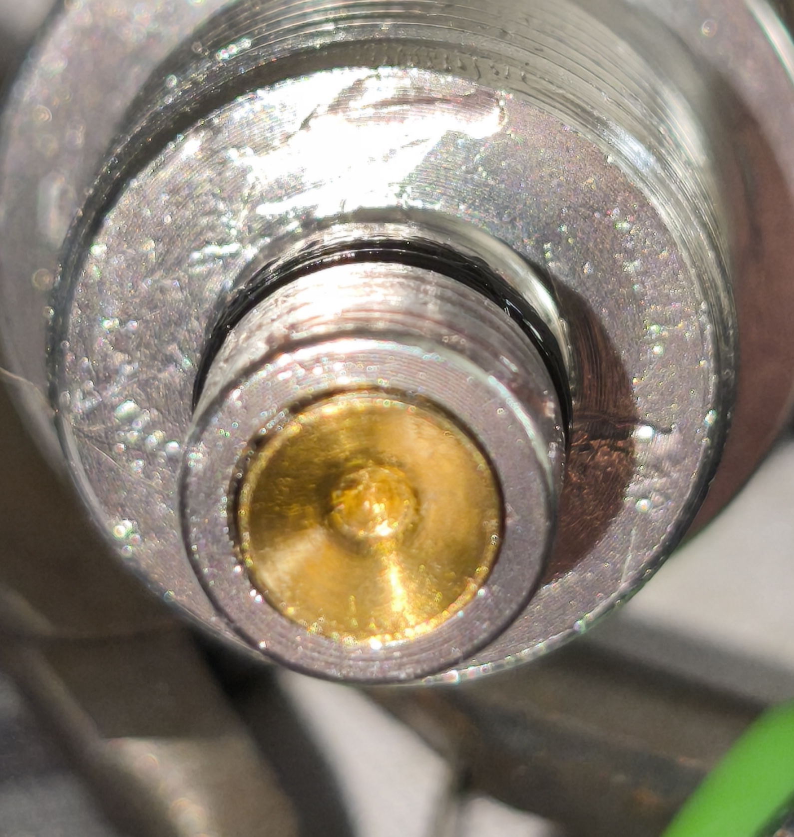

    The brass cup looks fine to me. Here's a closeup
    Really appreciate the help btw!
    • Myrkul
      Myrkul commented
      Too much grease on it for me to be able to see. Might not be a bad idea to stick a q-tip in flitz and then toss that in a drill chuck to polish it up a bit. There can be ZERO imperfections in that cup or it won't seal.

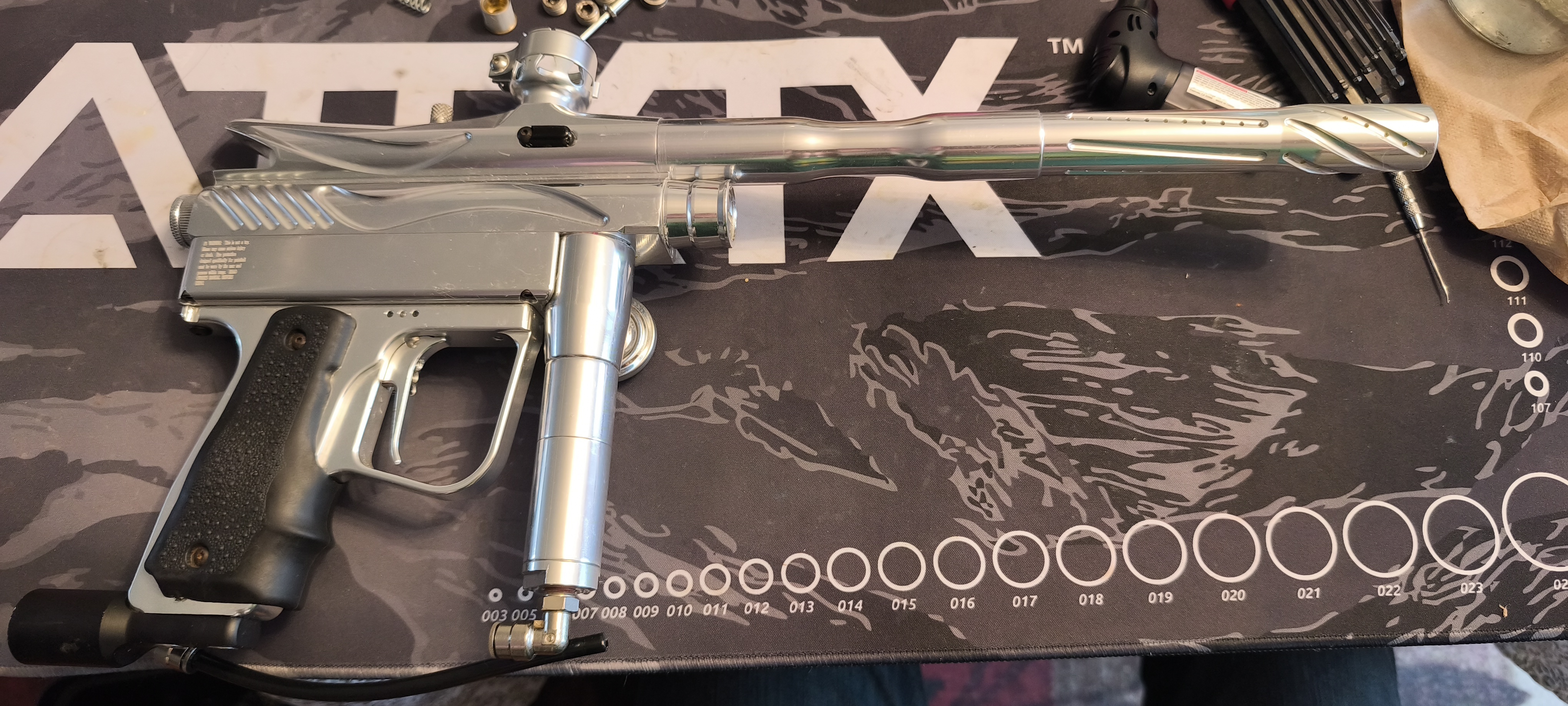

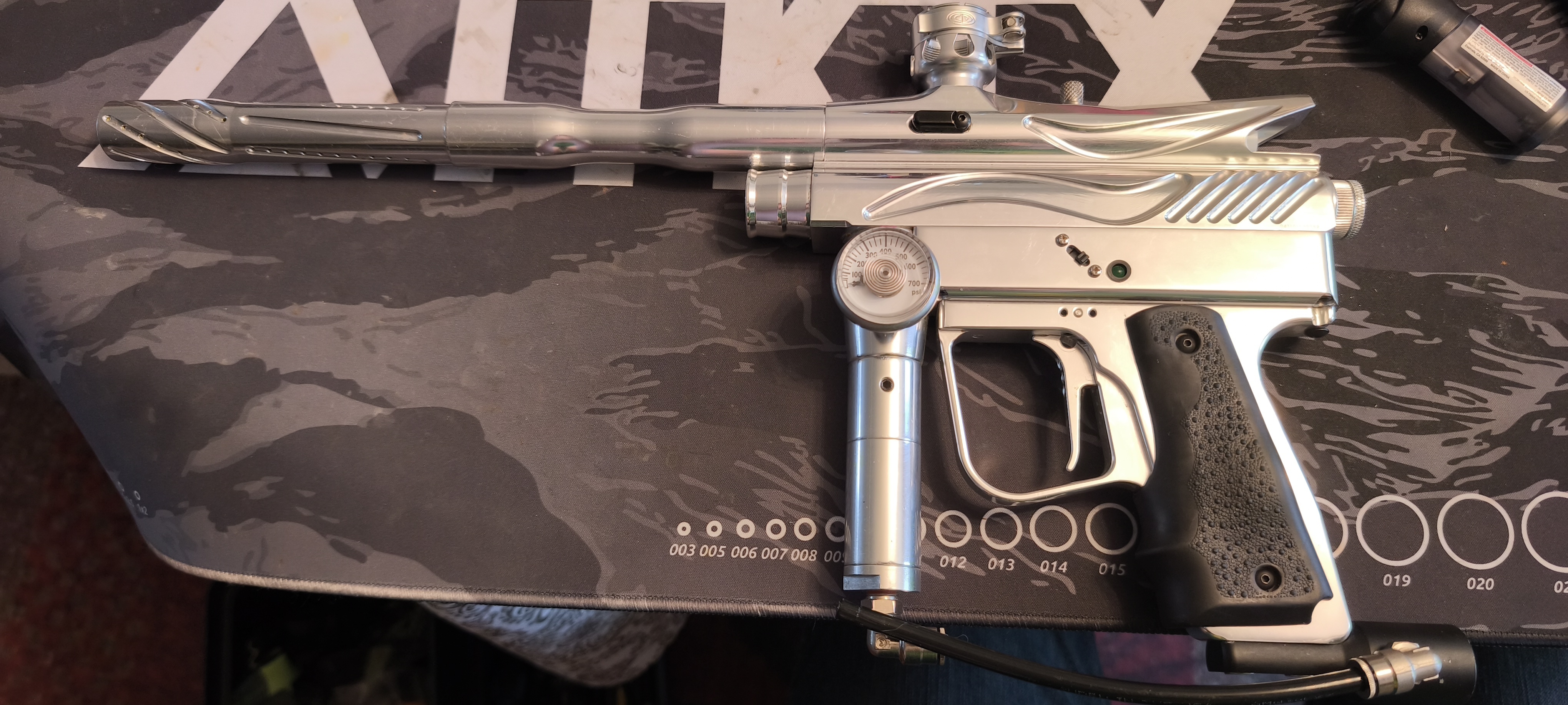

    I don't know which model of B2K it is, but here's photos
    • Myrkul
      Myrkul commented
      I think it's a 2k3 based off the lack of eyes and the #11 "o" ring on the reg piston. The a lot of the 04s came with PDS (Eyes) and they used an updated reg design that used a #015 "o" ring on the HPR piston.
