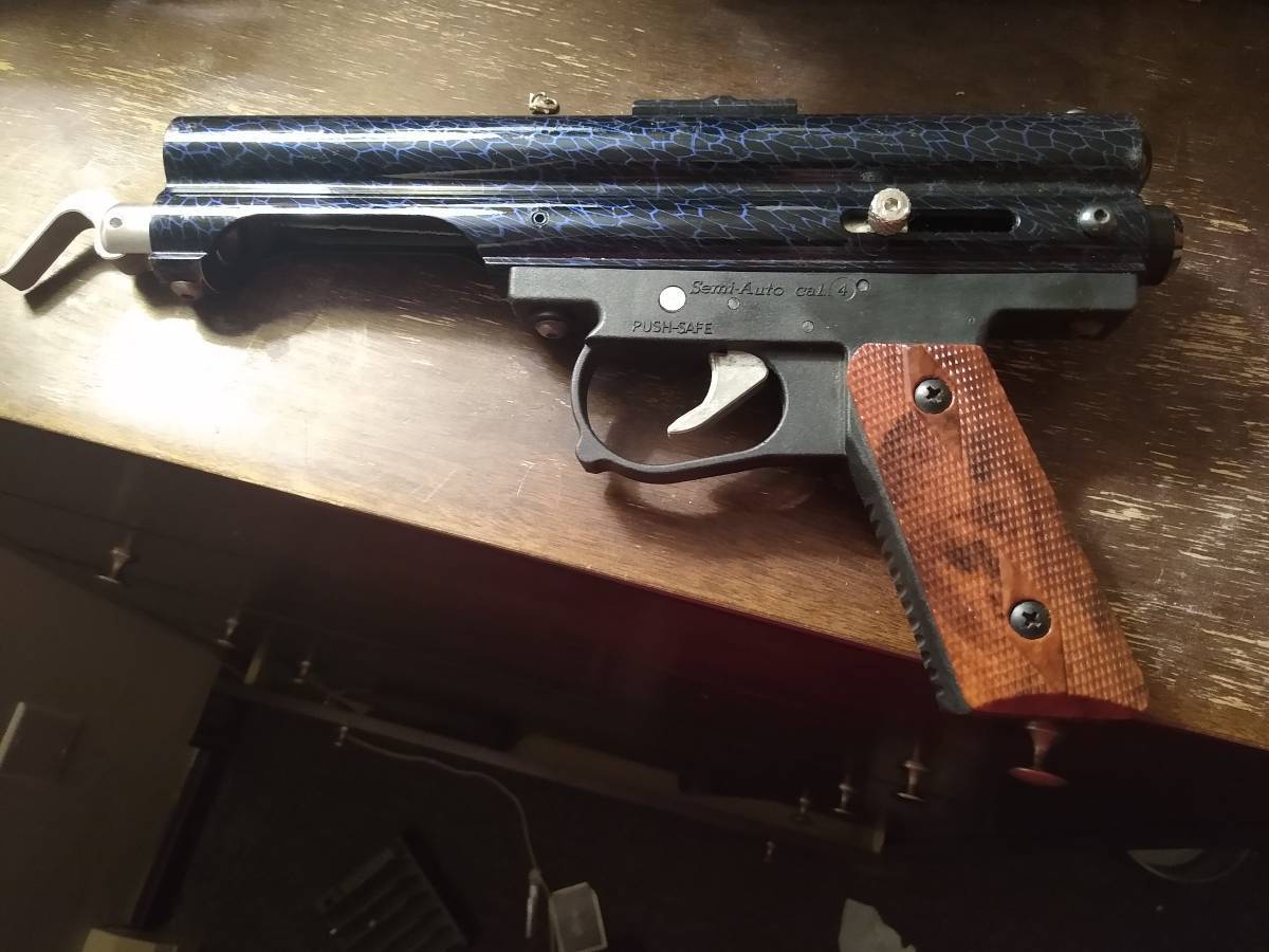

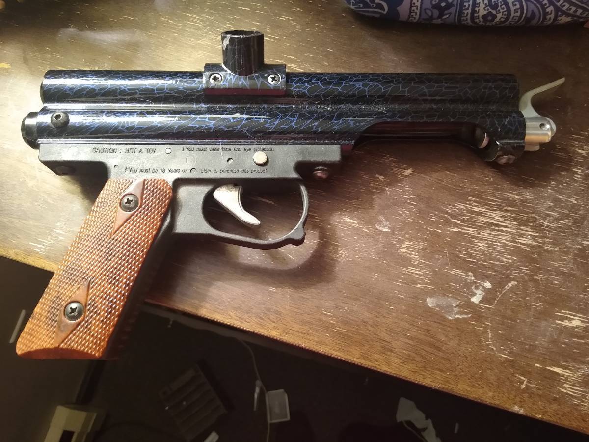

        Have you guys ever seen anything like this? I’m not familiar with Spydarms so I was just wondering if this is something worth going after?

          I've seen it, don't know the name of it though.

            Looks like a "Predator" 40cal... I used to want one to muzzle load blowgun darts into, but then I grew up.

              I think they were sold under the name Splatmatic it something like that. I also think they were 40 cal or something like that.
              I never had one in my hands so I don’t know what is usable on a spyder.
