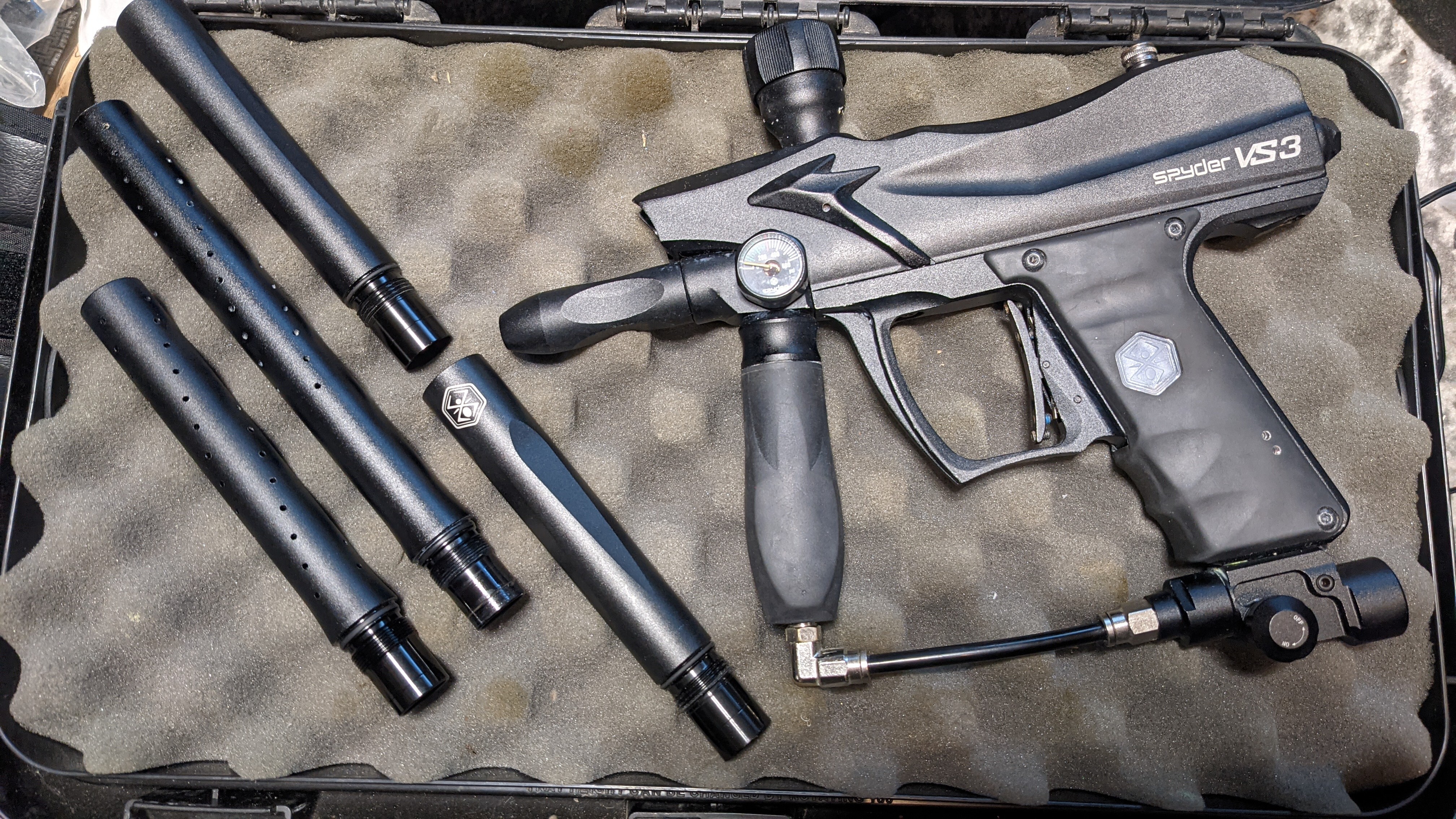

    Hello MCB,
    I got a good looking VS3 at a good price this weekend, it came with both smooth and rifled back and 2 tips.
    This is the first electo (without counting the C3) I own in the last 10+ years ... So now I have some questions for the experts ...

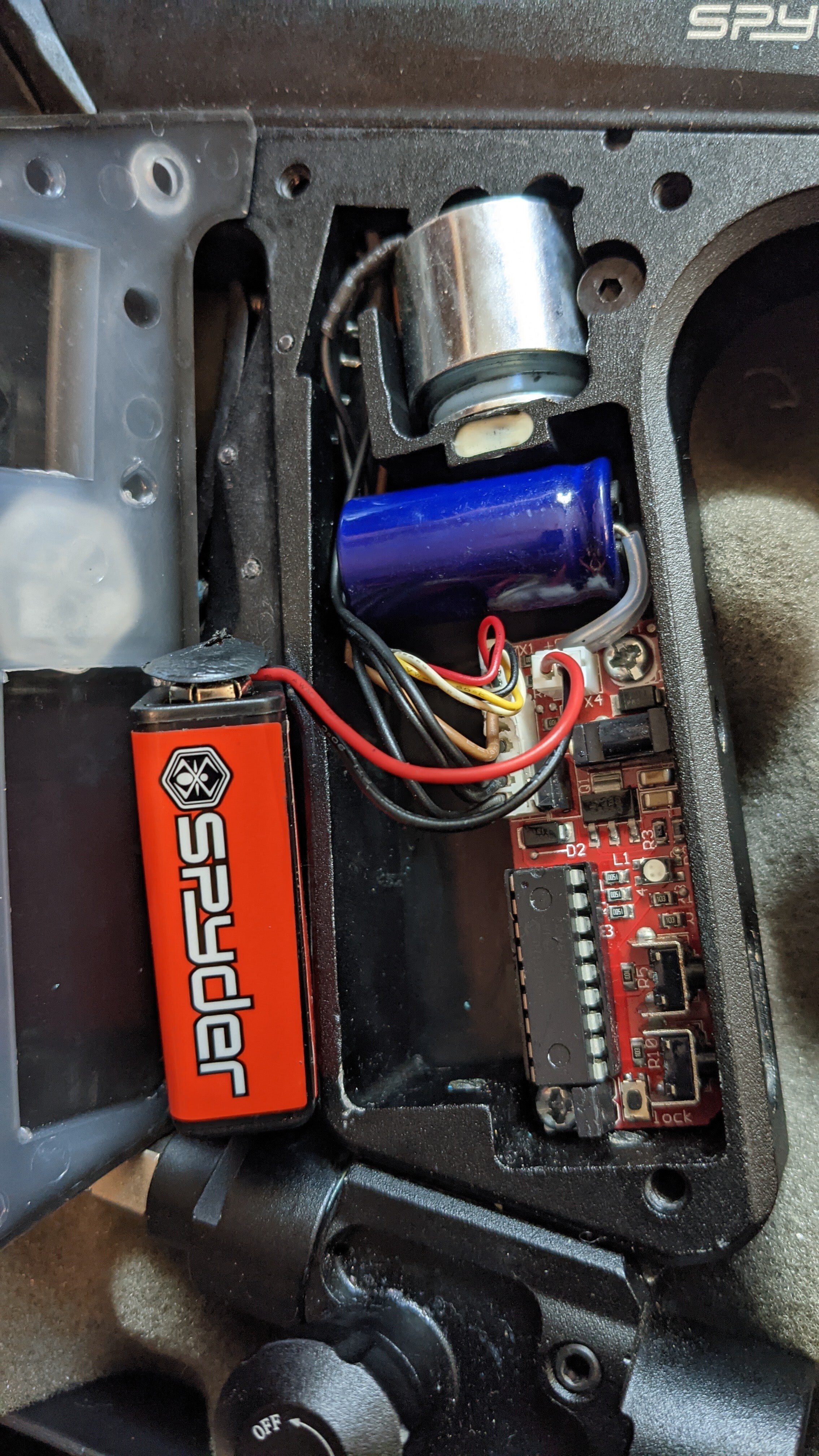

    It came with a wall charger, so I plugged it overnight ... And the light stayed on all about 3 seconds ...
    I did manage to trip the shear once, so I believe the board is good but the battery is absolutely dead ...
    It is an original 9.6v Spyder rechargeable batteries.
    Here come the questions:
    - where can I get a replacement one?
    - is charging it through the wall charger OK?
    - Any alternative to those batteries?
    And as a more general question, how does it shoot? is it worth keeping it as a loaner/backup?

    I've got a Spyder VS2 at the moment with the same battery issue. Charged it for a long time, but it's dead. You can get replacement 9.6v batteries. Amazon has a few under Powerex brand. There's supposed to be issues with using just a standard 9v.

    Does the board or charger have charge control to protect the new battery?
      • 4560
      That I don't know but I think it's the board as the charger looks to be a pretty standard power supply.

        That is a 9.6 VDC NiMH battery in a "9Volt" package. They are fairly common here is a link:
        https://www.amazon.com/Powerex-Self-...1FV0U5WG&psc=1
        Pretty sure any 9.6 VDC battery you can get to fit in the space will work but the space is pretty limited most likely why they chose that package. NiMH batteries do not have long shelf lives and degrade over time. I would replace that battery with new production and plan on replacing on an annual basis.

          Pay attention when you buy rechargeable 9v batteries. Make sure they are 9.6v. Most marketed as rechargeable 9v’s only put out 8.4v and will likely not work well in a spyder e-frame.
          I purchased a 2 battery and charger set from ANS for an e-spyder I picked up. My old batteries were all dead. The brand was Valor and apparently made my Tenergy. They offer them in 9.6v and 8.4v so read carefully. I haven’t had a chance to really put the batteries through their paces, but for The little bit of testing I did with paint, they seem to do the job nicely. I would recommend looking into them for a good replacement for an e-spyder.
          here is the link from ANS but I think they are on Amazon as well: https://www.ansgear.com/Tenergy_Valo...96valorkit.htm

            The Powerex 9.6 battery works great. I've been using the same one for 5 years now. If you use it a lot I'd recommend getting a dedicated charger (make sure it's 9.6 rated) and not charge through the board. You'd only need to charge it about 6k shots, or if it has sat for a while. Disconnect the battery when not in use will help keep it charged when stored.
