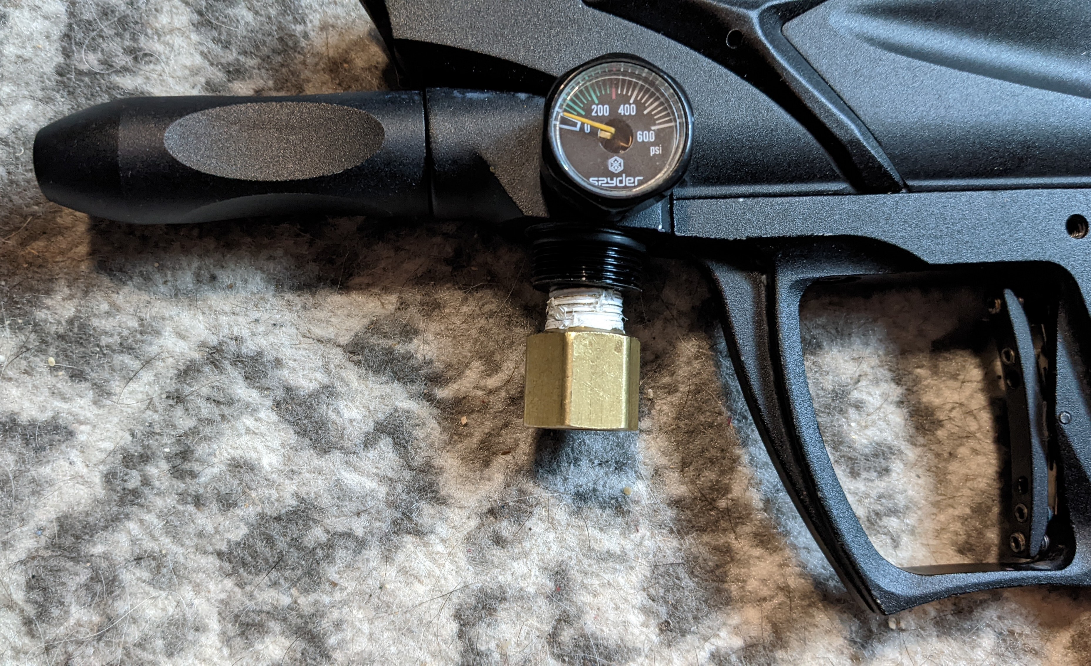

        So here it goes:
        threaded for 1/4" npt, now all it needs is an asa ...

          So I'm gonna take an asa, cut it down and thread the back for 1/4"not and connect the 2 with a close nipple ... Might make 3D printed "sleeve" to hide the threads and call it good

            I thought about getting one of those, but i have the parts to make one with 1/4"npt threads on top, it will be a bit tighter and larger opening than to reduce to 1/8 ...
            If my stuff looks to craptastic, and i end up using the marker some, i may splurge and get one of those ...
            Thanks for the link, i didn't realized they were also called that.

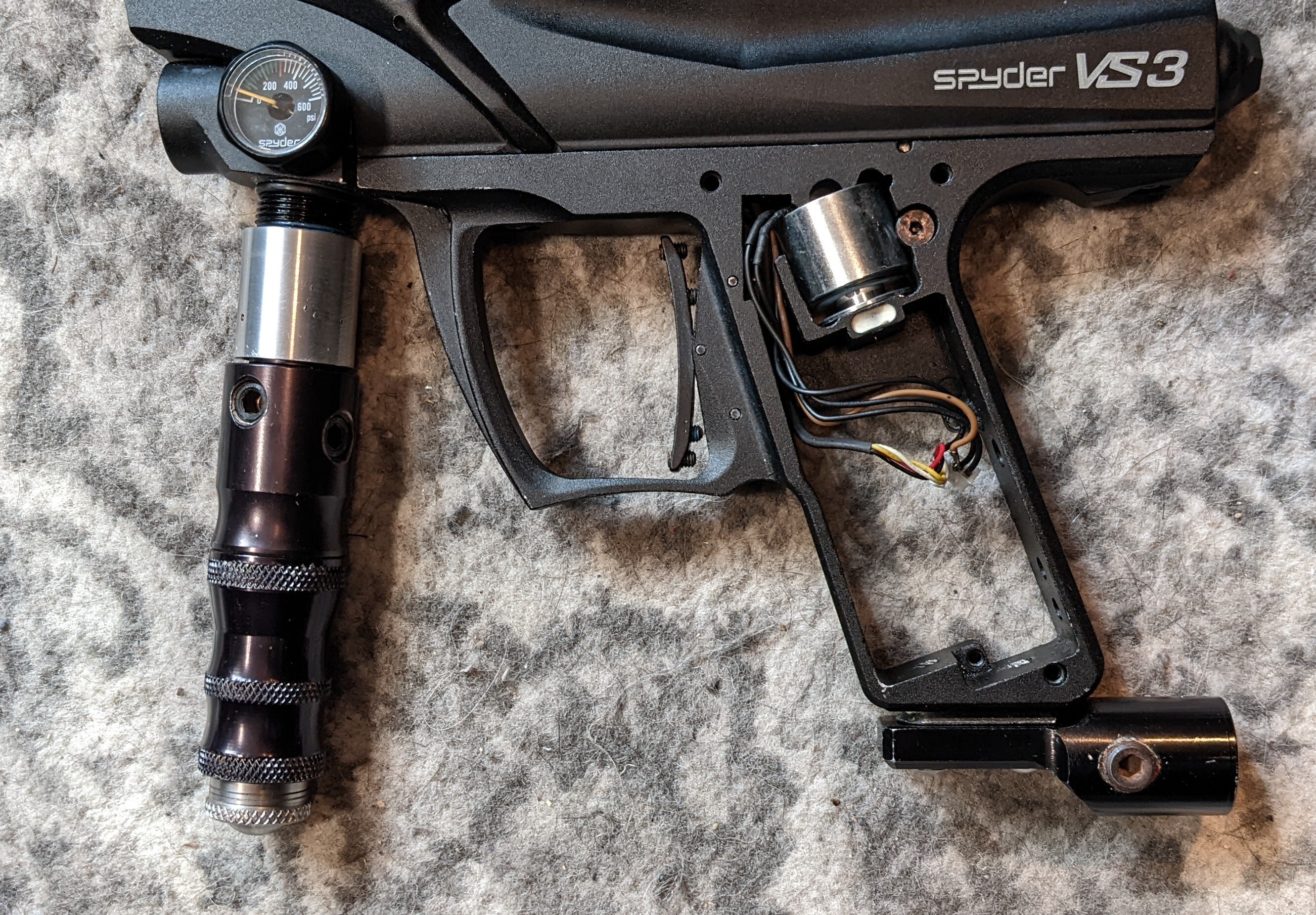

          Here is the test fit.
          of course I didn't find the 1/4" close nipple ... So it will be tighter once it's complete and threaded to the proper depth ...
          (Might also swap the asa for another one ... Or a cheap on/off if I found one ...)

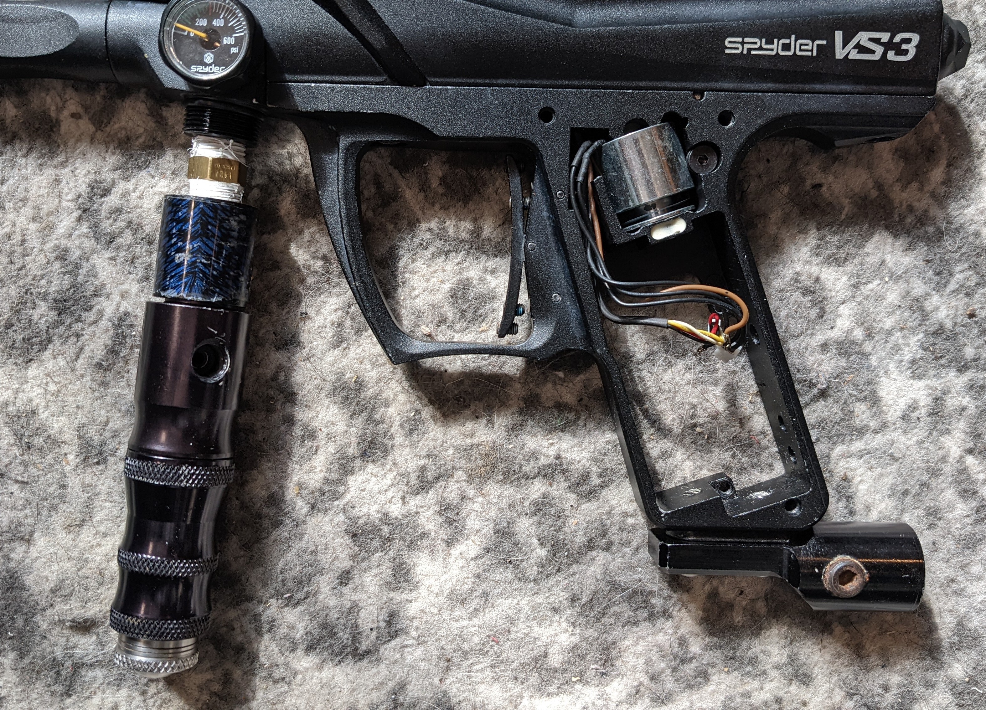

              Found one laying around 😅
              might do a little 3D printed cover/shroud for the top at some point ...
