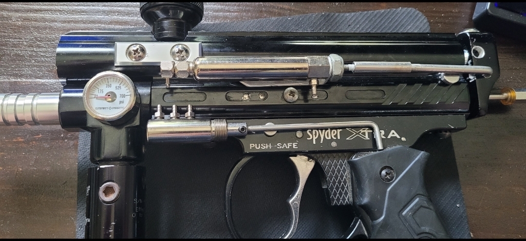

    Super tiny update, no luck in creating my own little bracket. I've not found the right size nuts to essentially pin the 3-way to my custom bracket.
    So... I'm looking at chopping up an extra front block I found in my parts box. I've had very little time to work on projects lately since I'm trying to get my garage in order (future shop).

        I had a fleeting moment so a little more work was done on the project. Mostly maintenance stuff. Cleaned, o-ring-ed, and lubed everything so it should all be in working order.
        Because I had it lying around I swapped the stock spyder valve with an EKO one. I didn't alter the valve to close off the blow-back air, but that might be an option if I get it running well. It should be a more efficient valve overall.
        The Ram was dead, and I found rebuilding it with store bought o-rings a real challenge. They just didn't want to seal up. So I grabbed this one off of another setup, and I'll have to try some different o-rings to get the Ram working.
        Eye ball timed the bolt and ram positions. It should cycle correctly now, with the bolt moving correctly, and the striker able to catch easily. There is no hammer lug to adjust on a spyder, it's all about the ram and back-plate position.
        Which leads back to the current shenanigans... hmm. Do they make a shorter 3 way rod? That is a beefy piece of metal to try to reshape.
        Also I might just zip-tie it together... just to see if I can get it to function.

          That's a nifty option. Anyone have a measurement of the trilogy 3 way arm? I'm looking at roughly 1.95, or just shy of 2 inches, is about the length I'm looking for.
          There has to be a slide lock mechanism I can buy too that does exactly that.

            Not nearly as much as I'd like. I've had to fix other things and home projects that are getting in the way of the important things.
            I'm still stuck on mounting the 3 way. I think I'm going to buy a tap and attempt the custom bracket again. I'm trying to measure out the timing right now before I mount the 3 way.

              Any way to fab or 3d print a bracket/holder for the 3way that fits somehow to the front frame screw?
                XEMON commented
                Should be doable, the threads for the 3 way are standard and taps can be purchased for them (I have one sonewhere)

              An update, but not a good one. I was really hoping to have this working before end of the year, but life projects have amassed to critical levels, including an injury (I'm almost fine now).
              I have everything 'working', it holds air, the ram works, the 3 way mount is the last obstacle for assembly. I'll get there...
