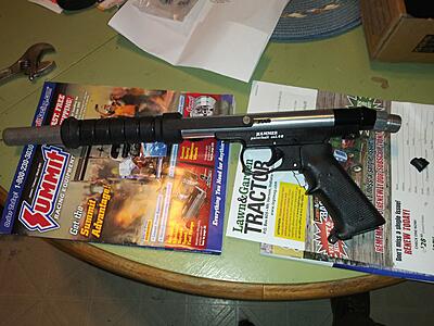

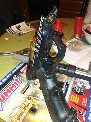

    So, I wanted a vintage pump and bought this "rare Kingman Sypder Hammer in mint condition" off of EBay. Went to test it out and the grip frame broke after a few shots. Before testing, I noticed the safety was missing. Ahhh, well no returns or refunds but I did order a new composite grip frame. Anyways, I'd like to know what upgrades y'all have done to your Hammers

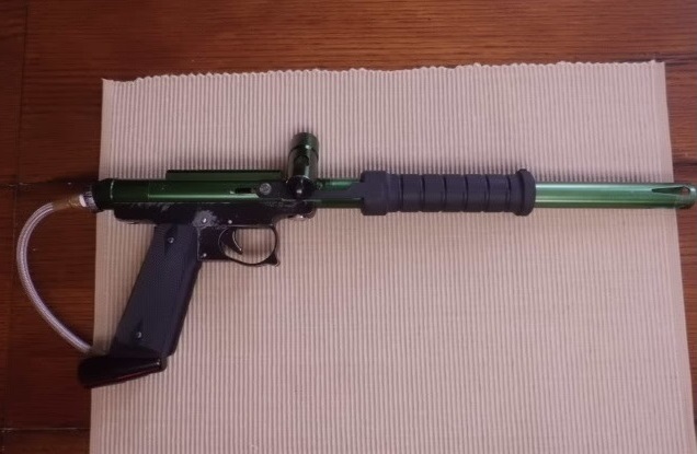

    This is an original Hammer Plus with .45 block and bottom line setup. I have another one completely stock in its original packaging from 1994.
    Click image for larger version  Name:	hammer pump, green.jpg Views:	0 Size:	67.1 KB ID:	242732

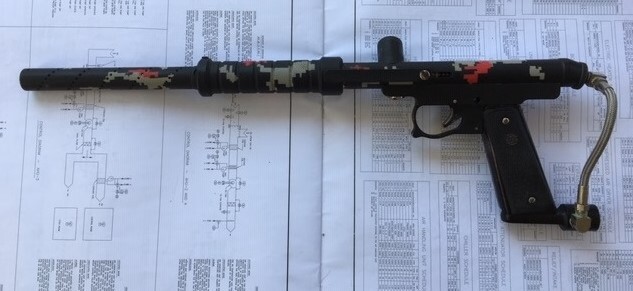

    This is a Hammer with metal frame and .45 block w/Hogue palm swell grips, bottom line setup, and a Freak barrel.
    Click image for larger version  Name:	hammer urban camo.jpg Views:	0 Size:	46.3 KB ID:	242731
