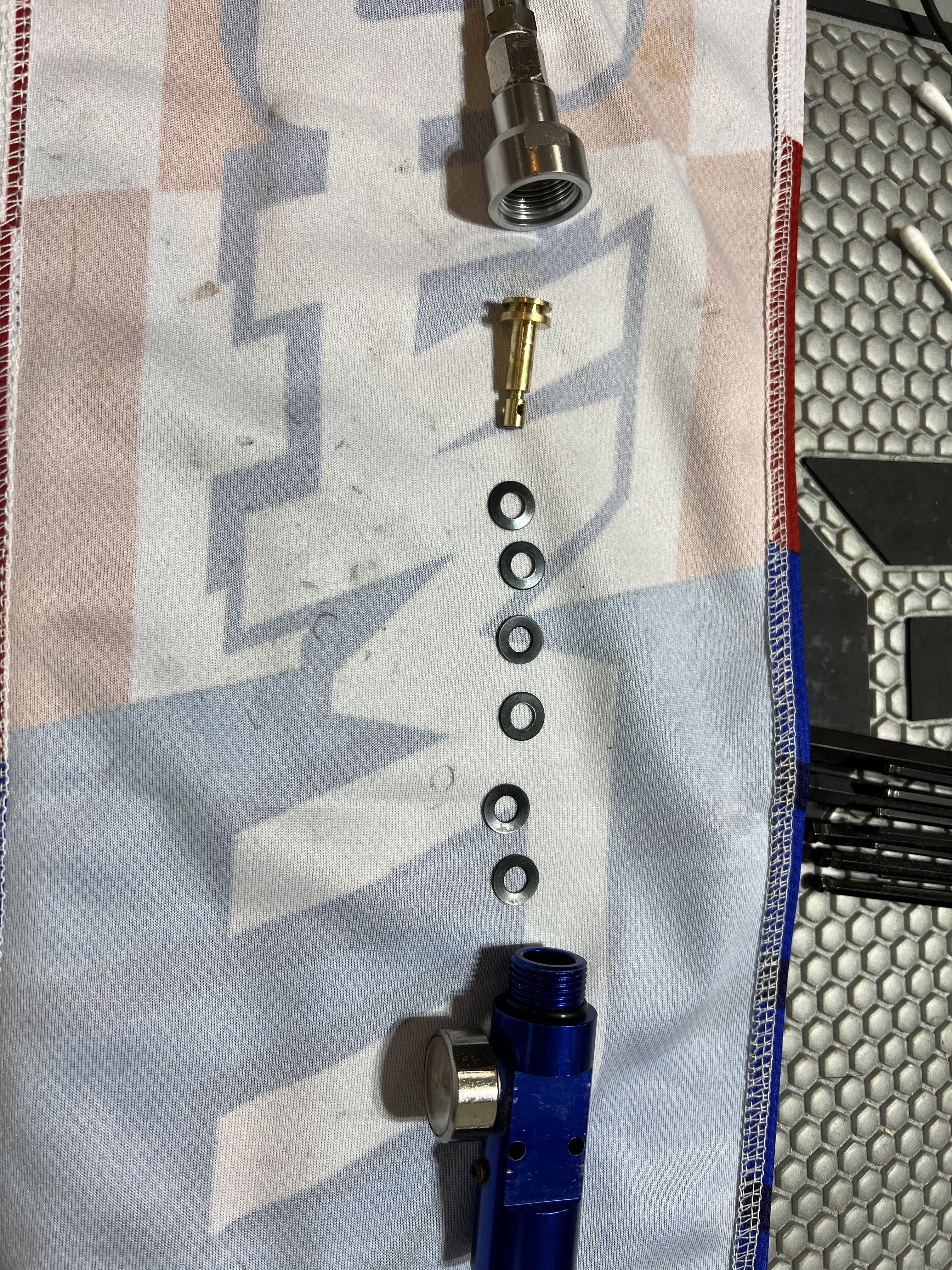

    Tore down the reg on the AMG I’ve been working on.
    seals were sludge so I don’t know what size they might have been.
    anyone know what size and type of o rings I need?

    I'm not sure the sizes, but there's another piece inside you're missing. You'll have to use compressed air to blow it out (be careful).

      Tried that. Can’t get below 310 with my lightest spring.
      Wanted to see if I could get this going to avoid buying hpr+adapter.

    I can't remember the sizes off hand. I think ans might still sell the parts with orings on them.

      on the small tip of the brass piece is a little clear-ish rubber bumper. thats the go/no go for the air. make sure you dont mess with it too much and dont lose it. if the reg is creeping, you can take it out and flip it around. but you should be fine as is.
      if it leaks out the reg when its all back together, its the o-rings on the brass piece.

      I just rebuilt some of these, I cant check sizes tonight.

        Left to right o-ring sizes: 009, 012, 006, 006, 006, 016
        • DavionGuard
          DavionGuard commented
          champ. Thank you.
