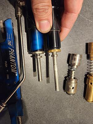

    So I understand the Hammer's powertube is a different size than standard Nelson, but is it possible to change the retaining screw to use standard Nelson powertubes, hammers bolts etc?

    Not sure what you mean by "retaining screw." Do you mean for the entire valvebody?
    • Toestr
      Toestr commented
      The part that screws into the valve body that the cupseal seals against.

    It's the same threads. The only thing I would have to check is the length. Let me take a Phantom apart and compare the 2

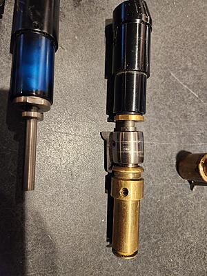

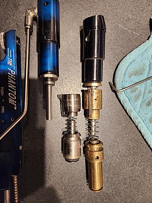

      So the big difference is the bolt. The Phantom uses a bit of an extension on the bolt for the power tube, where the Hammer just had a longer power tube. The Hammer also has a longer breech that the bolt pushes into. Basically the Phantom bolt would never go past the feedneck, leaving it wide open.
      What does seem to fit is the hammer. It clicks in and the sear lines up.
