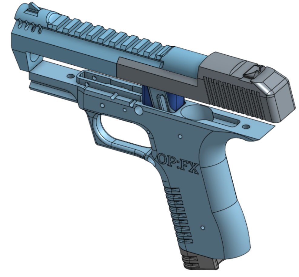

                  #24
                  I am sitting in the airbnb in NC after playing Fulda Gap the last two days, but I am almost done, for real this time!
                  Trigger grouping pin locations took me six or seven months to solve. Ended up sending the grip out for 3d scanning to validate my caliper measurements; I was a few thousandths of on most of them.... but it was enough that it didn't quite work.
                  Grip frame test #30 had the supports removed on the drive down, and I moved the internals into it last night. It works fine for the commission Eraser, but my Chaser doesn't seem to like it for some reason.I have an updated mag design that matches the grip aesthetic with grip grooves so its easier to pull out. I will sand the new mag (elephant's foot on the print) so it fits a little better and I can throw some rounds in it and take it to the garage- as long as I can get the trigger to work in the bored out chaser, this will happen asap.
                  Thanks for sticking with me on this project! Looking forward to having another worlds first in my hands! Attached is a photo of the CAD for the grip frame and the modeling of the DEagle body kit I made. A lot of this was done on stream, if you want to check my VODs on twitch, user name is the same as here.
