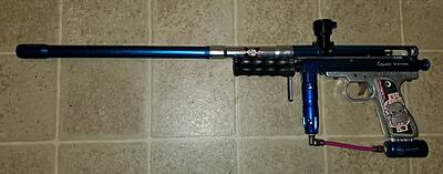

    • nobbie333
      MCB Member for life
      • 465
      • Kansas City, Missouri
      • ChoSanJuan
        ChoSanJuan commented
        Oh man, I've been super curious about those pump handles! Looks great on there! What happened to the bonus one I sent ya?
      • nobbie333
        nobbie333 commented
        I still have them all except the pink one is going on another spump a (dueling set)
      • ChoSanJuan
        Dude, can't wait to see it!
    • ChoSanJuan
      I do things... and stuff
      • 797
      • Milwaukee
      It used to have a TL body but I just recently swapped it out for a more "modern" body with a vert feed and ball detent.

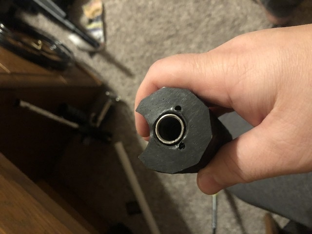

      • nobbie333
        MCB Member for life
        • 465
        My other Spumps work in progress
        I added a bushing to all the pump handles

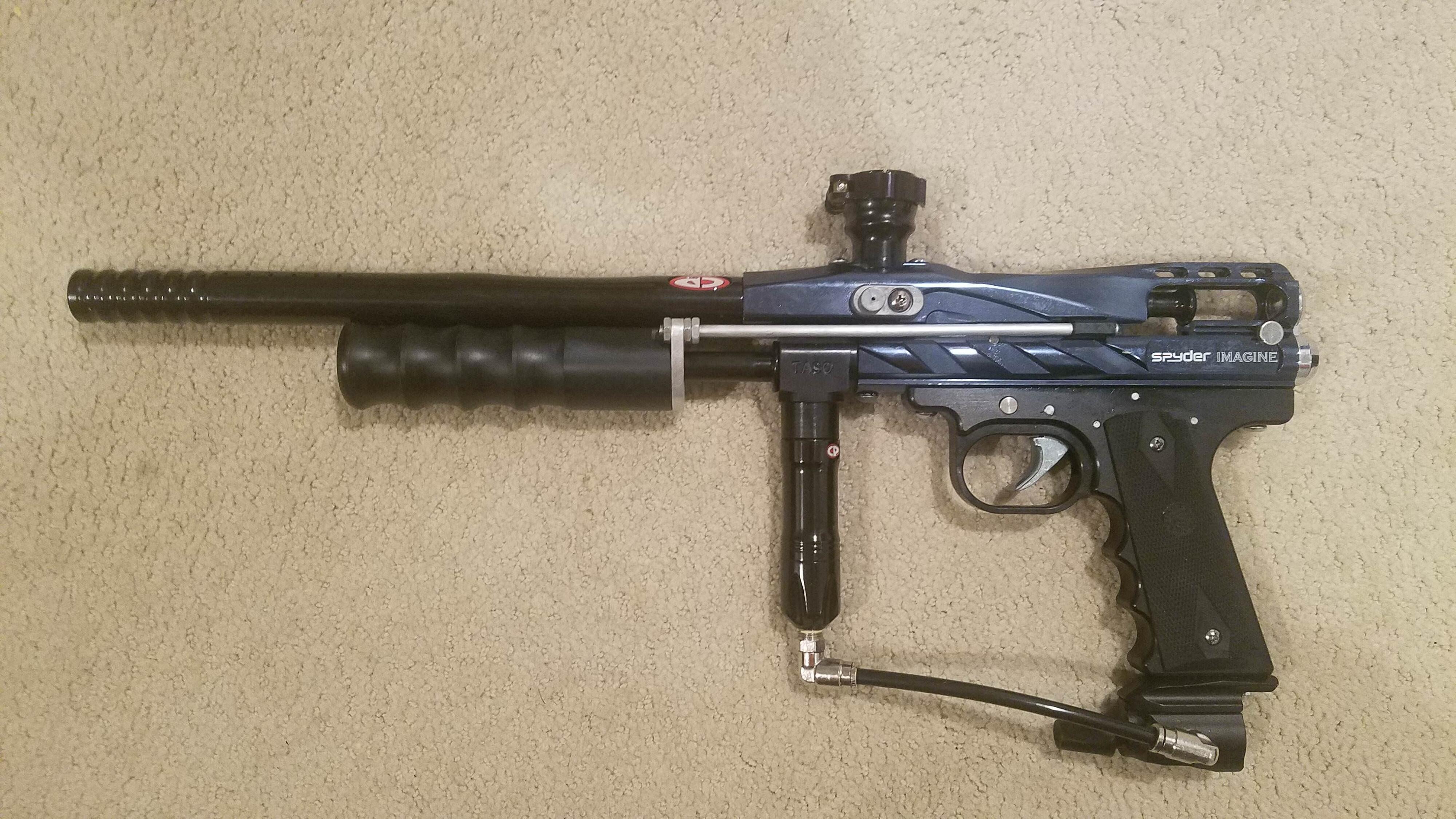

        • Knuckle Dragger
          Necropost enthusiast
          • 567

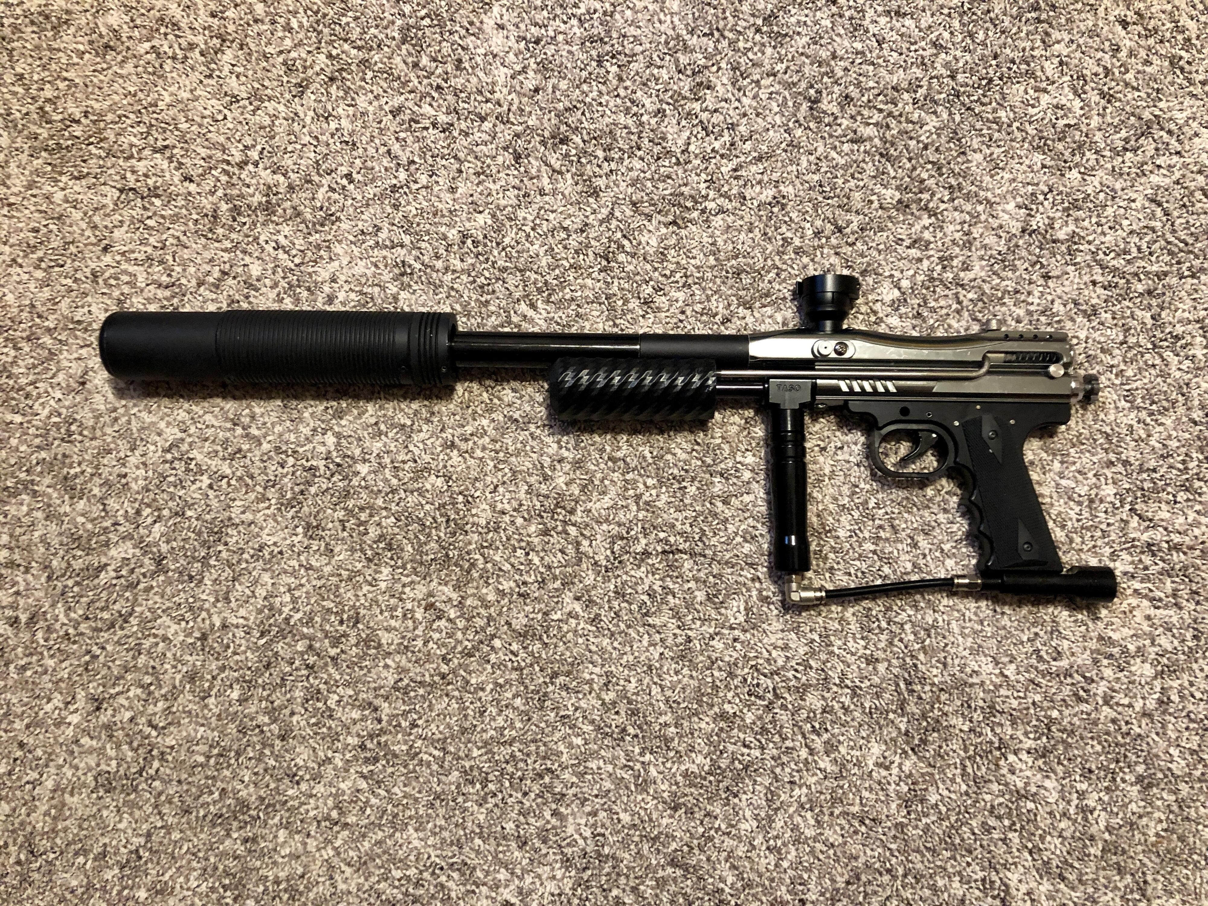

          Great stuff here. I’ve already posted mine in a build thread, but to keep this thread going.
          • Tarsun2
            • 1026
            man, im not a fan of pumps but these are looking nice.
            so much better/cleaner than the "hack saw half backs" from yesteryear lol

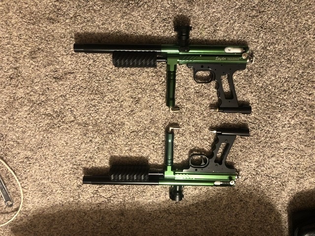

              • 4203

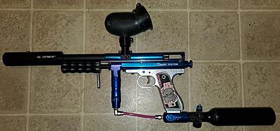

              Here's one:
Name:	spyder imagine, newer, pump.jpg
              • DavidBoren
                EVIL aficionado
                • 716
                • Portland, Oregon
                Those finger groove Bob Long frames sure are popular. Does anyone else think they are a little too wide to be comfortable?
                IGY6; 503.995.0257
                • nobbie333
                  nobbie333 commented
                  They are cheap right now, Yes I think a little thick and sharp edges
                  scottieb commented
                  I personally dislike any frame with finger grooves. I think they are uncomfortable as they never fit my hand. I'll use them but...
                • MrKittyCatMeowFace
                  MrKittyCatMeowFace commented
                  I like the signature series slider frame on my cocker. .

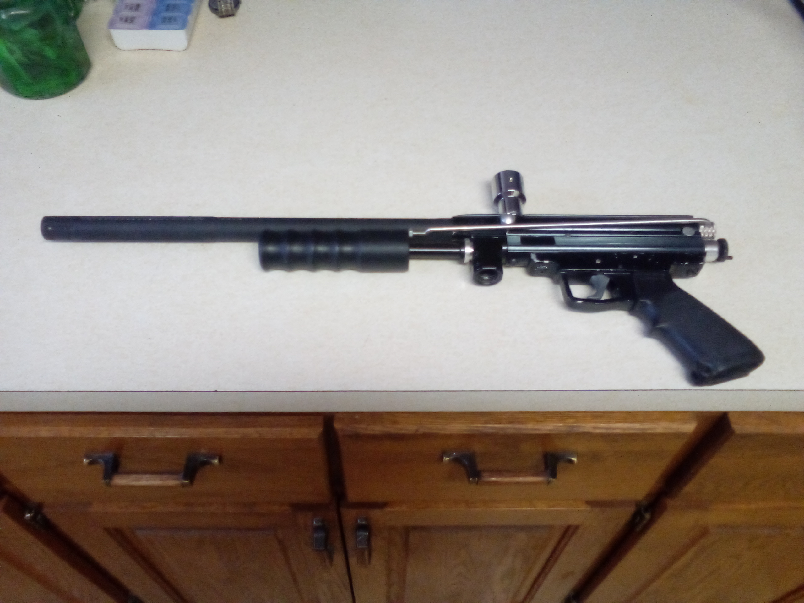

              • Rolling Thunder 67
                Old Mech Warrior
                • 216
                • Cobourg,Ontario,Canada
                Thought i'd join the party, reworked ZXS, SE frame with custom trigger guard,double trigger converted to single,SSC LPC adapter for pump guide rod, bolt from GT-2000, welded offset pump rod. Click image for larger version

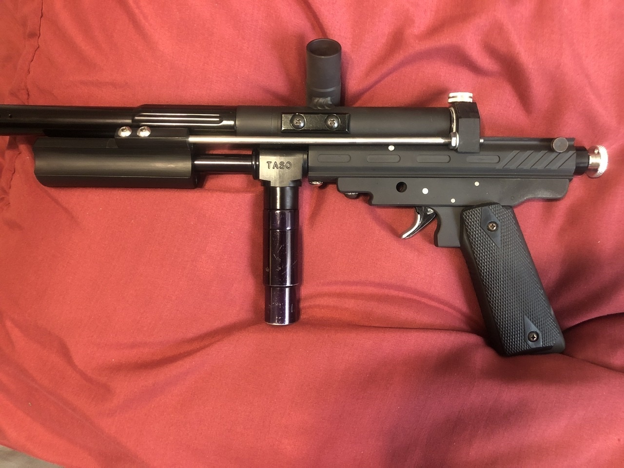

                  Anyone willing to highlight there linkage to the bolts/hammers? Saw a couple that have peaked my interest. This is always a challenge.
                  • ChoSanJuan
                    • 797
                    • Milwaukee
                    Just followed the Vike's method. Setting the striker to the trigger sear needs no measurements since the original semi auto action is already done for you. Use a dremel with the cutting wheel to get that slot. It just needs to be the right amount of travel in the slot for your linkage post to travel forward and seal off the breech with the bolt. Next important part is to make sure it's a smooth ride forward and back.
                    Fred aka ChoSanJuan
                    Team: With Intent
                      Old Mech Warrior
                      • 216
                      Hello ChoSanJaun:
                      What i was referring to was the linkage of the pump rod to the bolt or hammer. example, yours is attached to the back of the bolt via a custom Cocker-like back block. Looks very clean and functional. scottieb's looks like he slotted the body a bit forward and tied the rod in to the hammer. Both variants look good and i would like to see how they were done if i could. Thanks for your reply.
                      • nobbie333
                        MCB Member for life
                        • 465

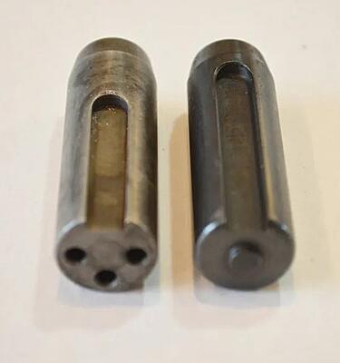

                        There is not a special link between the bolt and striker
                        the pump rod connects to the bolt and the striker is slotted for the bolt pin to travel through
                        • ChoSanJuan
                          • 797
                          • Milwaukee
                          Hello ChoSanJaun:
                          Ahhhh, thanks for the clarification!
                          So everything that's red on the Spump is my own design and I 3d printed. Here's a better pic of my back block.
                          I have dual arms on mine. Been playing with it like that for over a year now. Think I'll move to a single arm setup and see how much stress a single arm will take and where the wear happens on the bolt.
