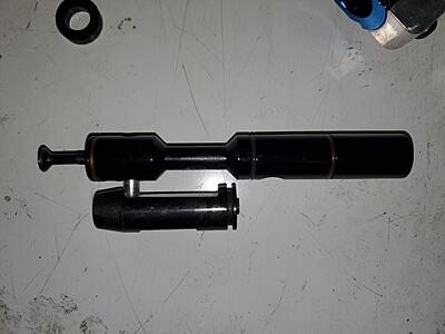

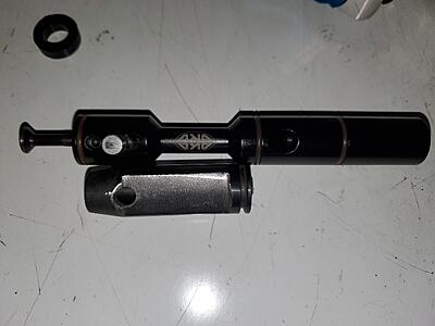

      Well, umm, here is a long overdue update on my spump project that kind of started this thread... today, I slotted the hammer!
      I took it to work with me, and used the belt sander to rough in the cut... get me past the heat treatment... then casually finished in the shape with a big file. Took it home on my lunch break to test fit what I had so far at that point. Nailed it on my first try, too!
      I chose to leave the full diameter portion at the front to stabilize the hammer from tilting in its tube... this choice became a constant worry, and I kept moving notch further and further forward to make sure there was room for the bolt pin in the closed position. It turned out to be a good thing, too... as my original notch would have been too short to allow full travel of the bolt.

        Yeah, I didn't have access to precise enough tooling to attempt a groove, so I sanded it flat... the hammer can twist to certain degree now, only really stabilized from rotating by the flat tip of thr sear riding against the flat bottom and the flat bottom of the bolt pin resting on the flat top... we will see, I guess.
        I have, like, seventeen hammers sitting around, if this doesn't work... I will try again.

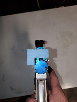

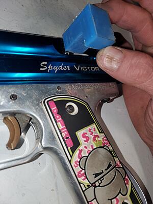

      Started on a back block... I think the blue nylon material is actually a pretty good match, considering none of the blue on this beast matches. Lol.
      This gallery has 3 photos.

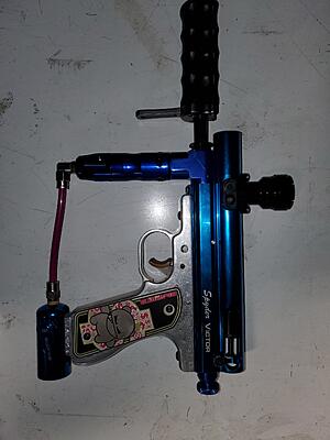

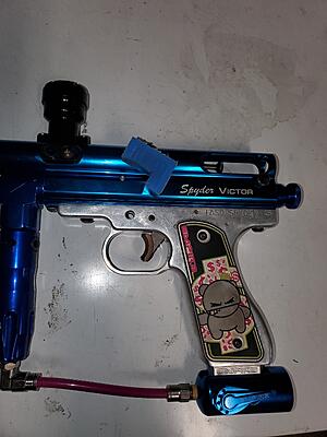

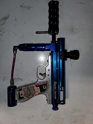

        Here's mine.

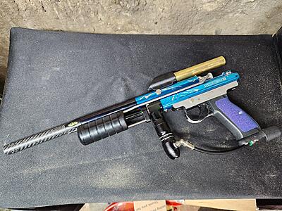

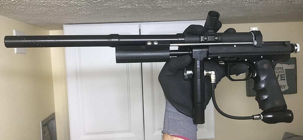

          Just tuned mine today. The "Sni-Con" a 32 Degrees Icon based pump. I did my hammer a bit different than everyone, I made a split pin, more on that in the build thread, link in my signature.
          32 Degrees Icon Z
          - Silver Slice kit
          - Dye Hyper 2 reg
          - Trilogy valve modded and PPS Dyna stem
          - Detent fingers
          - Freak barrel
          - Printed Reverse feed Phantom block (can mount both ways)
          - Stockclass Heroes CZ battle grip
          Shooting 280fps at roughly 375 psi, heaviest valve spring and lightest hammer spring. I've even used this for a couple days of paintball already, it just works amazingly. I've pretty much decided now if it's open class, this is my go to.
          I'm still not 100% done with the body, but when I am I'm having this anodized. Probably some kind of purple.
