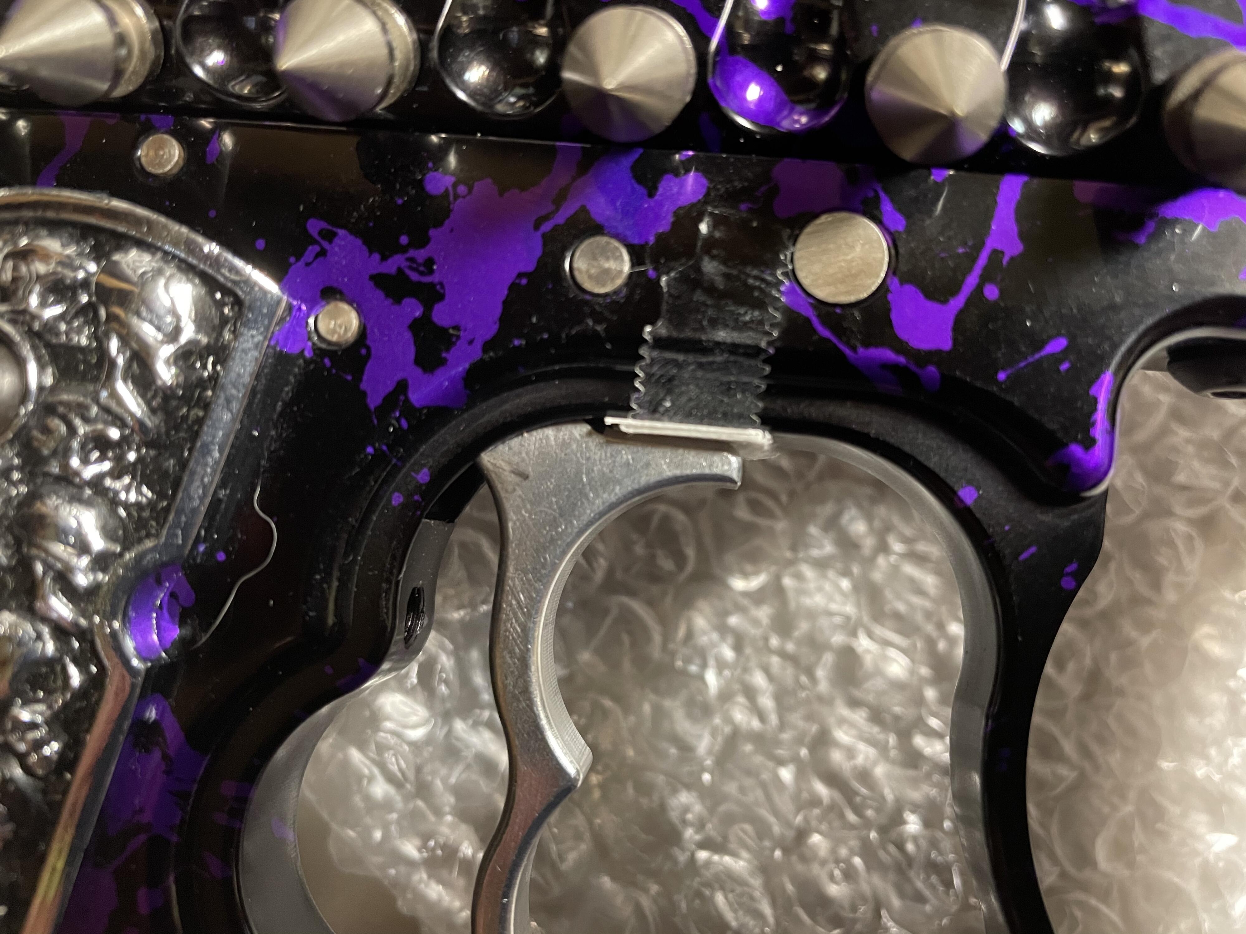

    09C24417-E789-4B5A-AA38-6170DD69B94D.jpeg Heavy modifications have been implemented. Pre travel eliminated. Bottom of the trigger travels just under a half an inch. Happy enough with that.

      Oh, that's tape! I was wondering what happened to the finish!
      It's easy and it works. I do wonder how it will hold up during play though. In order to adjust pre-travel on my Spyders I drill into the top of my triggers, tap them, and add a small screw.

        #18
        Meh, I give it 50% to last through the night.
