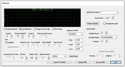

        For the mode change when it goes to sleep, you can change the “Default Fire Mode” on the top right. However it would be nice to remember the last mode.
        • JCC
          JCC commented
          I have not actually used the software yet. I just grabbed the package as it came in the mail along with my soldering iron kit to bring with me on this work trip so I could install it. Good to know the default can be changed though. I will always know before hand if playing semi or ramp so can set correctly before hand. I do not have the USB cable needed with me so guess I will take a look at this once back home.

          - pull-and-hold to power on? sure
          - remember-last-mode? done. I'll add a programmable toggle
          Easy, and you can upgrade the software yourself if you want to, it's designed to be reprogrammed with just a USB cable.
          -Curt
