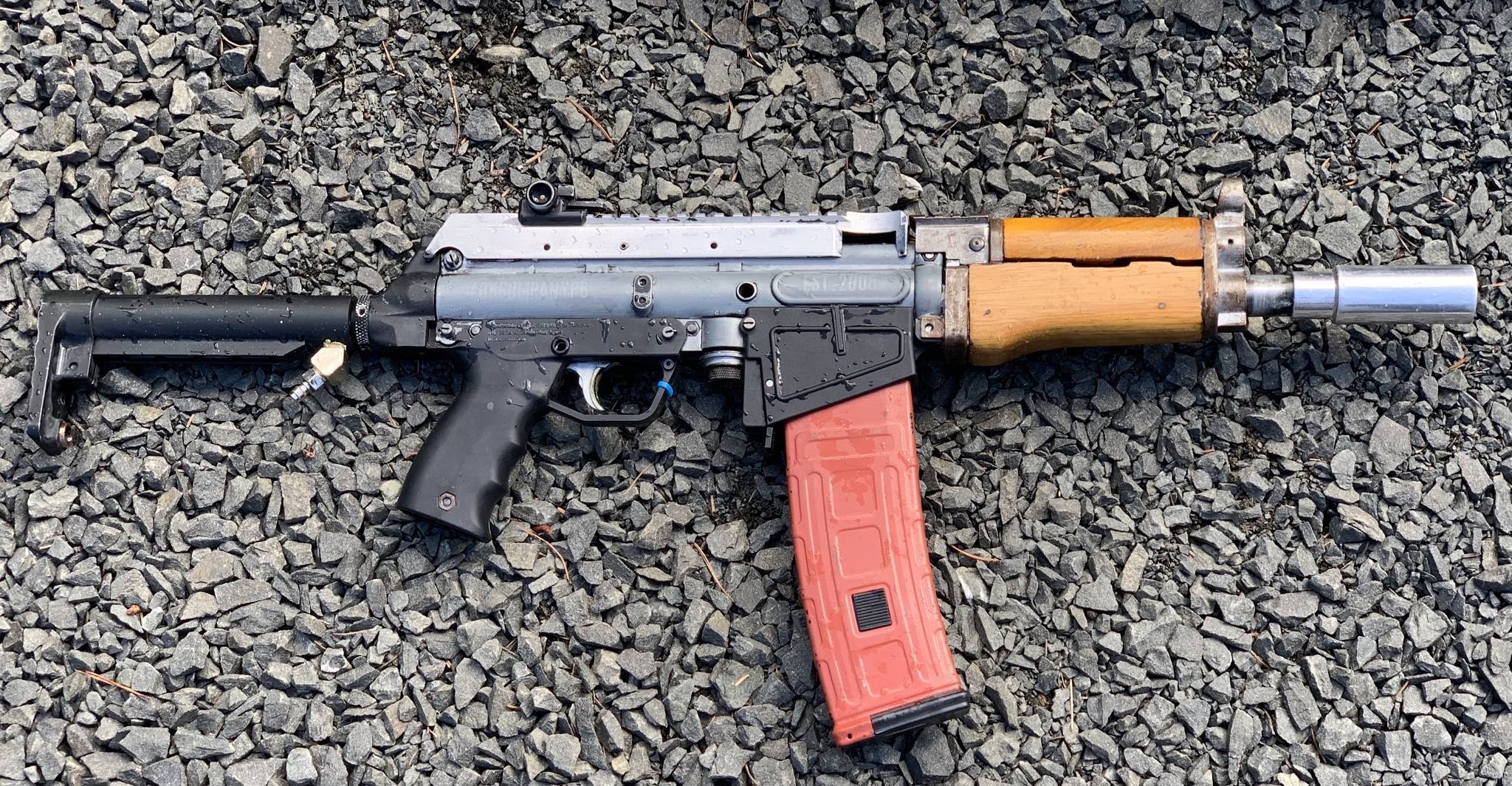

      Just thought I'd chime in with my First Strike experience. I have had great success shooting FS out of my SSR. My issue is not with the nipple tip but the size of the round itself. I have a Hammerhead barrel kit with all the sizers. The 0.683 is far too small. The 0.686 sizer fits perfectly for 1 out of every 6 rounds, maybe 1 out of every 10. A few are 0.685, but the majority of them are 0.684. If I chamber a 0.684 round in the 0.686 Hammerhead back, it will slide out if I have the marker pointed down. I tried to switch it up by using a freak barrel with the 0.684 insert, but the SSR bolt face is too wide. When I chamber a round in a 0.684 barrel, the bolt will actually rotate the barrel.
      Options:
      1) shoot anything that isn't 0.686 out of a different gun, and keep buying loads of FS rounds to get 10% of them that fit the SSR
      2) very VERY carefully sand down the chamfered edge of the bolt face to fit a 0.684 insert. I am extremely hesitant to do this; I really do not want to take off too much and have any kind of leak from a bolt that will no longer seal. If I could get someone to fabricate me a spare SSR bolt I would try it.
      3) make some sort of detent in the 0.686 barrel back to take up 0.002" of space and keep the undersized rounds from sliding out
      I am going with option 3. I eyeballed where the round sits in the 0.686 fin and then drilled a hole roughly where the seam would be. Then I slid a thin strip of paper through the drilled hole and taped it on the outside. It seemed to work okay just pushing rounds through and I thought I had it solved. But eventually the paper ripped. If this happened in a game I would be back to square one. My next idea is to file a small channel for the paper strip to sit in, not quite flush so that it still holds the round in place. I am on the lookout for any material that is as thin as paper but stronger. I may be way over-thinking this one, possibly should have just put a couple drops of nail polish in the barrel and called it good. Another key part of the process was scouring the internet for the last 0.686 Hammerhead autococker fin in existence. If I botch this at least I will have my back-up fin. I will try to get some pics of my handiwork.
        XEMON commented
        I'm surprised you're having so much problem ...
        I have a lapco (the rifled one) on my SSR and never had an issue ...
        Sorry, let me correct this: I had 1 round so big it got stuck about 2/3 of the way into the barrel ... Had to push it out with a squiggy ...
        For the bolt, it should be easy enough to get a spare one from CCM and turn it down a tad so you have a spare/new one in case something happens. Have you tried to contact them?
        2 thou brass or stainless shim might be the way to go now you know it works ...
        XEMON commented
        That's why I like to get spare parts before modding ... I did a trigger job on my SSR to shorten the pull and return and weight but I got a spare one from CCM beforehand (it's way too long IMO). I would do the step on the bolt tip to fit the freak insert after getting a spare from CCM, if you screw up, you have a stock, of you don't, you can return it to stock at any time and won't hurt resale with "diy mod" on a high end gun.
        But yes, the issue is clearly the rounds ...
        OP, do you have access to lapco or nemesis barrel for testing?
        You could also get a .683 back and ream it out to .6845 ...
        But with the back you already modded, I would put a more durable shim (brass, stainless, ...) Or put a spring loaded detent in there?

      I pulled out a bag of 0.684 FS and my 0.683 back. I can push the rounds through by hand but it takes a lot of effort. The 0.686 rounds will sit in the 0.686 back without moving but will slide easily when I push on them, makes for very smooth reloading. I'm assuming I will have to raise my operating pressure significantly from where it is now if I am squeezing oversized rounds through the barrel. I will try it the next time I'm near a chronograph and see what happens.
      I have messed with some Planet eclipse detents, trying to see if I could situate it poking through the little hole I drilled and still screw the barrel in. Haven't found a way to make it fit. I will hunt around and see what else I can shove in there.
      I have considered reaming out the 0.683 back, I just don't know who I should ask for that kind thing. It would mean reaming out very little and then getting it re-anodized, and hoping the bore is exactly 0.001 larger than what I started with. I don't know much about machining but that seems like very precise tolerances to ask from a paintball airsmith. The DIY version would be getting a wooden dowel and sandpaper and going to town.
      I have not tried a lapco or nemesis barrel as of yet. Any thing I want to try I just have to buy it myself so I'm hoping I can make something work with the Hammerhead kit. Once I figure something out I will post pics of my solution.

            So here is my solution: I took a thin metal piece from a dead stopwatch and made a little strip to fit inside the hole I drilled. The fin is 0.693, that seemed to be the optimal size just playing around and pushing FS through. It feels like they will stay in place until fired. The metal strip is far enough ahead that the bolt will not cut it like a pair of scissors. I will test it and report back my results.
            EDIT: went out and fired two 6-round magazines. Seems to work just fine, and the detent was kept in place and didn't have any damage. Thanks for all the suggestions, I'm pretty happy with how this turned out. 😃
