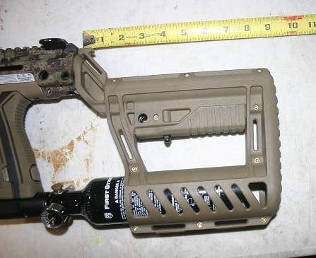

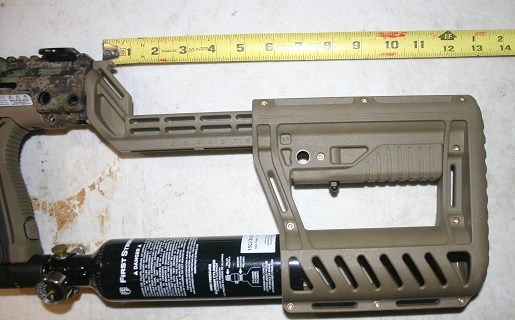

        Some additional PWR stock info:
        In stock air with eclipse pwr stock - accepts tanks max 2" outside diameter
        -13 ci fits all position 1 to 11
        -15 ci fits all position 1 to 11
        -17 ci fits position 3 to 11
        -22ci fits position 11​
        With a 13ci tank.....................

              I don't actually have all those tanks, I found the information online and kept it for future reference. I use a 13/3000 tank, carry six mags, when I run out of paint I refill the tank. I've never drained it dry.....
              My EMF100 runs all stock internals with an MCS Anti-chop Lok Bolt, and my Emek100 with the EMC rail also uses stock internals. My Emek 100 with the stock body has a Deadlywind Hair45 trigger valve, Exalt Ignition trigger, and a PBG Whisper Drive bolt/valve chamber.
