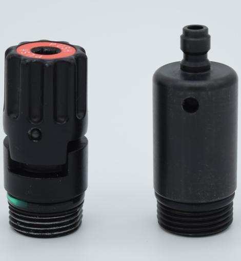

        They made a plug with a 1/8npt port on the back ...

          Umarex made a replacement knob with a hole to attach a remote line so you can use a HPA tank instead of the 12g

        Super cool Ill have to try out the remote line, or a variant of some kind, It's so freaking fun to play with, even if I only got a kill or 2 the entire day I had a blast

          Sorry if this is a little late, but...
          • COB
            Expanded Gnome
            • 859
            • Sparks, Maryland
            The Inflicted mod works great. With HPA it will be more consistent as CO2 is affected by temperature.

              Any way to get spare CO2 plugs or HPA adapters at a decent price?
                • 6276
                only place I found it.
                https://www.rockstartactical.com/mcs...-line-adapter/

                  Has anyone got some testing numbers with HPA? The gun is designed to suck liquid CO2 out of its cartridge so I imagine velocities with liquid would be significantly lower.
                    • 6276
                    If you bump up HPA input pressure you can make anything shoot on it. 825psi seems to be the Magic number for unregulated 12g operating pressure from what I have seen.

                      I would think that having to be tethered to a remote system would constrain the fun of using these things in a way that outweighs in any advantage in consistency. With its janky barrels and lack of stock I don't think anyone is going to be sharpshooting with these things anyway.

                        Id be interested to have the option ...
                        An asa sticking out the bottom with a 9ci might work if its not too wired ...
                        Edit: found those too (in EU):
                        https://www.homedefence-24.com/en/pr...31989764980854
